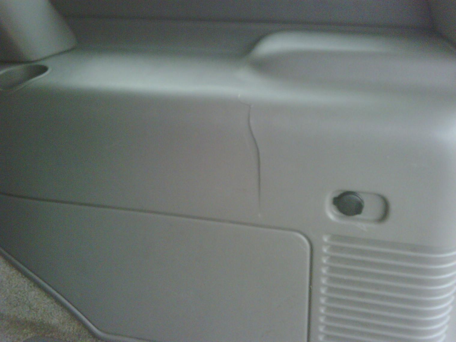

Anybody know how to fix this?

I had two kegs in the back of my Tahoe earlier this year and they broke the plastic panel.
Can i fix this without getting a whole other panel?

Sure, take some 3M panel adhesive, and push out the part that's pushed in, take a piece of scrap plastic, cut it into three or four strips. Put a nice bead of the adhesive down, put the strips down horizontally, take some clamps, and a piece of 2x4, and clamp that bish down for a little while. (try not to put to much down, because it'll want to ooze out!) Or.....you could use a two part epoxy! My .02!!! I'm sure somebody will have a better solution....oh well.

What joe said above will work good. It's a nice clean crack, so once you line it back up and epoxy it, it will be hard to notice.

Epoxy or, if you have some money to spend, sonic welded. It still amazes me how they can weld plastic!

Thank you....I have done that before, a friend of mine cut out a piece to mount some x 9s, and then changed his mind! So...I put the two cut outs back in with that method, and it worked Grrrrrate!
