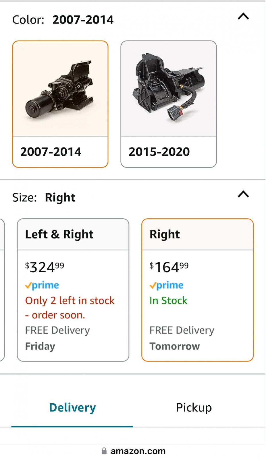

For the '13 Escalade ESV I bought new motors off Amazon that are a motor and front bracket in one:
Then purchased new OEM rear step brackets from gmpartsdirect.com
Been working flawlessly for over a year now through all kinds of weather here in Ohio.
Appreciate the response and link. Might just have to pull the trigger and be done with it. Fairly easy install I’m assuming?

What’s with the price gouging on the 07-14?
