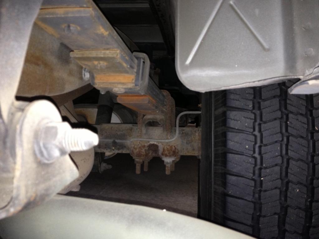

Currently, I am thinking I need to replace my Leaf Springs and shocks.
Would like to get a better idea of which types of shocks and leaf springs to get before I do so. Mine has a 4" body lift, and I have seen where I can get leaf springs to lift the vehicle a few inches.

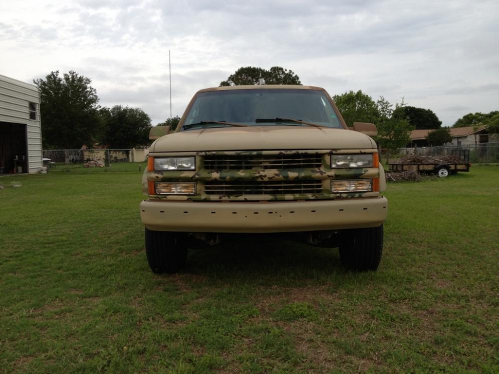

how does you vehicle look unloaded and load and with your trailer attached. complete side, front and rear view pics if possible. need year door # and driveling type as well as weight on trailer to make the best recommendations.

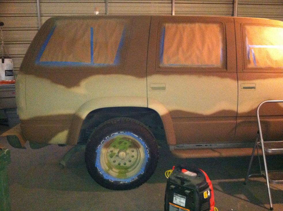

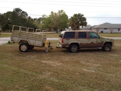

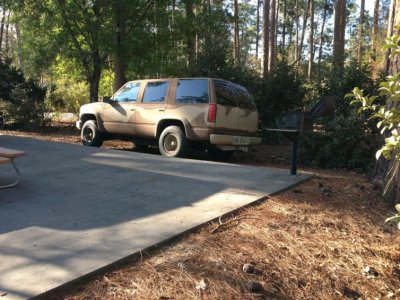

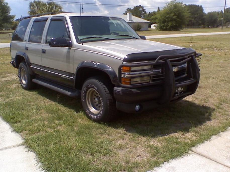

Sorry if I was misleading... its not the trailer weight I am concerned with... Where the trailer is concerned, is with raising the rear end up more to level out the trailer...
I recall my back end being higher when I first purchased the truck. Now, after having loaded the back of the truck with a cut up oak tree a couple of times, plus hauling a cheapo 4X8 Trailer loaded with the same oak tree... I think I flattened them out in doing so...
Only recently, bringing home a load of garden stones did I realize that my bumper was low to the ground. IIRC it was lower than a cinder block standing on end. After I unloaded the garden blocks, it raised up about 8 inches or so.
I don't know if the pics will help, but the one where its silver is pretty much when I first got it. I also added one with the empty trailer attached, which looks like it brought it down some. But the trailer isn't that heavy empty... Meaning it shouldn't do that that easily...

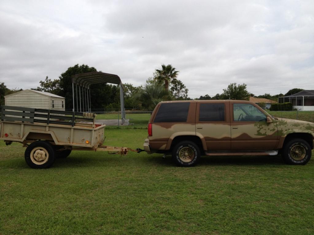

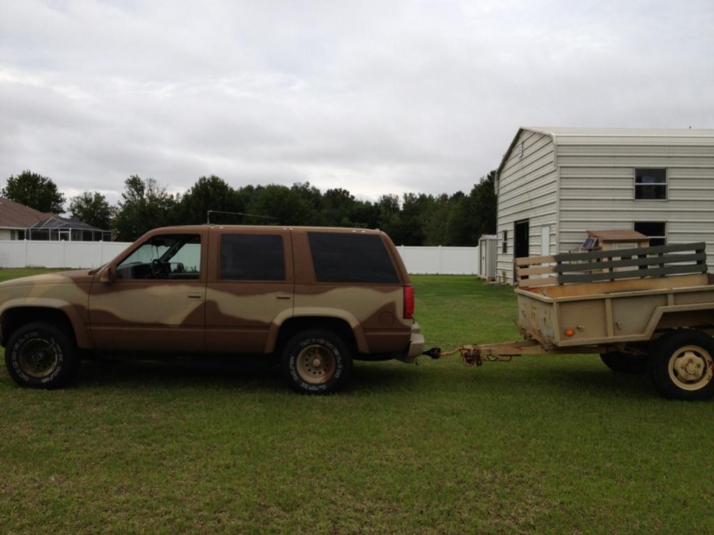

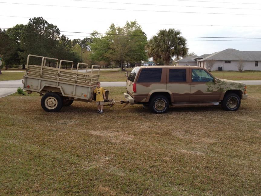

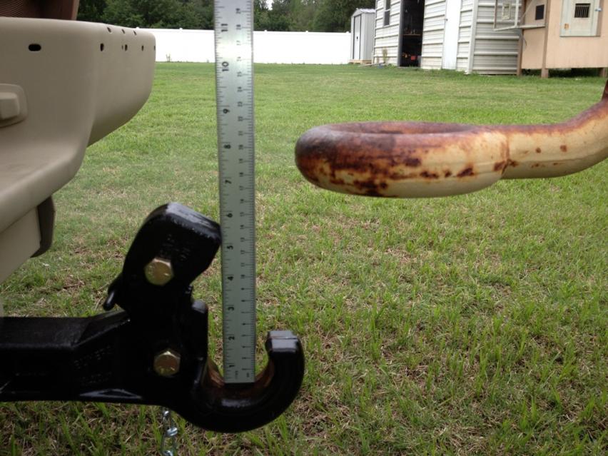

Just for the sake of experimentation, I loaded the trailer on to the truck pulled it out of its cave and then took a couple of more pics.
I am aware I can get an adapter to correct the problem with leveling out the trailer. But anytime I put a couple of hundred pounds in the truck itself it drops about 8 inches... I don't think that is normal... Is it?
I was thinking if I were to do a lift through the leafs, I may be able to raise the hitch, but no matter what I will still have to get an adapter pintle. So I'm not going to worry about doing that... Ill just get normal leafs, but I do want something better than stock leafs.

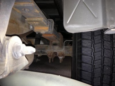

Here is a pic of the leafs

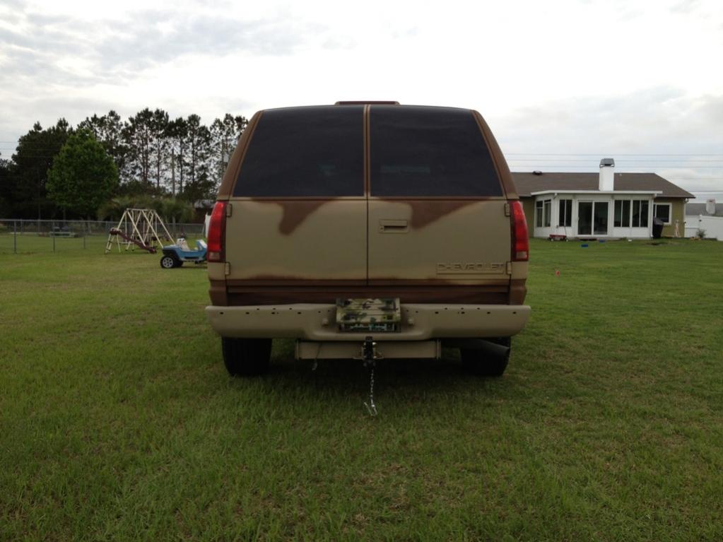

Sorry didnt get front and rear view.. Try to do before sun goes down. Truck itself loaded... Not easy to load a couple hundred pounds in there without a lot of work. Perhaps, Ill be able to do so tomorrow...
4DR
1999
Drive Line? 2WD?
Weight of trailer 1200 lbs and can haul 1500 lbs (3/4 ton)

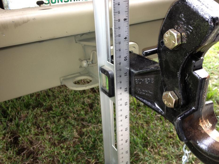

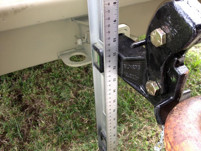

the height of the trailer tongue doesn't help your problem at all. You load the truck up and the trailer points farther down. You are transferring too much weight onto the tongue with the trailer at that angle.
I would try to raise the hitch or lower the tongue first.

True....
Research I have done so far, I will be purchasing another axle for the trailer and adding tires and wheels the same as the truck. That will level the trailer about 2 more inches. Then the adapted hitch with the bolt on pintle will level it off and perhaps even tilt it back a tad. None the less I will be able to raise and lower the pintle mount as needed.
Just need the funds to make it happen in the mean time. Worst case, Ill figure out how to put the leaf springs in the trailer under the axle.
I already flipped the lunette on the trailer

well the springs are worn. and the trailer has to much weight in front of its axle. and because of the pintle and height of trailer a weight distribution setup wont work either. so if this is the trailer you will primarily use you have three options. replace the leaf spring and drop the trailers height to match the suv and switch to a ball hitch to use weight distribution device. replace the leaf springs and install Firestone ride rite kit when unload the air bags would only have 5 psi in them for safety and reliability concerns. or just use the ride rite kit to hold the vehicle level when loaded and unloaded you would have to adjust the pressure in each bag each time a height adjustment is needed. this process can be automated at an extra cost to to auto level. the last two options will not change the fact that your front end is still gonna lift some and in some road conditions that can effect your braking and steering ability. as long as trailer has that much weight in front of its axle it is going to weigh you down and worse when loaded only effect the front end control of suv even more.

So as far as the simple part. Getting the truck back to a running condition. I can't do much with the trailer at the moment as its not even registered yet.
Change out the Leaf Springs: Brands/ Types to look at? Just wanting better than stock. Little more tough.
Shocks: Brands? Try to keep it under a hundred if we can... My money tree died.
I am car dumb, I can figure out how to take it apart and put it back together. Just don't know what to look at...
