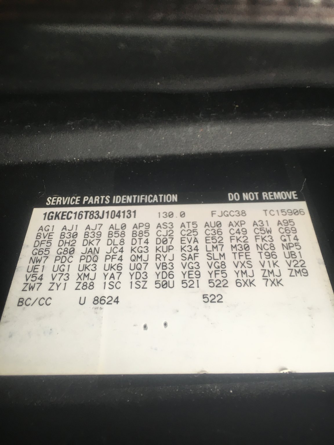

Good morning y'all! I've loved reading through these forums, learning a lot! I'm looking at getting this bad boy
2003 GMC Yukon XL SLT
http://www.ksl.com/auto/listing/3638148
And it seems to be pretty good. I'm using it to tow a 3600 lb trailer and move some of our belongings across country. Want to make sure it will do the job. I got the idea of looking up RPO codes from you guys. I put a picture. Anything good or bad you can tell me from them?

And it seems to be pretty good. I'm using it to tow a 3600 lb trailer and move some of our belongings across country. Want to make sure it will do the job. I got the idea of looking up RPO codes from you guys. I put a picture. Anything good or bad you can tell me from them? View attachment 80094
The silverado forum has a good rpo list
http://www.silveradosierra.com/owners-manuals/gm-master-rpo-code-listing-t7203.html

I'm always looking for a good tow vehicle and have a list of the RPOs I'd like. Other than the diff I see none on this truck, oddly, not even the hitch code. No tow package.
