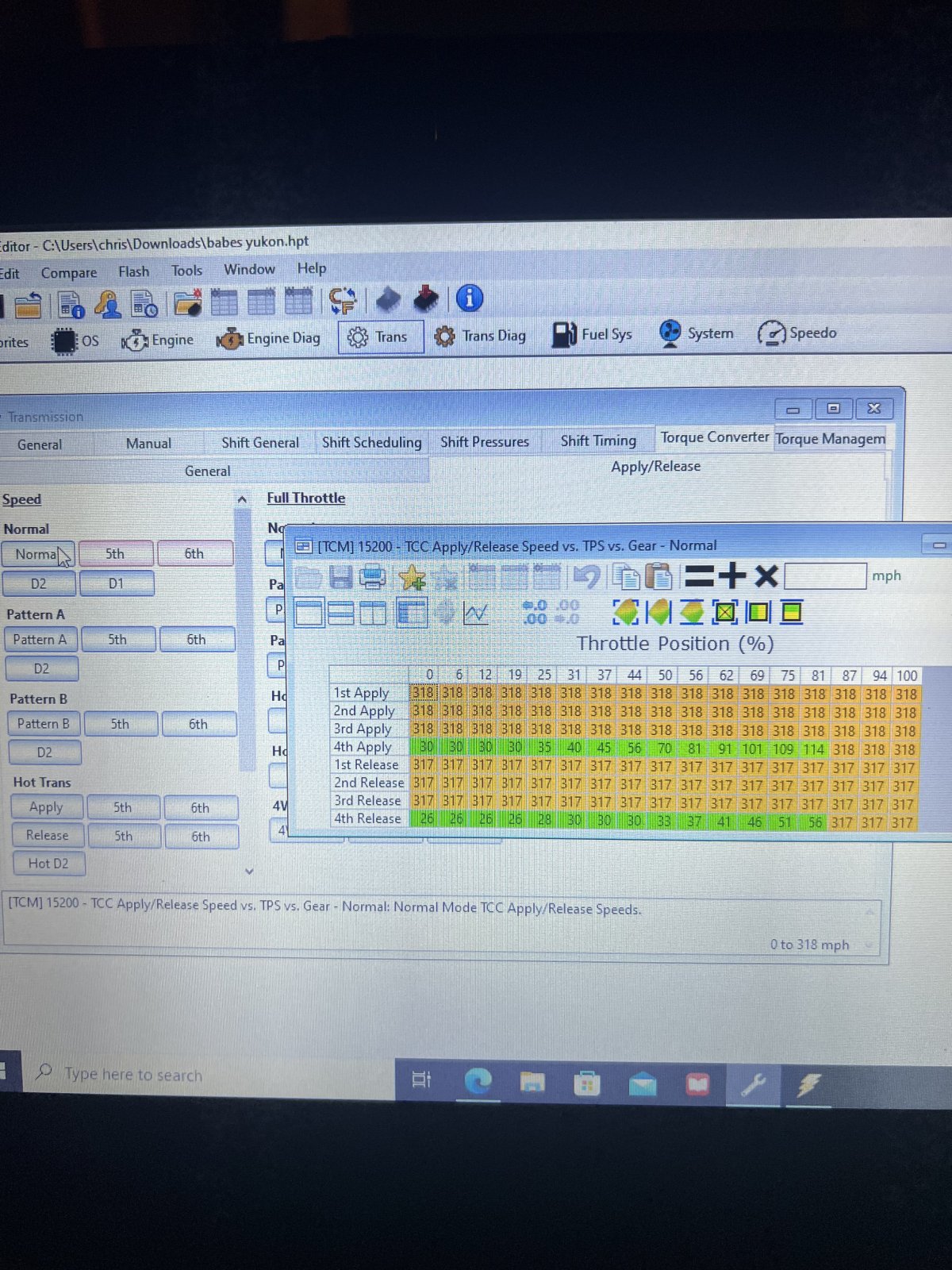

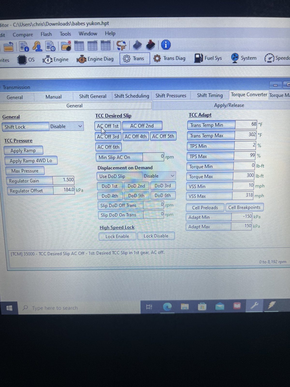

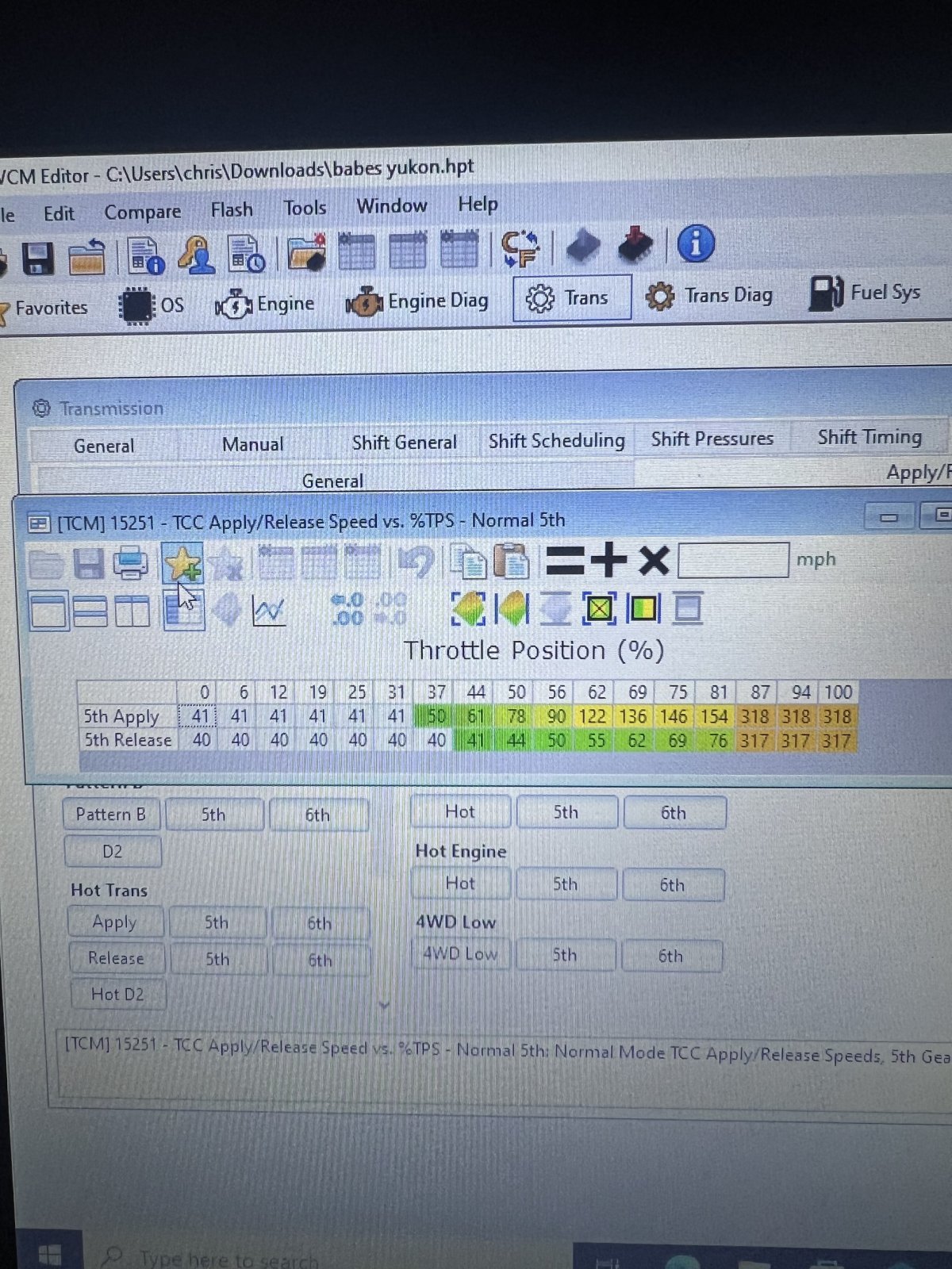

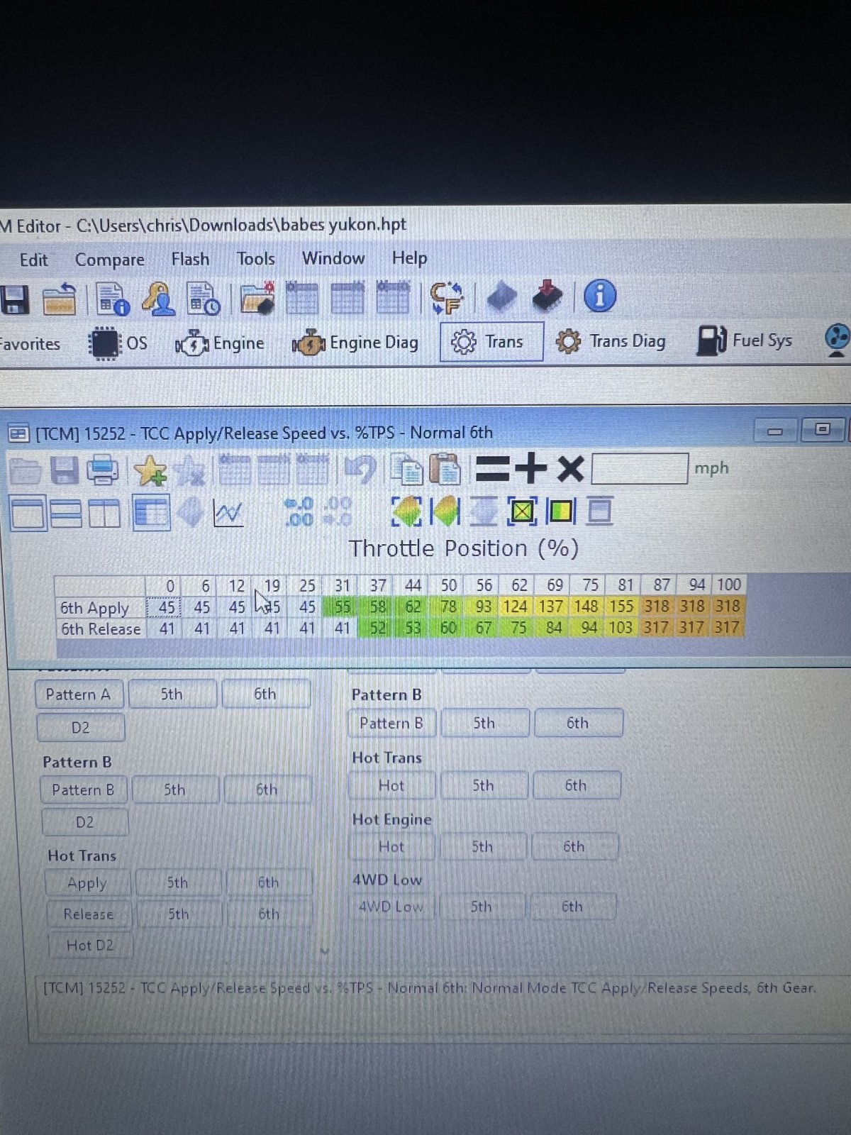

So here are some pics of some of the things I have changed. It not anything major but I think definitely helps a lot.
Torque converter slip, you want to zero out all desired slip tables even though my 6.2 doesn’t have dod I still went in and zeroed out all the tables for it.
I have read that this will prolong pr valve life because when slip is desired the valve is moving back and forth rapidly to achieve the amount of desired slip.
Shift points. In the shift schedule I changed shift points to extend through gears a little more.
On the apply ramp 4WD Lo look at that table and you may see ZERO values at around the 20rpm splip mark. Shift that table to where Zero is under the Zero slip and keep the rest of it the same.
For the apply and release, if you set them to something like 130mph you should be ok or you can do the 318 on apply and 315 on the release.
I have mine set to where after 50% throttle the numbers shift to 318 and what it does is when you get into the throttle and you cross that 50% mark the TC unlocks and you feel it like a 1/2 gear change.

I thought keeping the converter in lock up up would be a good thing for keeping heat down.
I had 4th gear unlocked and a good ways through 5th I test drove it and immediately noticed higher trans temps like up to 170 pretty quick. I changed it to have lockup in forth and a little lower in 5th and also run 5th out a little more in part throttle and trans temps came down with the converter being in lockup more.
With this luk being a multi disk clutch I thought it would be a good thing.

Ok I did notice that the tcc unlock is gone on part throttle increase in 6th I’ll try that

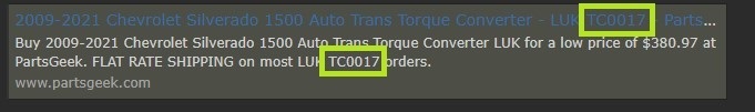

I am shopping for my L96 6.0 engine swap and I will do torque converter at the same time. (for obvious reasons) After reading this thread and several others here, I'm convinced the Luk is the way to go. Now where to buy?
A google search brings up a number of options, this being the first one:
Is this the same as the TorCon? All the other vendors say the part number is TC0017. I don't see that number on this listing nor do I see "TorCon." Price is quite a bit lower than all other vendors, even Amazon, but I'm not sure it's legit?
Yes, it is. Look back at your own post. The title of the page has TC0017 in it twice. Dunno why it's not on the product page itself.
If you're still concerned, RockAuto has it for $348.79 as of this writing. The RA page has both "TC0017" and "TorCon" on the "info" page.
Yeah I guess it is, thanks for pointing it out. When I was typing out the post and pasted in the link it was just the gibberish long hyperlink, so I didn't see that text before I posted. I am still a little nervous just because I've never ordered from them before and haven't heard much, but I went ahead and pulled the trigger. We'll see how it goes. Total price with shipping and tax: $431.
But as for RA goes, I'm not seeing it for $348. There's a reman listed for that price, but the Luk is $442 (and $30 shipping to my zip) All in, with discount applied and sales tax+shipping, my price would have been just under $500. Amazon would have been right around that number too.
