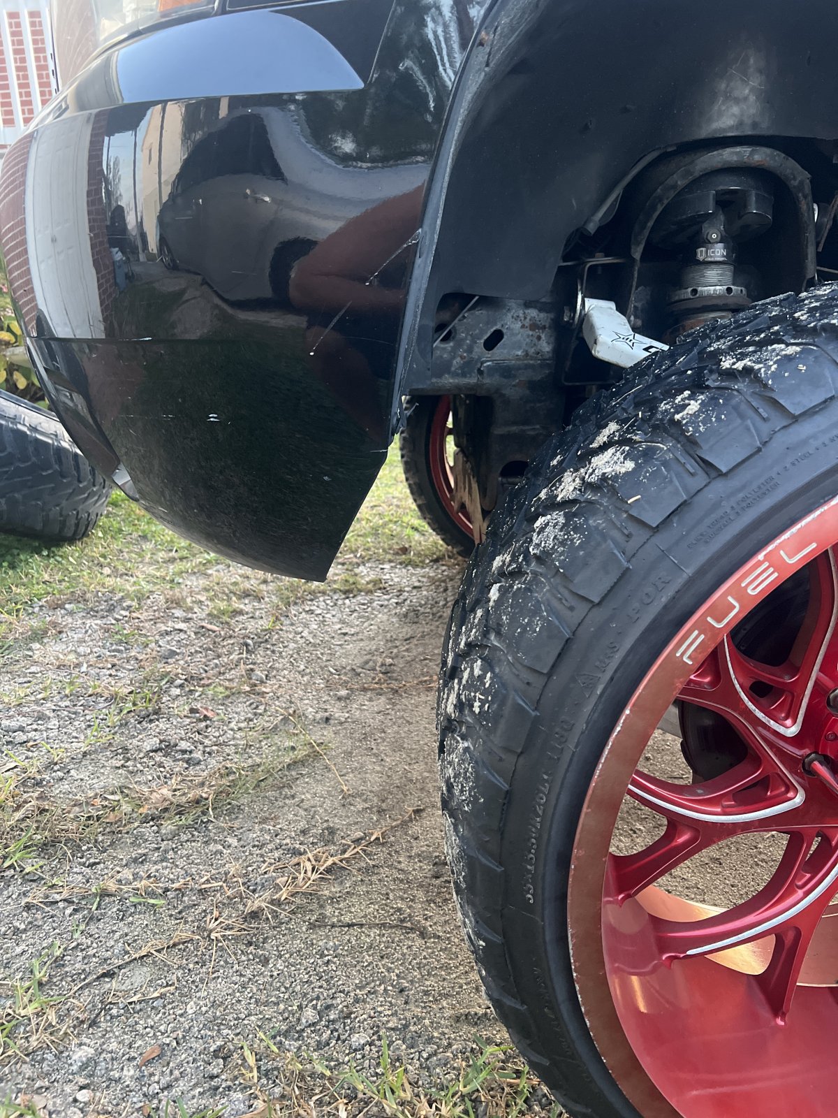

Will 35X12.50R20 tires fit a GMC Yukon Denali 2016 6.2?tir
With stock rims yea you may need a 2-3” leveling kit and 1/4” wheel spacers so they don’t rub the upper control arms if running with stock or no offset wheels
If your stepping into offset wheels rubbing will become an issue. Usually on these models you can get away with some fender liner trimming and or the “NorCal mod” and a small front bumper trim
