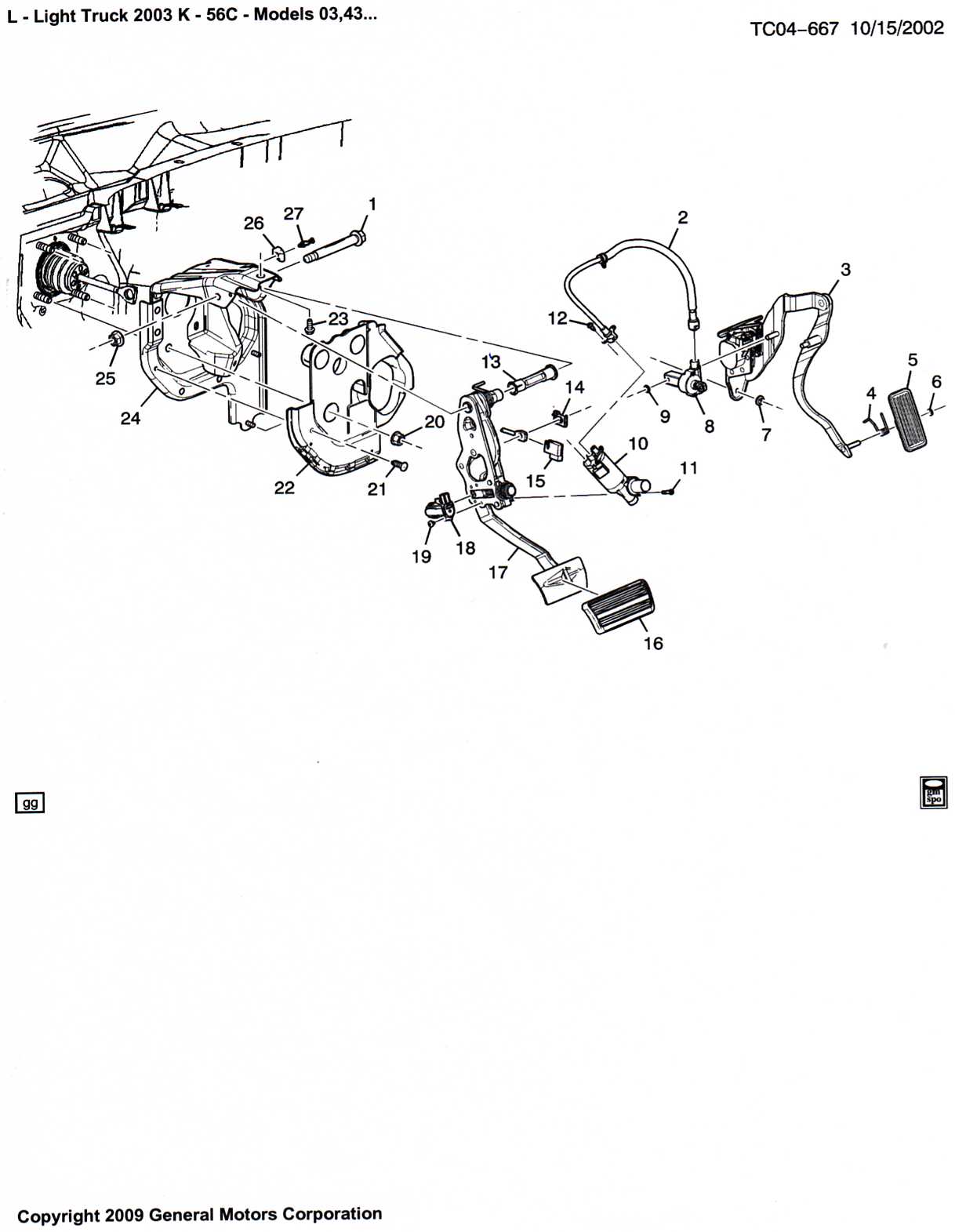

I have the same thing and have not spent much time trying to fix it lately. Mine is bad enough to shut off my cruise control when I hit a slight bump. I would hopefully put the diagram on here of the brake pedal, but there is supposed to be a bushing to change out that will help. Not sure which one. I had a thread opened called brake shake that I found that much out from. Also had the intermediate shaft replaced. Drives smoother but no change to that issue.
Hope this helps.
Let me know if you do end up finding something would love to know what it is.
