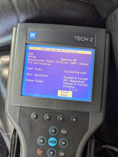

I am having an intermittent P2138 code, and I've been doing a lot of research here but I'm at a loss.
2007 Tahoe LTZ 5.3
I've replaced and have done the following:
Replaced TB - Acdelco
Replaced Pedal - Acdelco
Removed the fuse box and cleaned the connections there and applied grease
Replaced the connector at the pedal by disassembling the old connector and installing a new connector. I did not re pin the wires as they looked to be in good shape.
I can collect any data from the pedal that anyone needs, just let me know.
Sometimes it can be fine for weeks, sometimes it will throw the code and reduced engine right after putting it in gear.

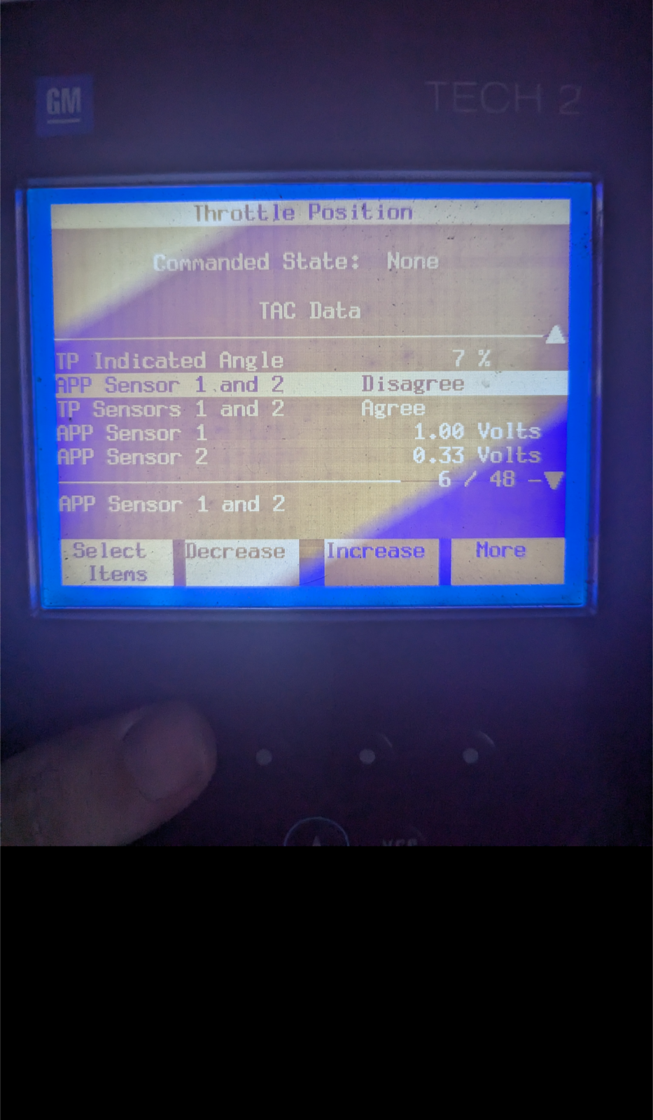

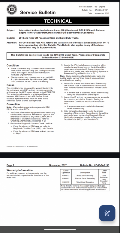

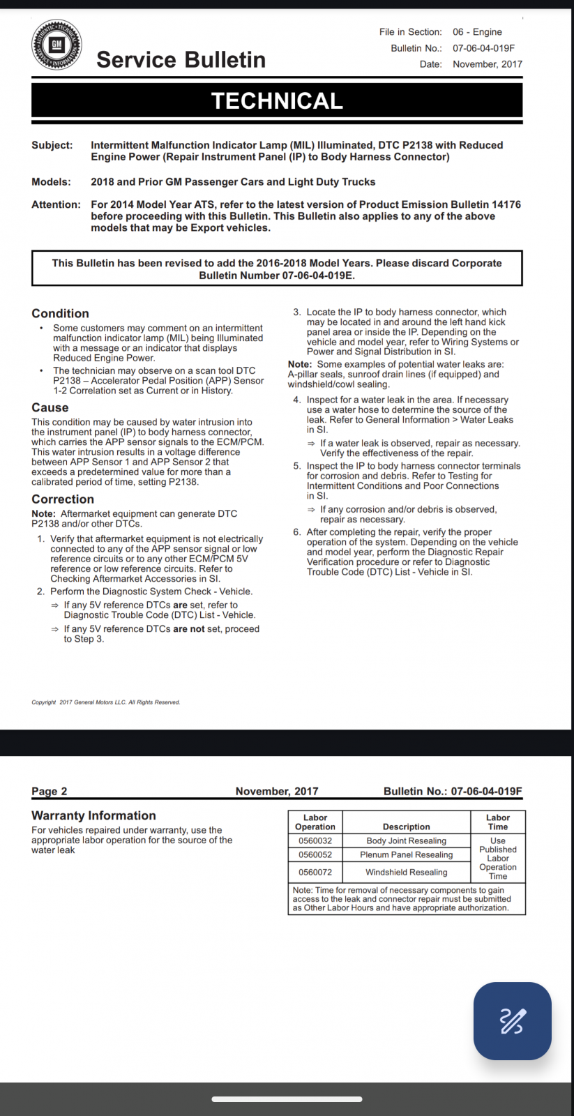

firstgenon24s
Mar 3, 2024
Yes I can get that for you no problem. I also know there is a TSB but I am not sure what the Instrument Panel to harness connector looks like, or where it's located exactly.
