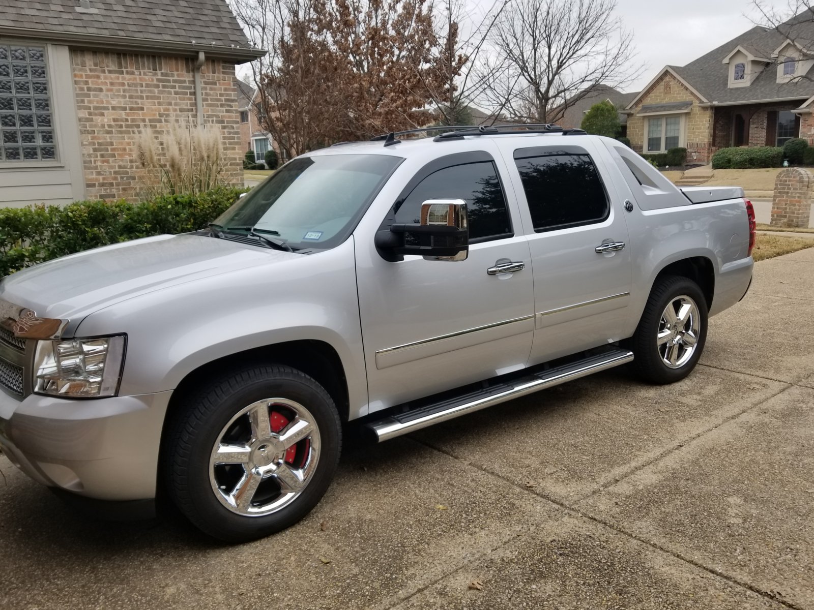

Dropped about a hundy and a half - I think flebay has them cheaper but I wanted 2 day delivery and I have a pretty good track record with returns on Amz. These are manual fold/extend, heated, and electric adjust on top mirror. Easy enough to install if you have removed a door panel before - plug & play except for the spotlights which had to be wired, but it was all right there on door - no need to go under dash. I did end up losing auto fold which I used every day almost. Shout out to Swathdiver and Doubeleive for the puddle wiring info thread (its the 2 orange and white wires in the white clip - the new mirrors only use the black clip so I ended up cutting off the white clip from old mirror and splicing the 2 wires). Took about 45 minutes total. Verdict: 4 stars. They do shake a tiny bit on hwy, and the chrome isn't "restaurant quality" - but the visibility is so good, I almost get dizzy! An Avalanche needs all the help it can get when it comes to rear view...
