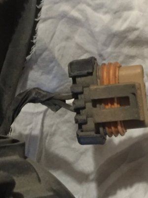

Hey mals, I believe yours is a 2pin Alternator plug? Mine is a 4pin plug.

OK figured it out, since '05 & '06 is a 2pin connector, its just figuring out which/what wire is what via the IMG_0879.JPG service manual/schematic. Disconnected my 4pin plug which is really a 2 wire, either make an adapter so you can go either way or remove wires from 4pin connector and put in place a 2pin connector... Now you can have a 160amp alternator equipped with a 2pin connector.
