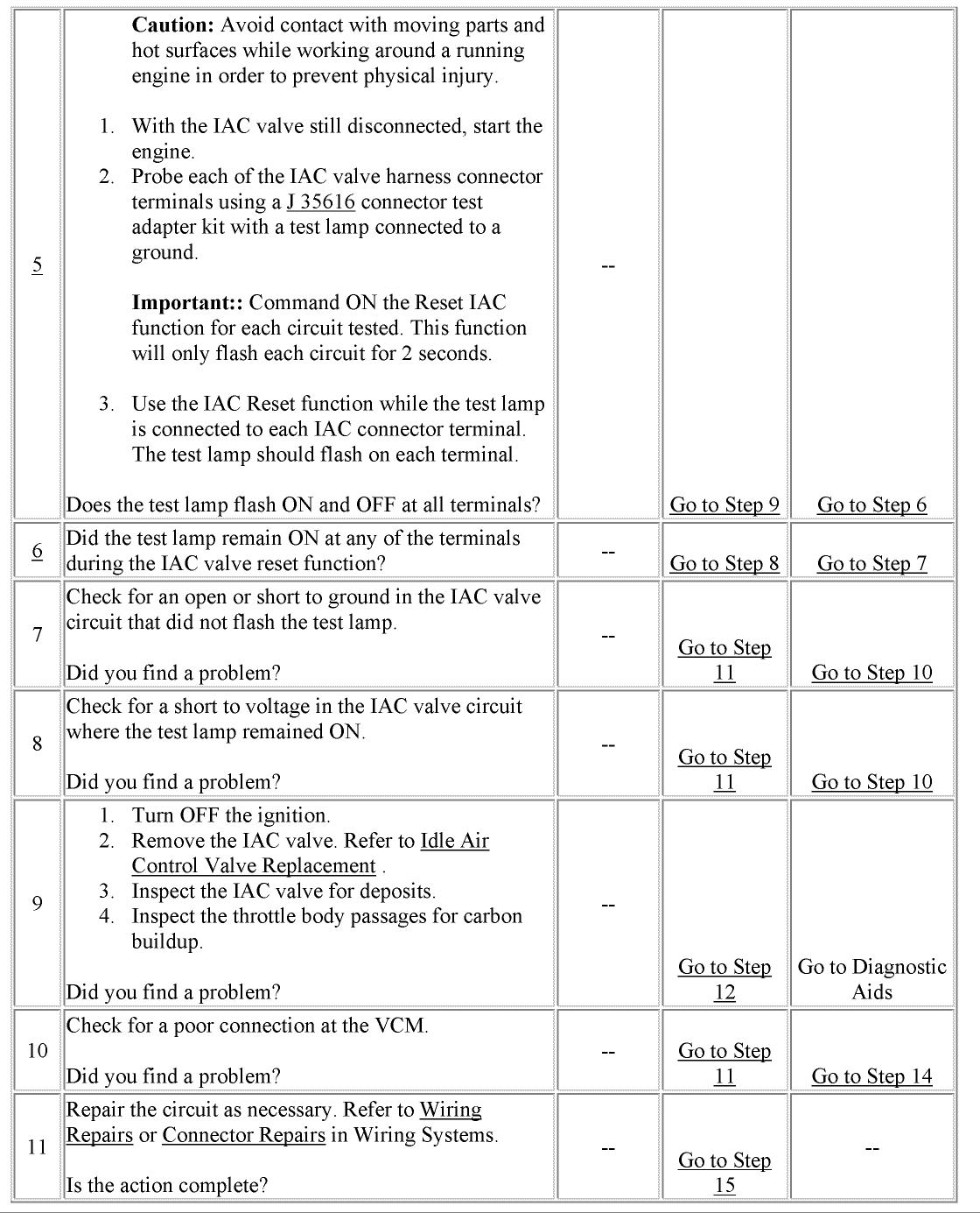

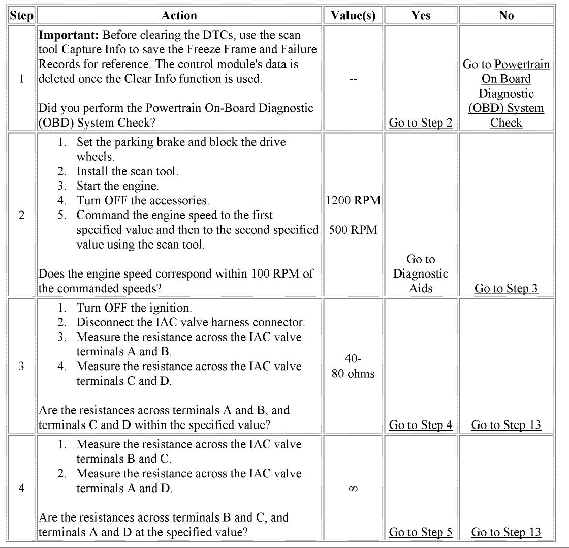

What was the code for the evap system? I’d probably ignore it for now and go with the P0507. Here are the diagnostics for it. Since you don’t have a tech2 or similar scanner, you can probably make some assumptions on the ‘yes’ and ‘no’ answers and just check through the options. The resistance at the IAC terminals, for example, would probably be worthwhile.
If I was wanting to shotgun a part, it would be the IAC valve.
