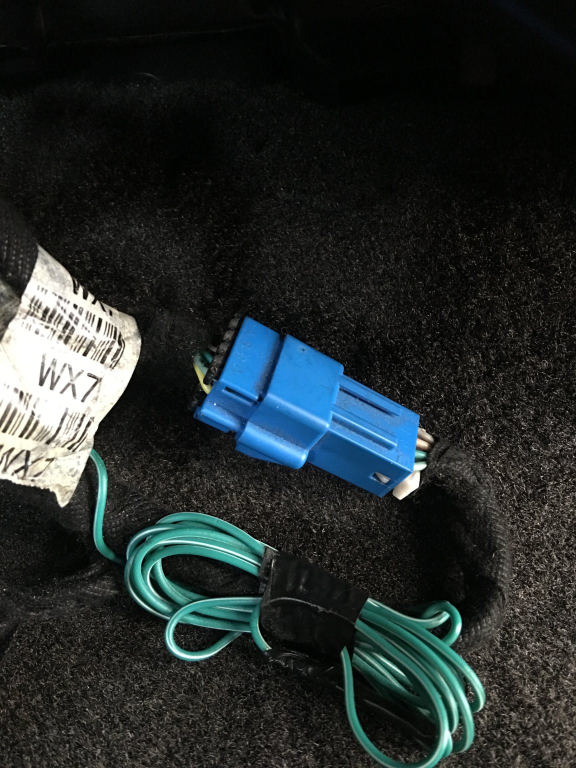

Interested in this option can't locate dark gray green wire

Yep , this one , I got it wrong .,
So , where is it ?
Not in my wires under center dash

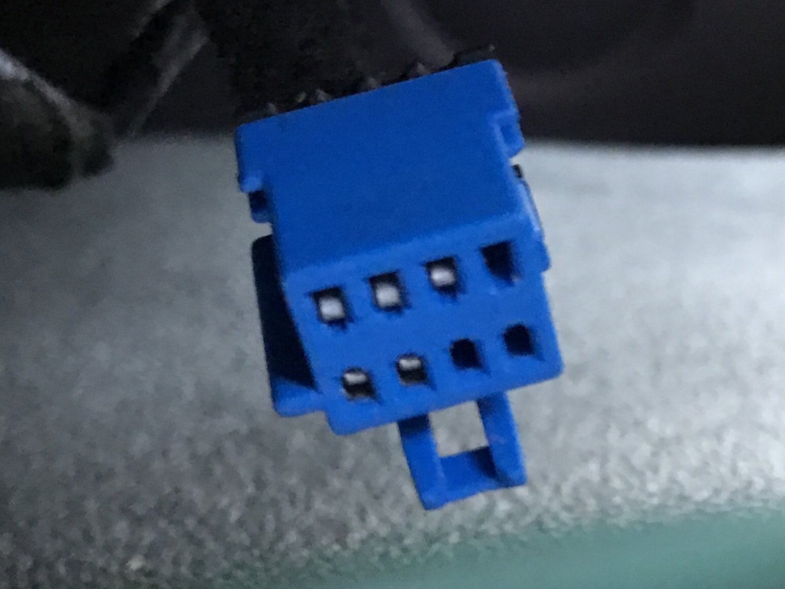

Adam, look up under your radio, there should be a couple of wire bundles stuffed up there, locate the one with the blue connector, that bundle has the dk green/red wire. put 12volts to that wire and watch your lights flash. I mounted a rocker switch up to mine it,s a lot of fun!!!

This something new , look like I have only one bundle of wires ...
Have to check again , thanx

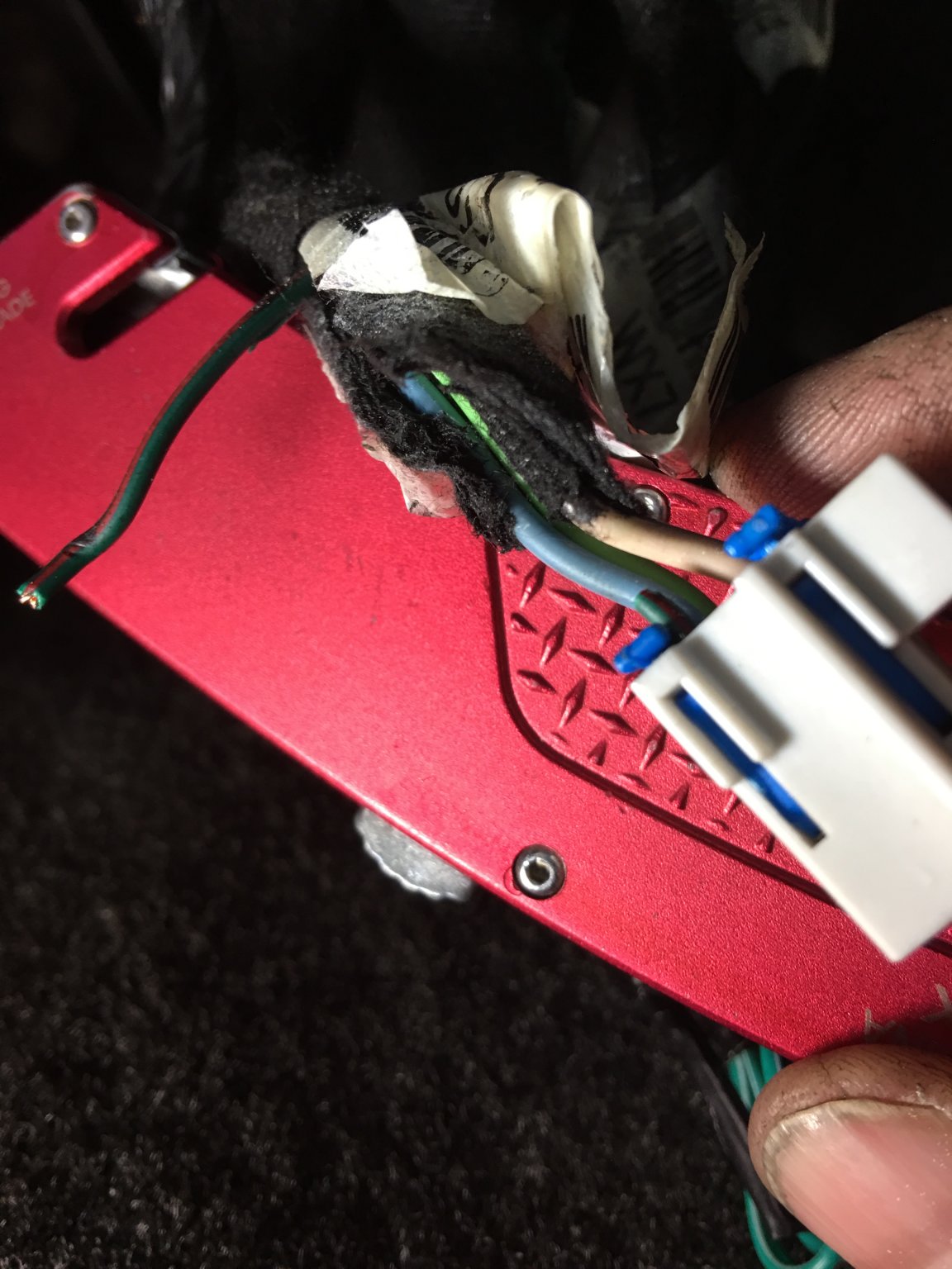

Its a LIVE !
Got it working , nice option to play :)
Cannot decide whom I will scare first ......
Got it !.... Mother in law :rolleyes:

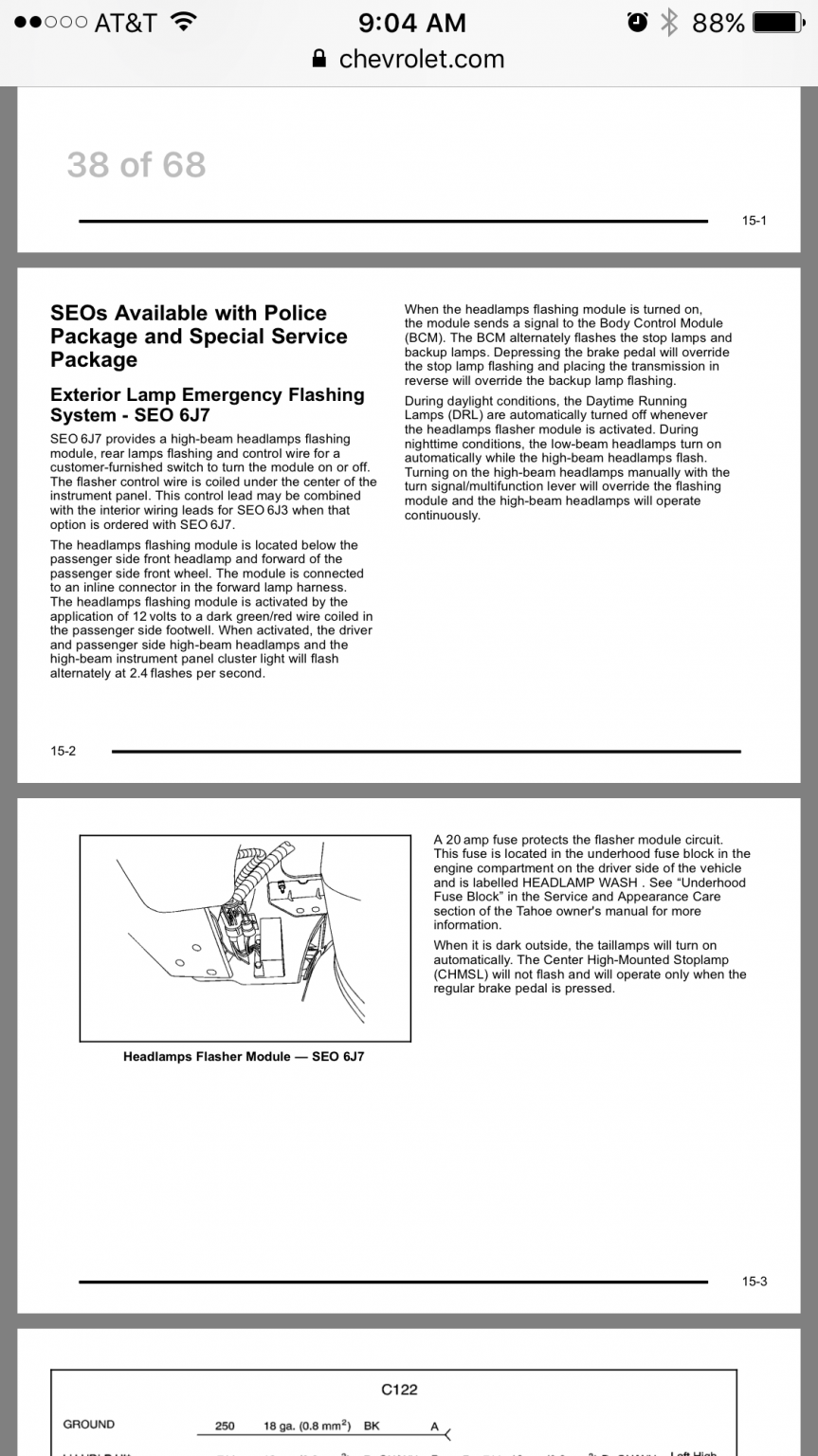

New here but I too found this wire on my 2014 PPV. I put 12 volts to it and nothing happened. What am I missing?

Do you have the flasher unit under the front of yours. In front of the passenger side tire I believe.
