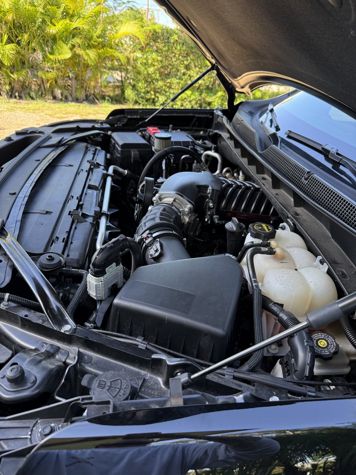

Now my question. I’d like to replace the factory air box. I like S&b but I’m not sure this could be done with the whipple. Has anyone or does anyone know of someone who has upgraded there intake? Thanks Brian

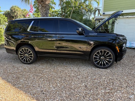

Pics of the truck, please.

Tell us about your current intake setup (not familiar with 2025 model year intakes). Is it currently a true cold air intake (intake air coming from somewhere other than the inside of the engine bay)? If it is, I don't see any reason to change it, unless you are doing it for the open hood aesthetics and looks.

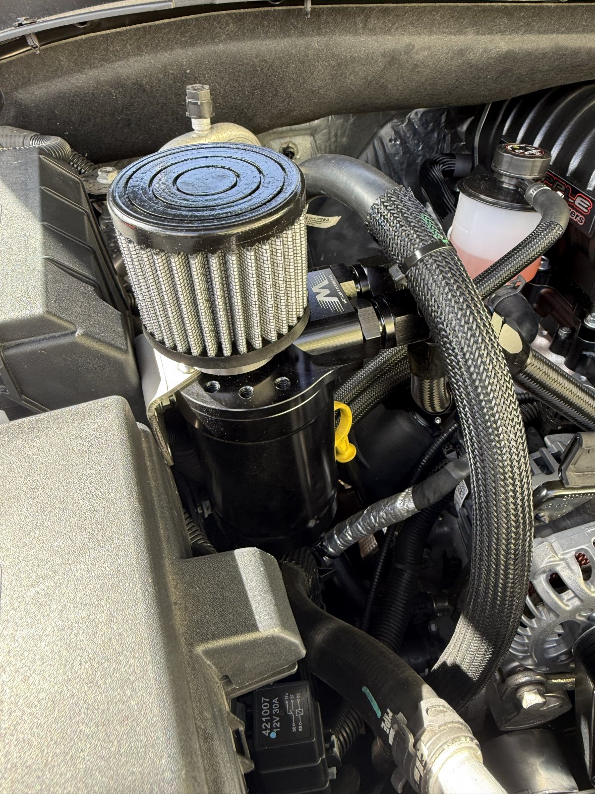

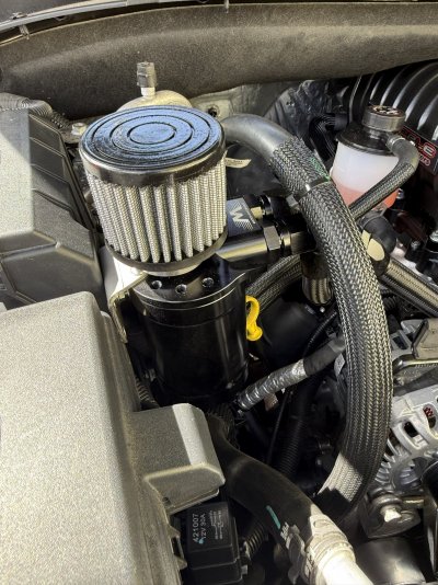

It’s more aesthetics than anything. I have to change out the catch can with the ac on and not in recirculating mode it smells like fuel in the cab.

Whipple told me to stick with the factory airbox also. I had the Momentum CAI from AFE but they said the factory box is a better fit. Put the K&n in the fatory air box and letit rip. All I did was dremmel out some of the extra plastic air baffling that sat against the fender and hot glued weatherstripping to the end to seal the box against the fender better. The sticky foam strip - what you would use to seal s set of attic steps when they fold up.

That's what Whipple told me as well. Original air box plus a K&N filter element.

Looking at the factory airbox versus the aftermarket air boxes, there doesn't seem much of a benefit to spend money for aftermarket. The factory looks like it is a very good intake system.
