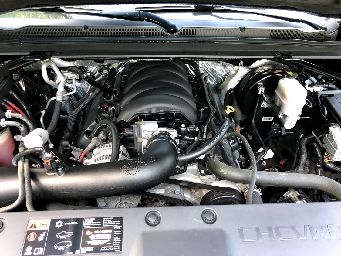

Before and after:
Also detailed the engine bay while I was in there and trimmed down the front air dam. Feels a bit better and has a nice growl that was missing before. Relatively easy install as most intake systems are...had to remove the mini brace to fit the air filter housing in and install it back over top but other than that maybe an hour tops.

Interesting! That explains why I had to remove the little brace to get it to fit. So far, no weird noises or issues though. Seems to be working nicely.
