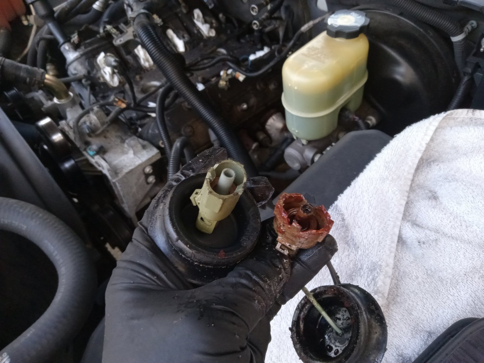

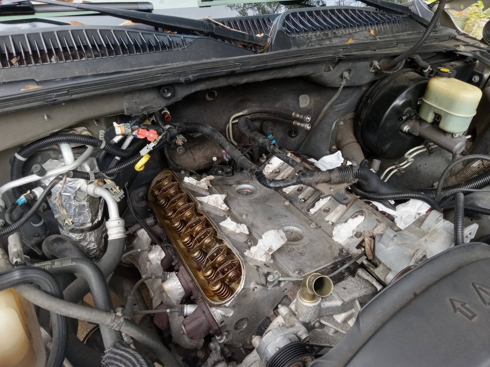

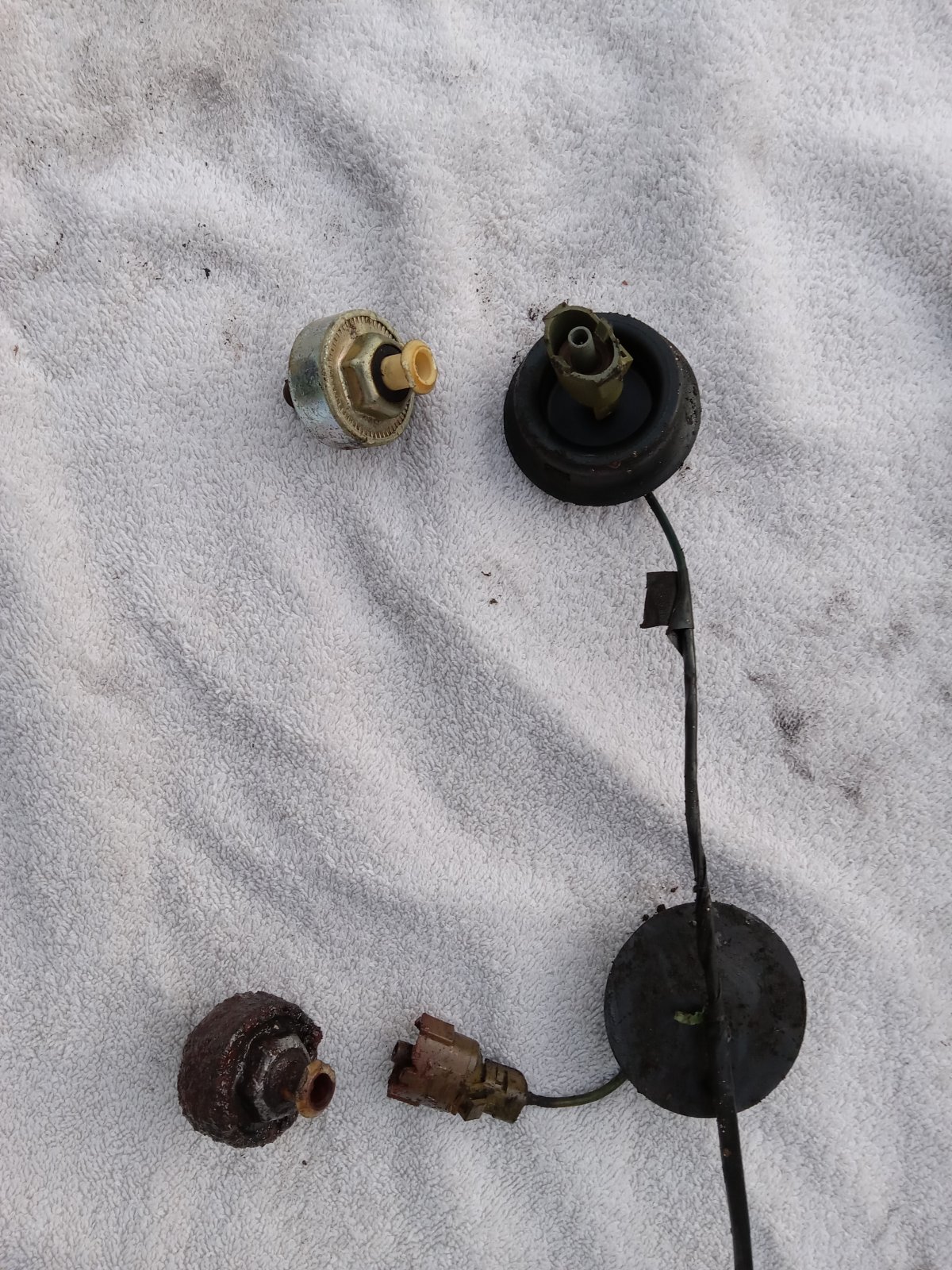

Been there and done what you're doing ('03 Denali XL 6.0).
I would highly recommend OE only for the knock sensors and harnesses. I buy almost everything from Rock Auto but like you couldn't find them there when I did our job so I went to Amazon for those. Your parts may vary, but here are the sensor and harness P/Ns for my rig:
Genuine GM 12601822 Knock Sensor Wire
AC DELCO 213-3521 OEM Knock Sensor
Here also is a repair video I found helpful:
In the video, you'll see some old gasket maker on a portion of the perimeter of the knock sensor cavity. I would have scraped and cleaned that off had I been them, being careful not to get any old gasket flakes into the sensor cavity (plug it with a shop towel).
As I did on our rig, I used new red high temp gasket maker on roughly the same portion of the perimeter seen in the video (NOT the full circumference).
As for your gaskets, I only use/trust FelPro for all our family's vehicles and have never been disappointed.
Hope that's helpful. Blessings on your task, my friend!
