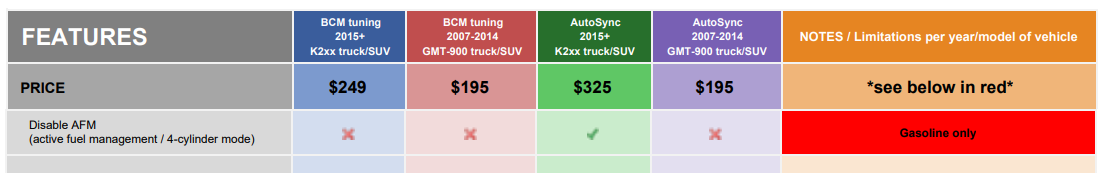

Can you confirm the AutoSync has the ability to disable AFM on your 2012? The BT Diesel website has the AFM disable only for the K2XX trucks.
Screenshot from website below.

Can't confirm because I have AFM disabled via a tune. The AutoSync shows it in its menu and you can select enable/disable. It shows the status on mine as disabled.
I would think if it's not available for our years it wouldn't show up as an option in the menu, but I may be wrong. The AutoSync may have all the programing for the different years in all of them, but only work for certain years.

AutoSync option does not have capability to disable the AFM on 2010-2014 unfortunately.
