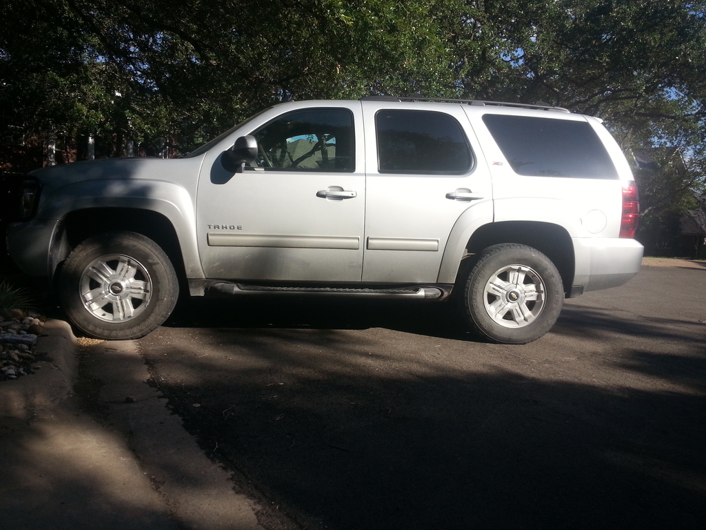

Your picture shows an NBS rig and to raise the front folks usually use keys for the torsion bars. The CCM kit is for NNBS rigs.
Guess I should've changed my signature sooner rather than later.

Before:

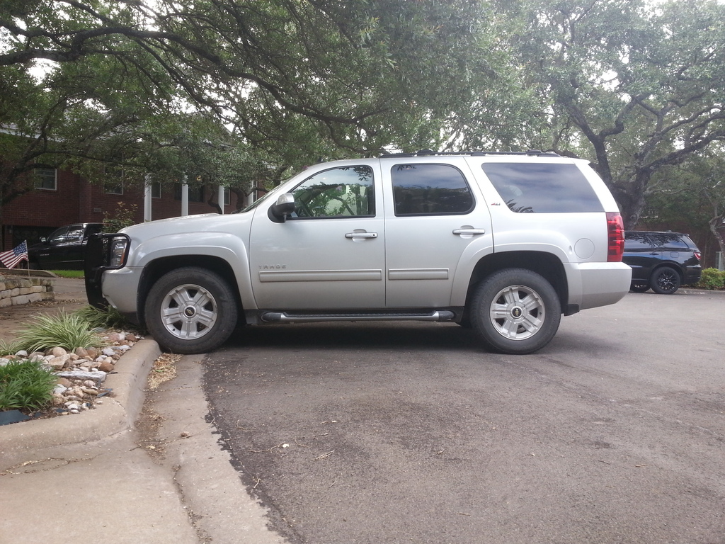

After:
I'm very happy about the look. Was $360 to install, but, oh well. Said he'd give it a look and retorque at no cost after a few hundred miles. But again, I'm very happy with the look.

Grimes, it does make it look better. What size are your tires there?
Think I measured 31.5 once, hope to get 32-33 once these wear. I'll go look at the code later. They are just some random bridgestone A/T tires not of my choosing nor preference.
Edit: 255/70R18
