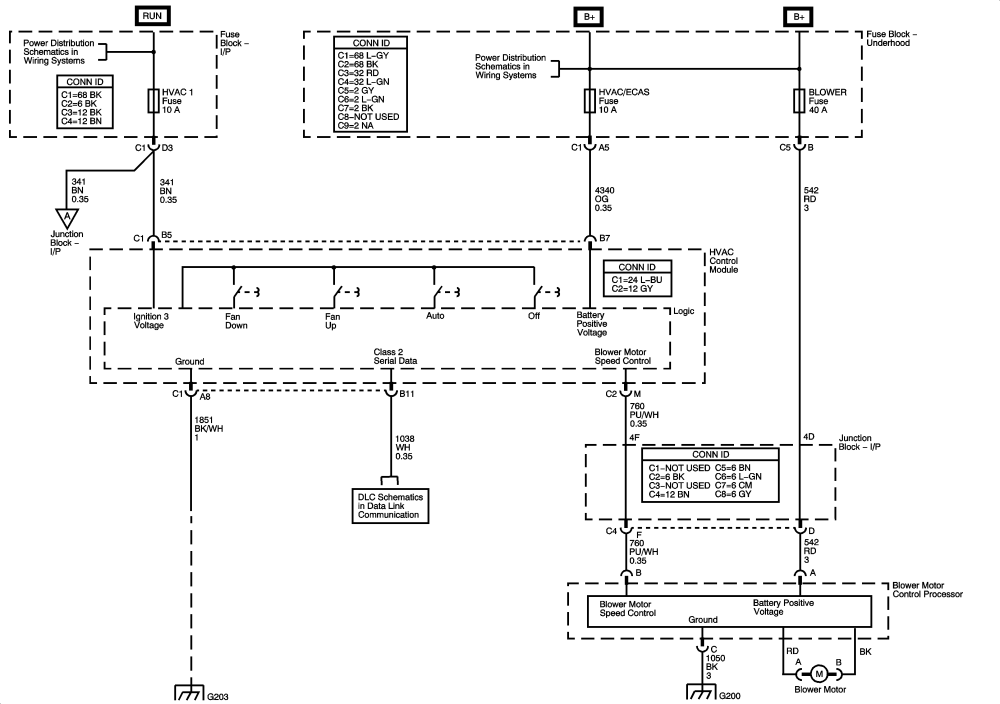

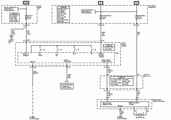

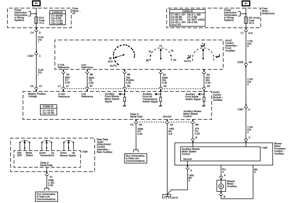

Im just not seeing anything in common with the front and the rear yet. The blowers themselves have independent fuses but check those anyway. I sure hope you know how to use a voltmeter. I would start with the front blower and check for 12v at blower module speed control (that module in your air duct left of the front blower). Should be 1-12v on Purple/White and then also the Red wire will have 12v. Make sure blower switch is set to max or you wont get a correct reading on Purple/White wire. If zero on Purple/White then check HVAC/ECAS 10A fuse first. If good fuse then check Purple/White wire coming out of HVAC control module which is what feeds the Purple/White to the Speed Control (this is your actual speed control wire and will have a variable voltage depending on what blower switch is set to for blower speed). This will be 1-12v if good. Wouldntg hurt to verify ground wire connection on speed control. Check resistance to ground to verify wire is good.
