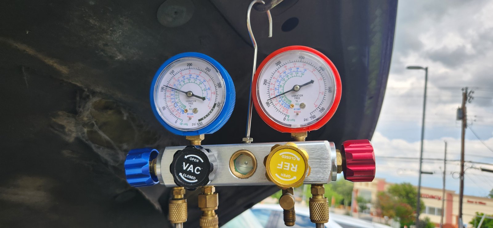

System held vacuum for an hour. All connections are tight. Harnesses plugged in. But my gauges are reading this which is weird.

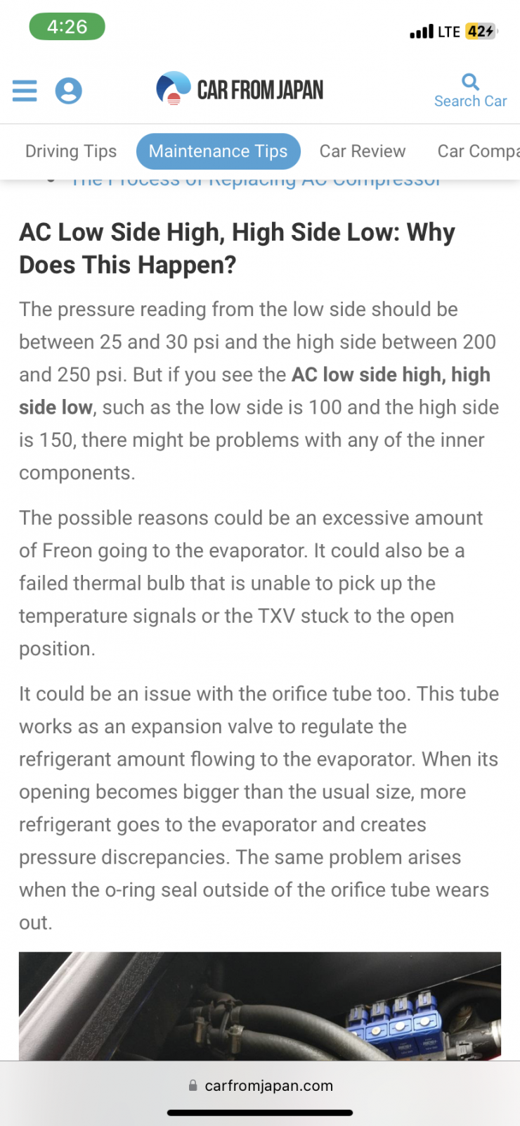

Maybe something there could help or be a clue, just hope you get it I just had to repair mine luckily was just a burnt up ac compressor clutch it’s getting to hot to ride without ac.
