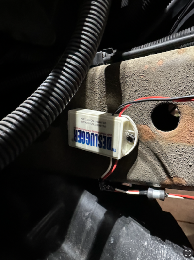

Update: I installed the stretch belt this afternoon along with the Deslugger. Checked the harmonic balancer pulley for smoothness while running and it runs true, and when I had the belts off I worked it back and forth looking for play on the rubber ring under the belt grooves and it's solid.
It was chilly here today (mid-40s) so I took it out for 3 test runs with many full-throttle pulls. The compressor engages smoothly and no problems with the belt popping off. Hopefully it's fixed. I have some road trips coming up so we will see.

Update. Stretch belt seems to be working great - no more problems with the belt slipping off so far. I let it sit for 3 days in colder temps and fired it up yesterday afternoon to take it to the grocery store. The initial compressor engagement took about half a second and was much less harsh than before adding the deslugger. After that, every time the compressor engaged it did so normally. As far as I can tell, the deslugger only engages on the first compressor engagement, and only after the ignition has been off for at least 30 minutes. That suggests a revised design than what @gooffeyguy described. I can see no downside to it at this point but I will keep an eye on it through the summer and report back.
Also, I used a sliver sharpie to mark the harmonic balancer as Don suggested and there has been no movement between the inner and outer parts.
