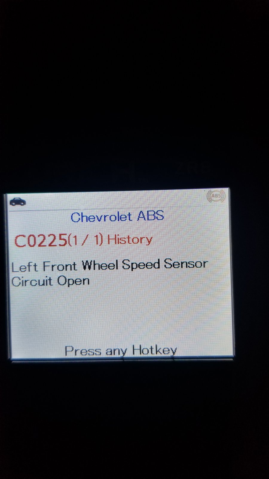

I managed to find my Zurich scanner does read ABS codes. Not live ABS data, but at least it sees the codes. History was C0225. Still happens mostly at 55+ MPH. I pulled the connector and sprayed with BrakeKleen, in case there was dirt or oil on there. See what happens tomorrow...

No ABS codes anywhere in the scanner after I cleared the C0225 Sunday night.

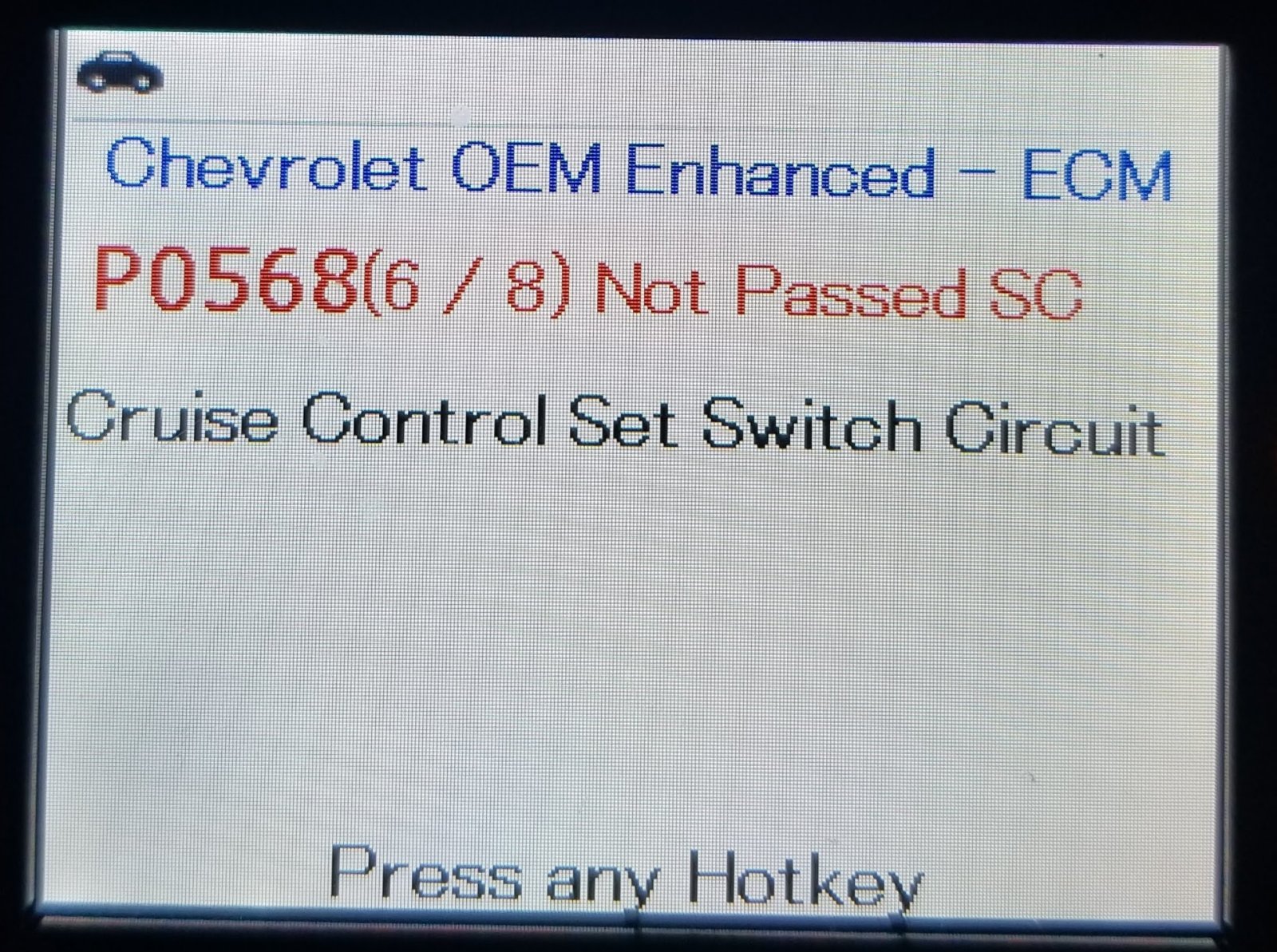

I cleared all those codes and scanned this morning. The same 8 codes are back plus 3 new ones... Knock Sensor Circuit Low Voltage, Knock Sensor 2 Bank 2 Low Voltage.
Still, nothing tripping CEL and main scan says no DTMs stored. These codes I see are only visible in the "Chevrolet OEM Enhanced - ECM" menu on my scanner.
Am I crazy to still lean towards possible grounding issues causing these weird codes while everything seems to be working functionally just fine?
It just doesn't seem like any of the codes listed in that sub-menu on my scanner are legitimate problems.

On Sunday, there were 8 of those codes in the "Chevrolet OEM Enhanced - ECM" section of my scanner. I cleared them. Today, there were 11. The same 8, plus another 3. Two were related to knock sensor circuit low voltage.
They weren't in there Sunday, but now they are. I agree, there should be a CEL, if sensors were bad. Engine purrs like a kitten and no CELS or DTM codes. Feels like the system is almost making these things up. Or maybe the scanner can't really clear codes stored in that part of the computer... ?

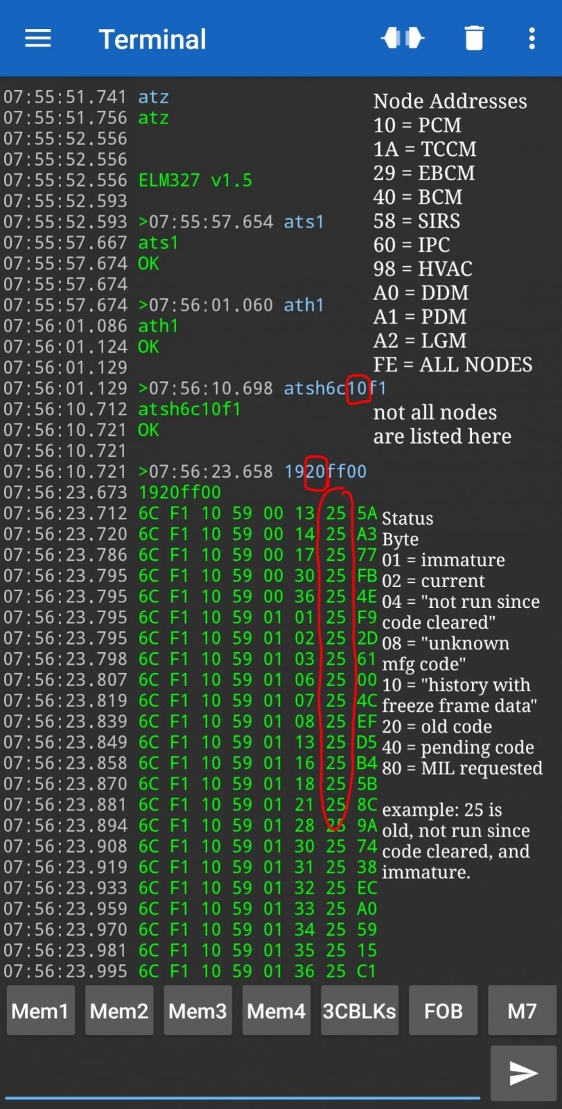

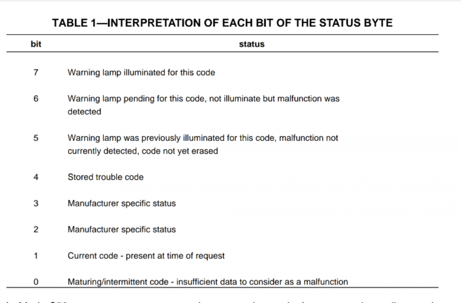

Just tossing this out here for what it's worth. The trouble with scanners is they don't always tell you the true status byte value but their intepretation. I read my codes hands-on, issuing the requests with a serial terminal so I see the actual response from the module, not some softwares translation.
First image is from SAE J 2190 describing the 8 levels of code status.
Second image is an annotated screenshot from my reading of codes from a PCM using a mode $19 request and asking for all codes with bit 5 set. May look like confusing gibberish but it isn't really all that hard to do and only requires a $15 OBD2 adapter.
Last image here is some of the basics of decoding the messages...

Thanks! I am fairly tech. savvy, but my head was spinning a bit after seeing that. I do get your point that the scanners do a bit of interpretation and translation that may or may not be the full or true story... Thanks for the information.

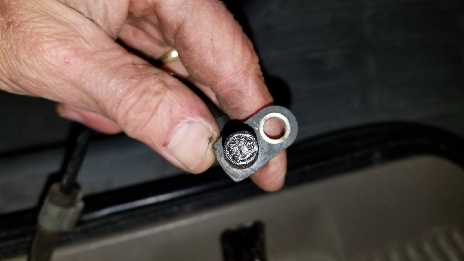

SOLVED!
I finally got to front rotors, pads and looking into the ABS sensor issue that was driving me bonkers on the highway... The issue I had was ABS check ran OK on start-up, no ABS lights/chimes driving anywhere around town. Only on the highway, after a couple of miles, the light/chime would come and go constantly. On my weekend commute of 30 miles each way, the chimes were driving me insane! Then they would go off and stay off, once I got off the highway and drove less than 50/55 MPH.
Potential suspect causes:
Bad wires/connections.
Bad sensor.
Bad hub.
Instead of cleaning and replacing the old sensor in the same hub or swapping positions with the problematic left sensor over to the right side to see if the issue follows or replacing the entire hub with a new one including a new sensor, I decided to try a new sensor first. Fewer steps and less chance of having to re-do hub and brake removals.
I bought NAPA brand ABS sensor (Echlin in this case) for $38. NAPA Part # UP 531158.
I got it on sale and had $5 in rewards points to use. Final total cost for the order was $28.90.
Hub was solid. It rotated easily and smoothly. It made no unusual groans or grinding noises. That was promising.
I pulled the old sensor out and inspected. There was a single shim under it, but the sensor looked like the tip was grinding into the reluctor ring in the hub. Kind of looked like the tip of the sensor was ground off and slightly curved. Maybe the last time the ABS light/chime came on, someone ordered an Amazon special or generic part that was just a hair too long. Not sure...
I sprayed down the reluctor wheel with BrakeKleen and blew it out with compressed air. That cleaned up the ring good. There was a very slight groove in the ring, probably from a sensor that was too long grinding into it... But, it didn't look too serious. I test fit the new sensor. It seemed like it made slight contact, so I re-used the single shim that was under the old sensor. Felt like it cleared perfectly. I put it in and completed the front brakes.
ABS test on start-up was OK. Things were off to a good start. No light/chime around town. Also a good sign. Real test was my usual weekend commute on the highway Saturday.
As of Sunday, I have driven 3 runs on the highway of 25 miles each. Highway aversion therapy is finally over!!! My sanity has been restored! No ABS lights or brain piercing chimes!!! I actually love driving my "new" Tahoe on the highway now. It just cruises along nice and quiet. These are fantastic vehicles and I am glad I got into one!
Thanks for all your support/advice! I managed to get off the hook pretty cheap and easy on this one. I am happy my Zurich scanner from Harbor Freight was able to narrow down the issue to the left front sensor. That saved me a lot of time trying to find the source of my problem and save me a lot of money by me not just replacing all the sensors to see what worked.
