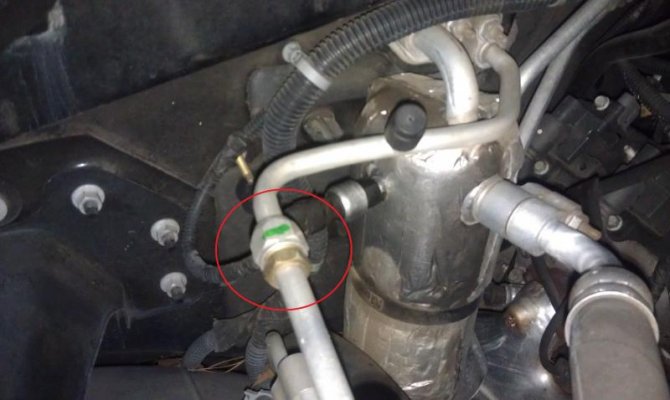

Orifice tube is in hardline forward (toward front bumper) of the brass nut. You have to remove fitting with green arrow on it to get to orifice tube. Do this when system has been evacuated of refrigerant.

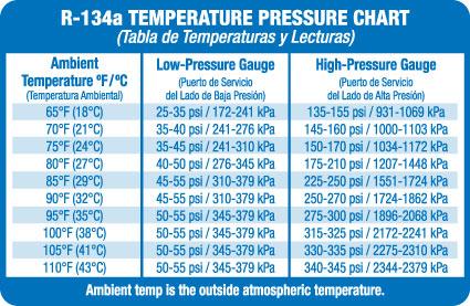

Charge by weighing it in with a scale or using the pressure chart for r134a. You will need just over 3 1/2 (12oz.) cans.
