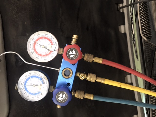

I’m having the same issues at idle on Suburban. Added a pusher fan from a 2500 and harness and no real improvement. Was hoping to avoid dropping money on an e-fan conversion
DurrtyBurB
Jun 8, 2020
46
162
AZ
Got a hold of a set of gauges. Ambient temp 108 f , outlet temp of 78f
