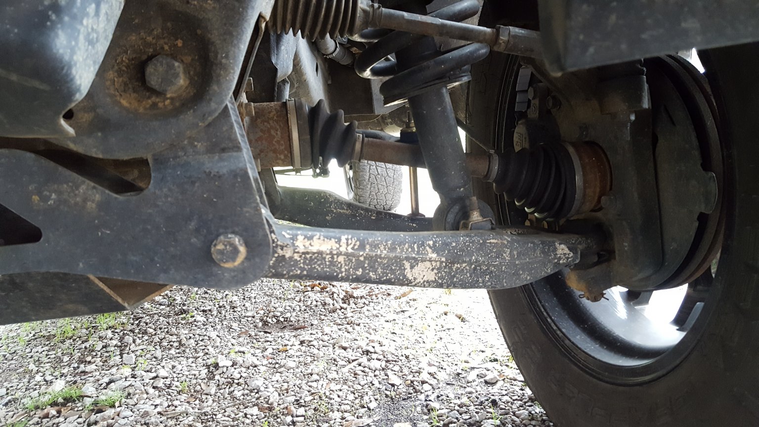

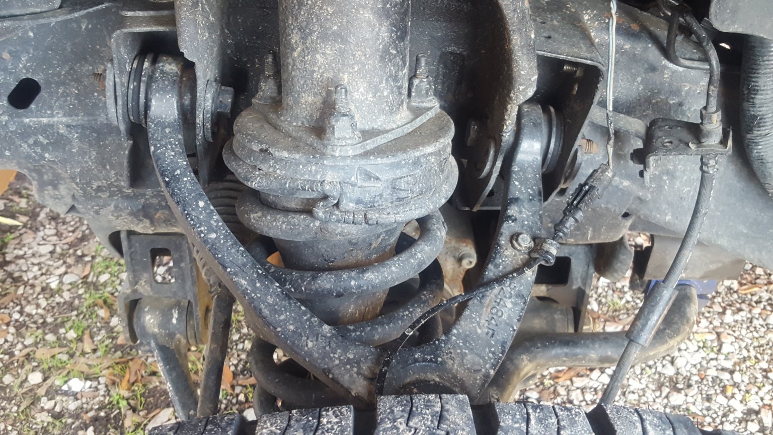

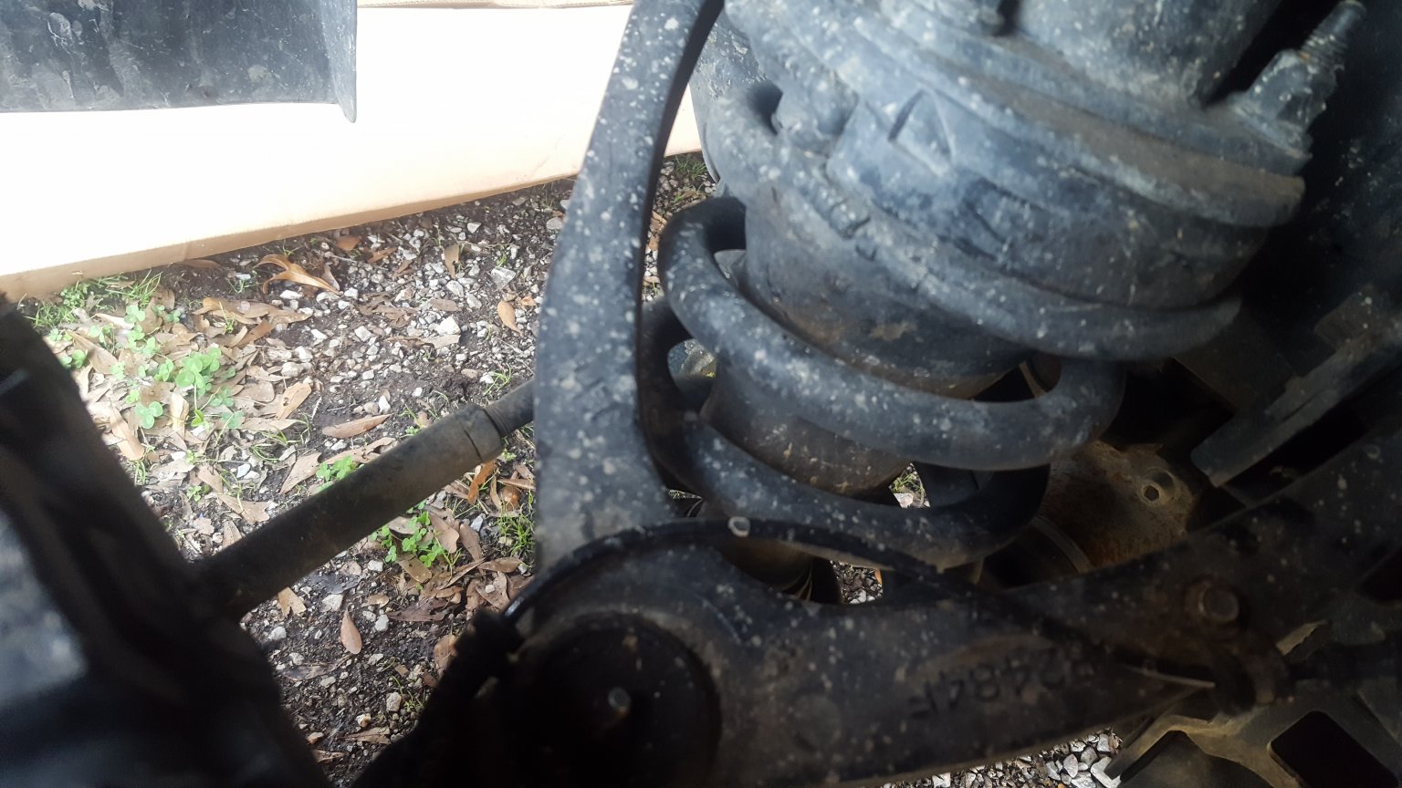

I have a 5" lift on my 07 hoe and a arms hit the coil springs anybody know if there is a replacement that will give me a little more Clarence

They shouldn't touch and have plenty of clearance. Got pics of lift and issue. Lift UCAs might give you the clearance.

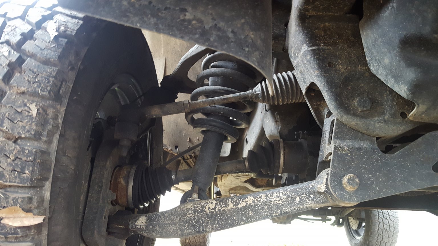

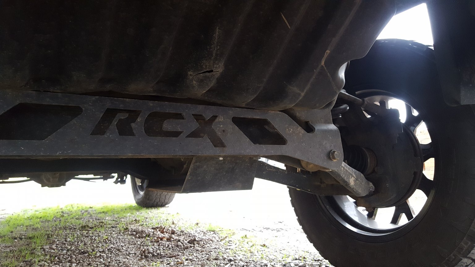

It's a rough country 5" lift at least i think it is the Spring mount is 6"

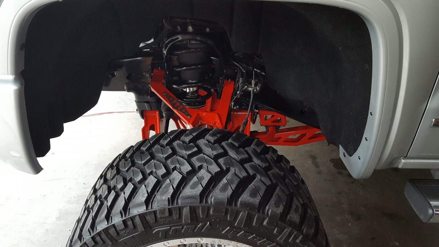

So its the left side of a arm hitting coil spring when down travel? The kit looks like a 5" RCX but can't tell if its a 7.5" unless I see bottom a arm and CV angles. I would think zone boxed arms would gain some clearance around that area with their shape. Here is a FTS pic of boxed arms for reference.

Those angles def give away its the 7.5" kit. I would try a set of boxed lift uppers to gain extra clearance around the coil. Get pics posted once you get all the work done, it should look pretty good.

Them brake lines looks like they may be screaming as well. Have you had the alignment checked recently, a look at how your tires are wearing will let you know if your UCA needs adjustment. Second the replacement of the UCA as well though. When going over the 2.5 leveling kits you should be looking at changing out more than what just the kits come with nowadays.
