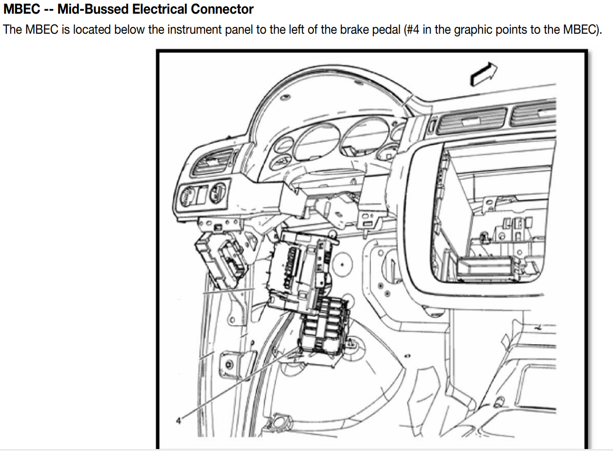

Short of tapping into your radio, hvac, or vcim connectors...
I recommend using the MBEC.
You will need to wire the main relay power direct from battery of course.

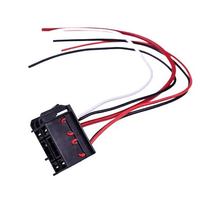

I meant on the switches themselves, which pin is main 12v and which is ground, because I didn't get the fuse box thingy with it, thanks for the help

From UI (upfitter integration) bulletin #153d
Pin 1 ground
Pin 13 power

just ordered this setup any help on what wires i can remove or the colors of the 1s i need to keep? doing this to my lbz duramax

I connected wires 1, 3, 7, 11, 13.
Don't need #13 if you want your switches powered all the time.
