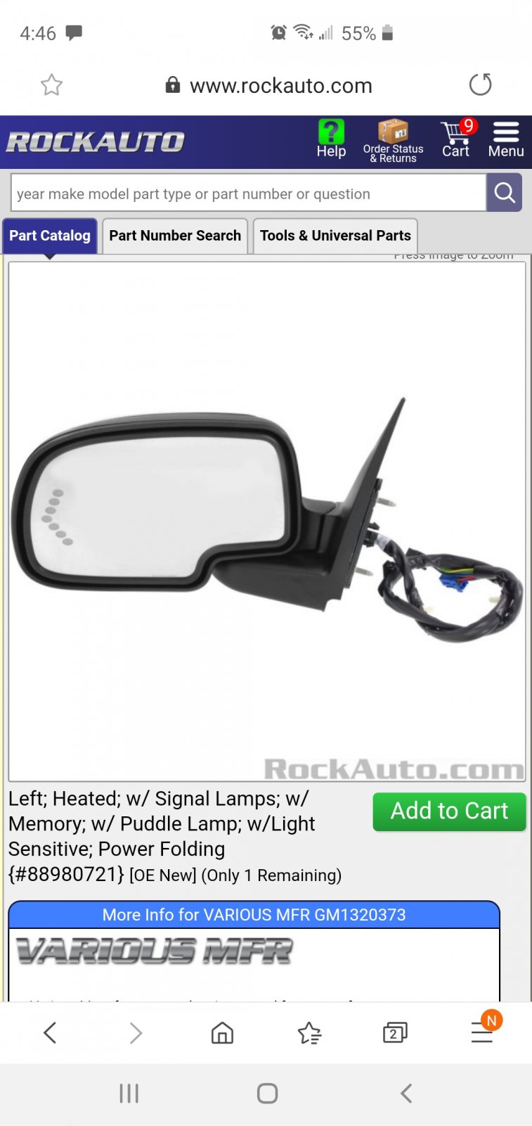

not sure if that one will actually fit tho. there seems to be alot of discrepancies in mirrors between 99-02. some list mirrors for 99-02 that all fit some list it as 99 and down. that particular one is listed 2002 yukon but is only listed with one of the 3 yukons of that year. its listed as yukon, yukon 1500, yukon 2500. that particular mirror only shows up for 02 yukon 1500 and is not listed for other years or other yukon variations. ive noticed the same problem while searching other gm parts tho. i was once considering the dynomax exhaust. it would list in the yukon section for the same year and engine but not the tahoe. same exhaust setup and if i looked up the part number elsewhere it would show as fitting.my Tahoe.

They were available on GMC SLT (Chevrolet LT) trim levels with the ZM9 package. Part numbers are 15764747 (left) and 15764748 (right).
There are aftermarket ones on amazon (sorry, can’t figure out how to post the link so here’s a screenshot). GM versions typically don’t shake as much as the aftermarket, so tracking down some of those may be worth a shot.

those ones aren't autodimming @east302
it says light sensitive but if you scroll down it says excludes auto dimming. i didnt think finding them would be very difficult so i started looking myself. manual, power, power and heated are easy to find. auto dimm feature makes it a hard find.
You know, I thought that seemed kind of cheap for an auto-dim. That’s a tricky play on words on their part, then.
A quick google search for the part numbers seems to show them available from GM in the $4-500 range. Maybe check with a dealer? They’d probably work better anyways.
