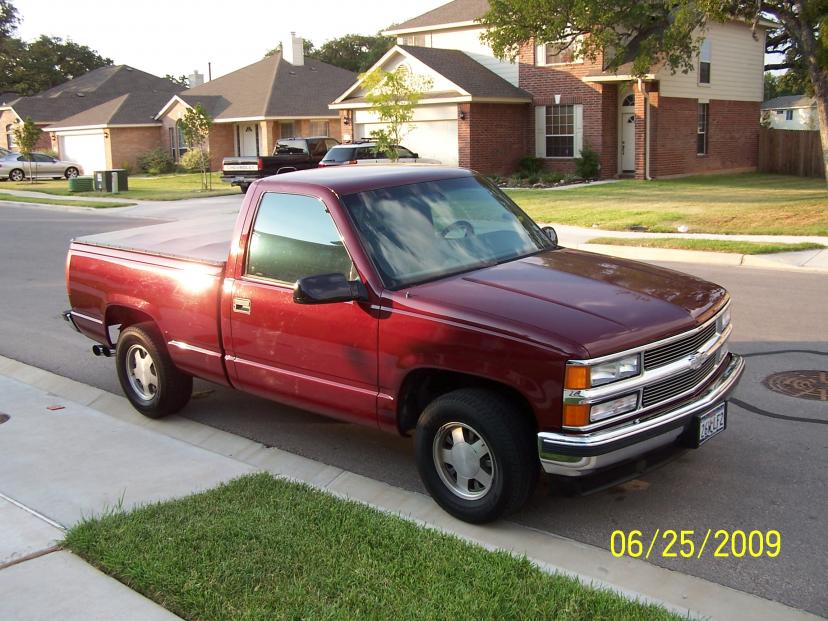

Pics of my truck the money pit! Ask hapyspaz he can elaborate on this detail.....

Looking good, now just gotta hit it with some polish and wax and it'll shine like crazy.

Has not been washed in two weeks lost track of time between work and sick 15 month old. Will be taking it to AMM paint here very soon for a go over! IF you are offering to do it for me I will take the help!!!!!:)

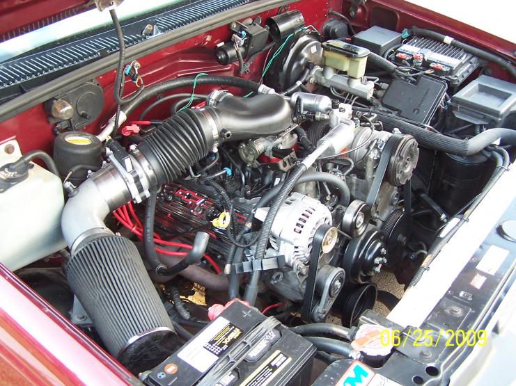

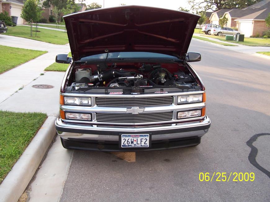

New motor and it has been a PAIN to get it up and running! Its a 5.7 zz4 base block with aluminum fast burn heads comp cam duration 262/264 lift .450/.480. ARP studs with moroso 6 qt pan and high volume oil pump and upgraded to mpfi injectors. Unseen is a turbo 400 custom install with 410 rear end and true dual exhaust from the headers with a h pipe. This was my first engine to do myself and in the future it will be crate engines but you have to build at least one to really understand the complexity of it.Next step is Blackbear tune I think my ecm hates me and the cam!

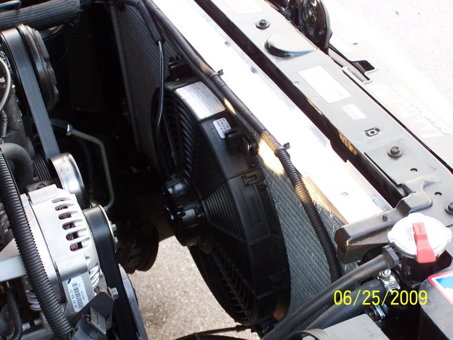

Running a fan control from Hayden has a temp sensor in the radiator made by hayden. The first test of the unit was in traffic yesterday it was 107 outside I dont use the a/c so it never got above 200. I would like it colder so I will eventually get a second unit for it. Blueflame I would love to carb it way cheaper and I could get a BIGGER cam!!! but the emissions freaks would not let it pass.
