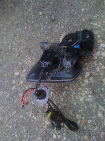

i dont think the 880 will fit..i cracked the ceramic coated wire on the side of the bulb trying to push the bulb into the housing so it can turn and "click" i think the bulb needs to be a 1/8 inch shorter.not sure what happens when you crack the coating on that wire..anybody ever have this happen?
So i tried the light and it still works fine so far. i decided that the only way this is going to work is with a hot glue gun. i put a bead around the hole and placed the light in. i held it in place til the glue hardened and applied more to the outside.i then went around it with electrical tape and here is a pic.i recomend taking the fog lights off for easy access as its just two bolts. i am now waiting til tomorrow to put it in and do the other side.i am also going to order some spare bulbs as they are only $15 a pair..(i hooked up the lights to my friends headlight ballast for easy access)

Thats one way to do it.. I may dremel it, if I do I'll post it up, if it works. Your method looks like it will hold up, but whenever I try to rig something up like that I screw up somewhere.

ya another option would be a put a little spacer in there.there were 4 screws that you could take out and put a 1/4 inch of something to make enough room. i got 3 of them out and the 4th stripped so i just glued..lol.
ya i figure im going to get all new headlights/signals/fogs and get a new grill next year with a street sceene insert(already have the insert) so it didnt bother me that they were glued and taped.ill do the spacer with the fogs then.(would be alot easier if the bulb was just a bit shorter.lol.

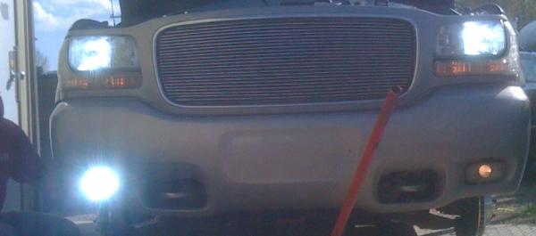

but anyway i had my first night time drive last night and i couldnt stop smiling!!! one of my best mods yet! you see the difference is CRAZY!!
