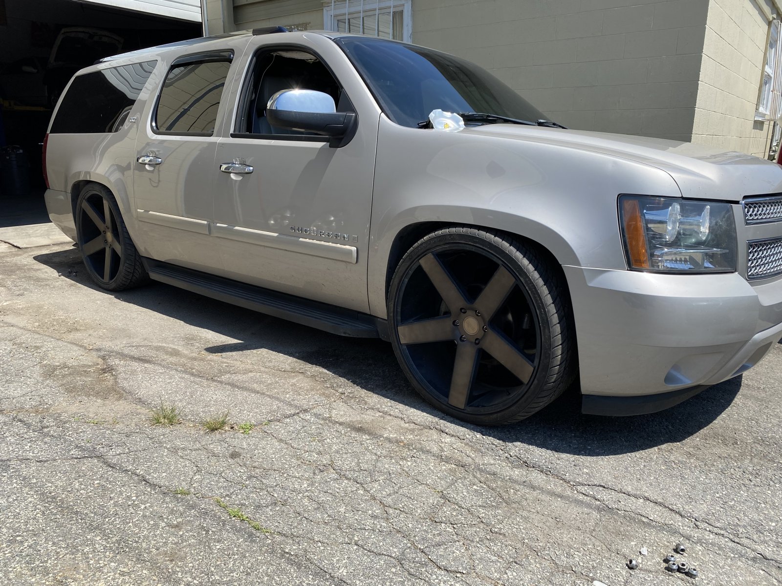

Truck measures 7/10 lower than factory with the 20’s. Obviously it was lifted slightly with the 26’s. Need to do some cutting and hammering to get the front down slightly and not cause big issues

So what are the fender lip to ground measurements?
I didn’t bother measuring because I only had the passenger side on plus I need to do some trimming up front and possibly go a little lower. Once they’re all on and I’ve driven around for a day or 2 I’ll get an actual measurement

What mods to the front will you have to do to clear? Push the fenders out?
Is the rear clear or will it need a little clearance as well? Tubs?

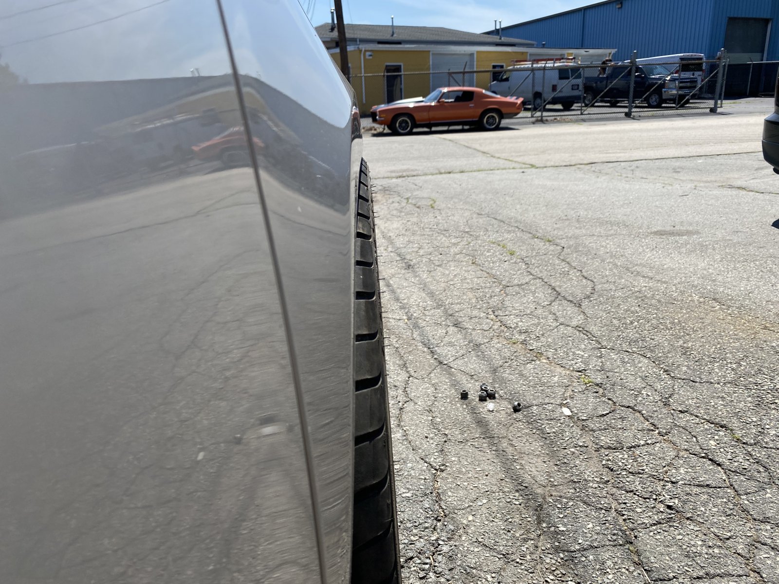

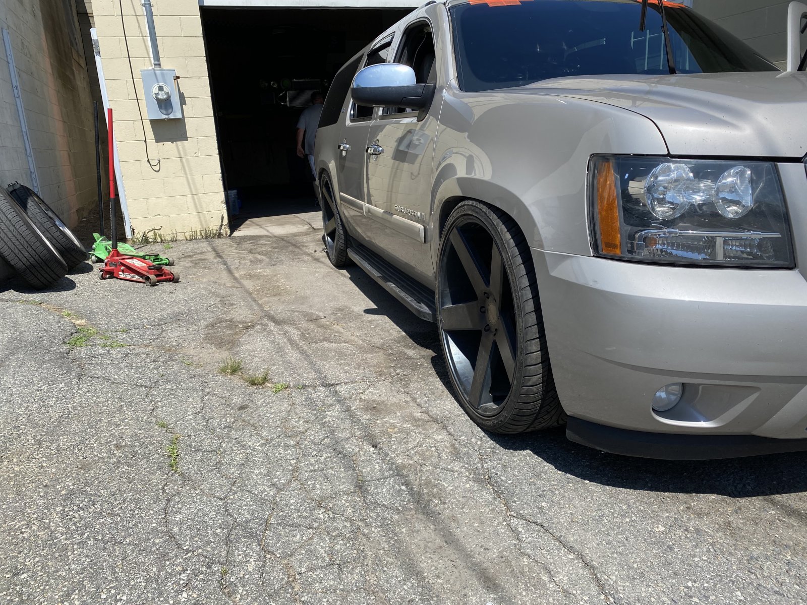

I haven’t done anything yet but the front hits the firewall when turning so that will need some massaging. I’m going to have to cut and roll the front fender lips
the rear is touching the plastics near the doors so I’ll have to cut those out and see if there’s any metal that has to be massaged
