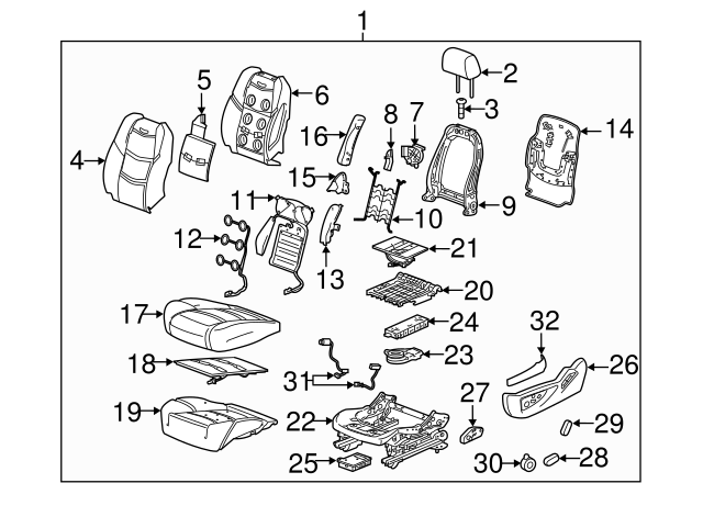

Are you describing the removal of the seat cover? I've got that down I feel. What I need help with is getting the foam off the upper seat back so I can see any belts or whatever pulls the horizontal lumbars pads back and forth on their motor. I assume the motor is a separate unit than the one for sliding the seat up, down, fwd, back. I think it would be mounted on a vertical frame part so it can pull and push those pads.
Big Mama
Jul 21, 2015
3,881
2,499
Virginia
Sorry the foam is usually glued on. When you pull it off some of the foam will stick to the springs. If you remove the cover the pieces you want to see should be in plain sight. Here’s a diagram of the seat

Thanks for that diagram! Sorry had a water leak in house to deal with... the seat that they are using here is not a 6 way power seat though... any other companies that you know might have these? That company's phones are not working.
