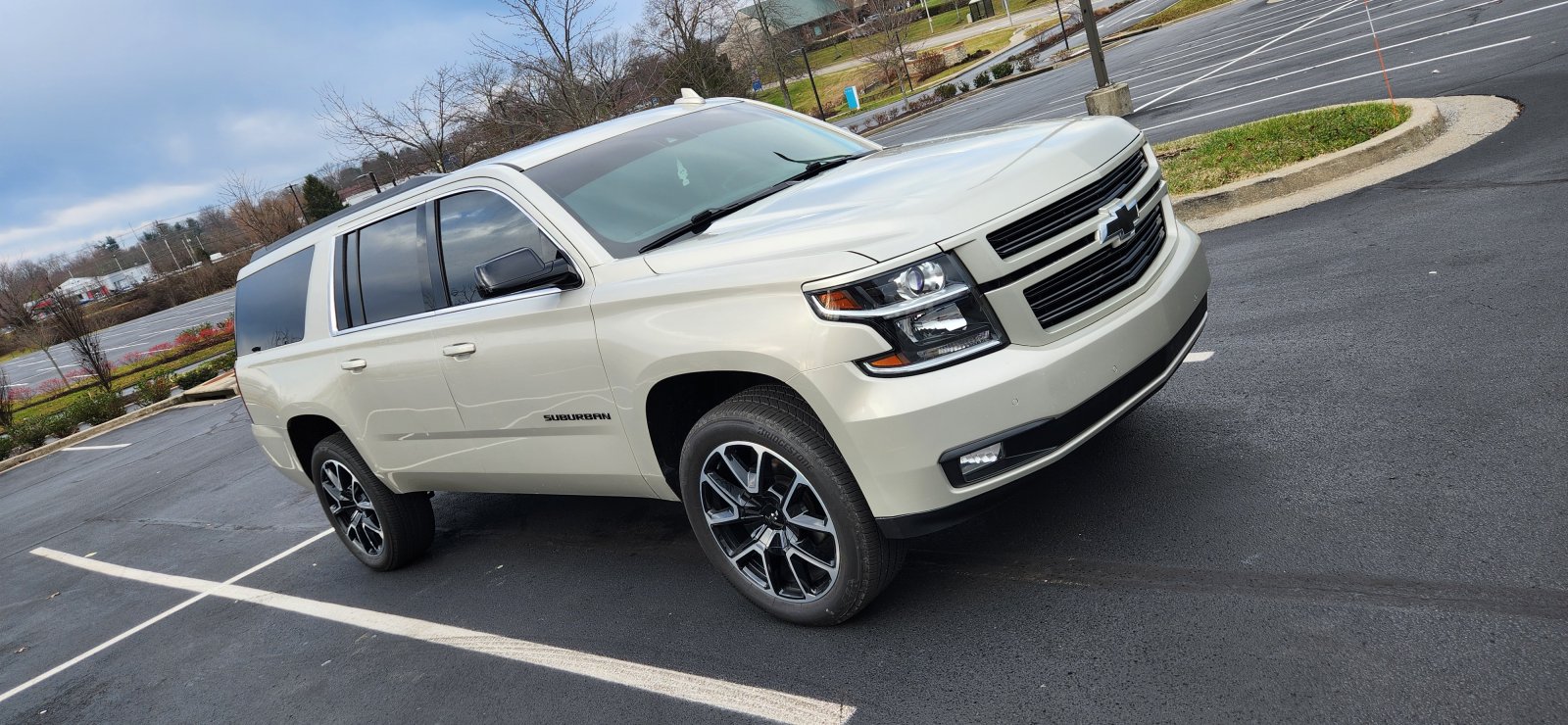

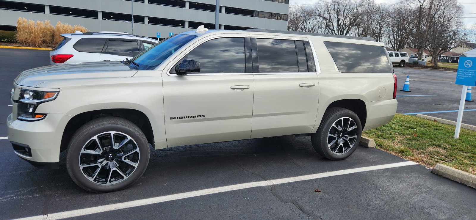

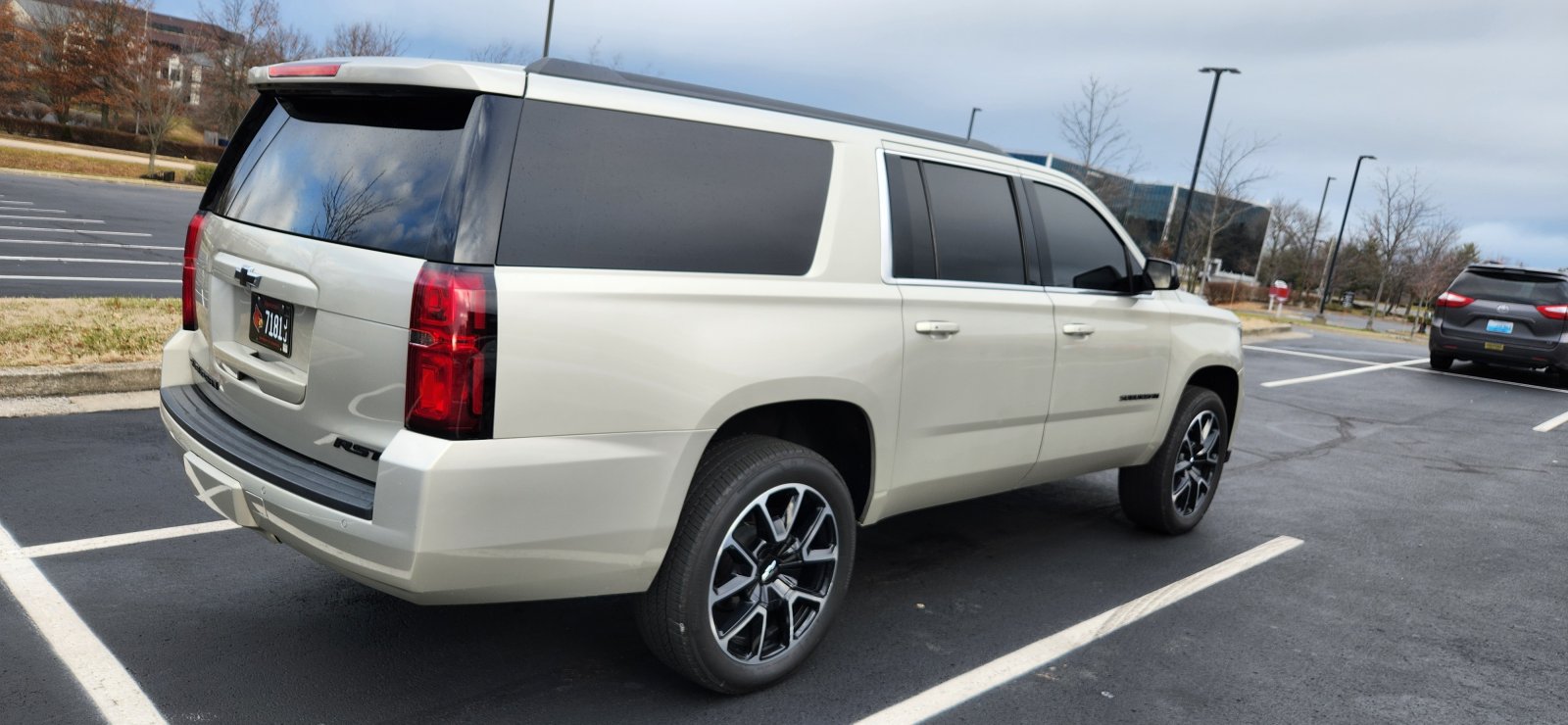

In the meantime, I have been doing an "RST conversion". At least that's what I'm calling it. Complete with color matched LTZ grill, black mirror caps, black badges, black D pillars, and RST rims. Also trimmed the lower valance to 3 inches. I will include pics below of the cosmetic mods. Be sure to like, comment, and subscribe to my YouTube channel. It's been VERY cold here, so I've been slow about posting new content lately but I'm looking to get back to it soon! Planning to get some full throttle runs for the next videos I'll be posting!

View attachment 420224View attachment 420225View attachment 420226
Make sure you have proof of the actual mileage on the new drivetrain, and what the odometer said once the drivetrain was installed and running. So even though the body has 189k, the drivetrain doesn't. I couldn't even guess what someone would be willing to pay for it. What would a stock comparable vehicle in similar condition go for? I'd go from there, and maybe add another 10k--or a little less. That's just off the top of my head.
