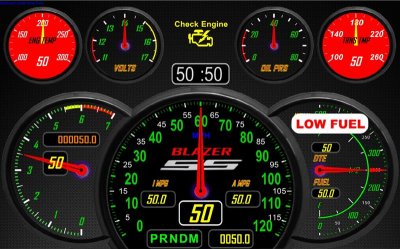

Here's the latest version of my dash. Needle positions and numbers are random and nonsensical in these screen shots. The upper four gauges turn red individually when out of safe operating limits. The crosshatch pattern over the speedo and the red push button top center appear if the connection is lost to the ECM. Pushing the button initiates a connection attempt immediately, or one will be made automatically in 30 seconds. The low fuel warning appears at and below 3 gallons fuel remaining. 0 Gallons displayed is when the engine dies due to fuel starvation, no reserve, no guessing exactly how much fuel is left. Touching the upper half of the speedo switches to Metric. Touching the A MPG window resets average MPG. DTE (Distance To Empty) is based off fuel remaining and Average MPG displayed. Touching the Trip Odometer resets that to 0. The large digit on the left of the tach is the commanded gear. I removed Engine Oil Temp because there is no sensor--it's calculated by the ECM. Inaccurate because I have a large oil cooler the ECM doesn't know about. "V4 Mode Active" appears above the clock--along with a blue light right below the "I MPG" window--when DOD kicks in.
It's running off of a Bluetooth connection now, but will be hard wired off of a USB connection when I mount the cluster permanently. The USB connection is faster--smoother needle movement and faster connections--and more reliable. The Samsung Tab S 10.5 is easily visible under all lighting conditions including direct sunlight with these colors. It is especially attractive under moderate and lower light levels.
Anyways, that's it so far! I'll include a video later.
