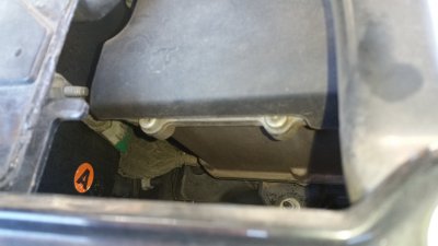

since you are having a bunch of engine codes as well as a random misfire this might be correct bad ground wires GM used Aluminium wires and cable lugs to cut a corner .. and when they do bad they go bad..
View attachment 237525 View attachment 237526
Just for now run it on M when making a left turn or near train tracks
minimize the risk of stalling out.

i plan to swap out my grounds pretty soon with heavy duty copper cables with tinned copper lugs...
i used solvents(Isopropyl alcohol 91% ) to clean mine (and scrub brush ) for now to get me by the float voltage is 13.0/13.1 and charging voltage is 14.8-14.9
before the float voltage was 12.4-12.6v and 14.4-14.6v...
just be careful with the alcohol you don't want to get your suv drunk (it's highly flammable )
there is 6 connections total from the battery to the inverter (ground wires)
on the AUX pump i would check the wires they fail on the 2008-09 models but the pump is ok
those have an issue with the negative terminal as well coming loose (check both of them they should be securely in place)
i would confirm 100% before "spending money on the AUX pump"
