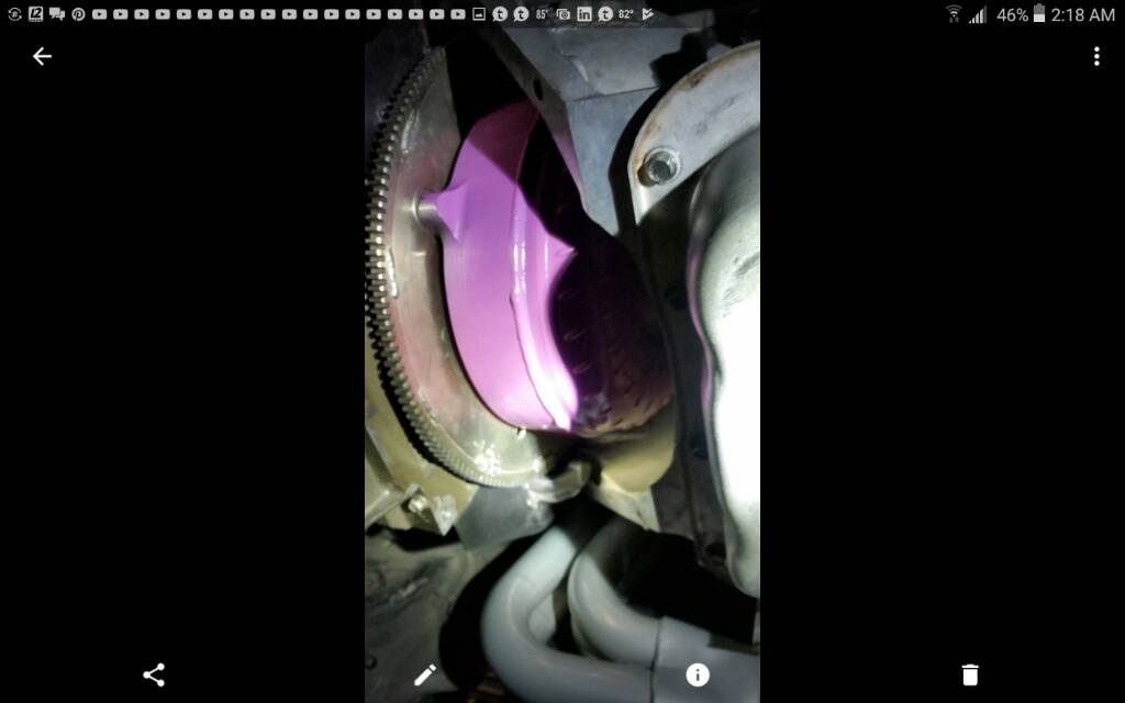

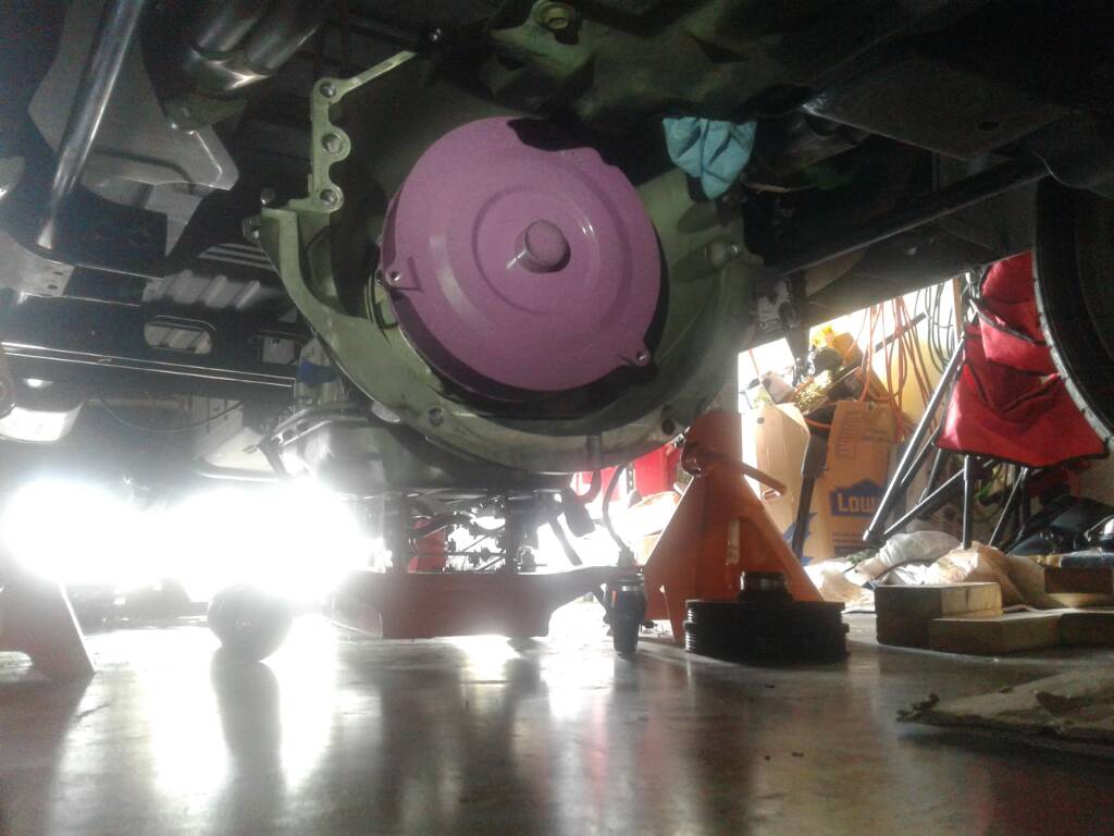

OK, I've been trying to work out the bugs on this swap. I honestly only have one issue of no TCC lockup..
Background-
0411 pcm swap from 02 Escalade- fan control issues with stock pcm.
Trans is a 4l85 from an 08 Chevy express van
Transgo shift kit with sonnax boost pressure relief valve instead of transgos
Converter- Vigilante triple disc 3k stall
Speartech adapter harness with vss pigtail for 2nd speed sensor
New internal Trans harness and manual boost valve
Blackbear tuned with Autocal
I initially swapped the cammed 6ltr with 4l65 in and BB updated the tune via auto cal. Ran this combo for almost a year. No codes or anything. Blew the 4l65 and swapped in the 4l80 using the above parts. As soon as I loaded the 4l80 tune my Traction control light came on. I couldn't turn it off, just stay lit. After getting the fluids in the trans and doing some test drives everything seemed OK except the TC light. On my 3rd start I get check engine light and codes PCM 1810 and ABS CO279. I can clear the codes but they come back on 3rd start. Since the truck seemed to be driving normal I decided to take it thru all the gears. 1-2 shift is smooth and solid as well as 2-3, but as soon as it tries to lock the converter it shudders in and out of OD. This is the only drivability issue I have which is big.
Spoke to Justin about the problem and he thinks it's the abs computer, but I can swap the original 6.0 tune back and the traction control light will turn off. The only code I found for abs co279 is a JL4 ABS issue which my truck doesn't have the JL4 option.
Since I didn't splice any wires and only added 2 pins to the pcm I'm confident I didn't screw up the install.
Anyone have any feedback on this because the 80e is a beast of a transmission and I love how it shifts. Just need this issue resolved.
Some pics for attention lol..
