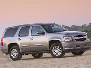

Does anyone know if the hybrid wheels from the NNBS line will clear these brakes or is there not enough offset? Wheels are 18 inches.
