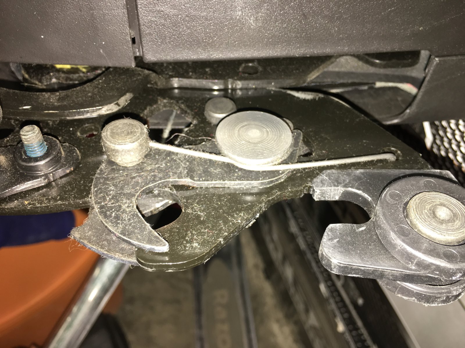

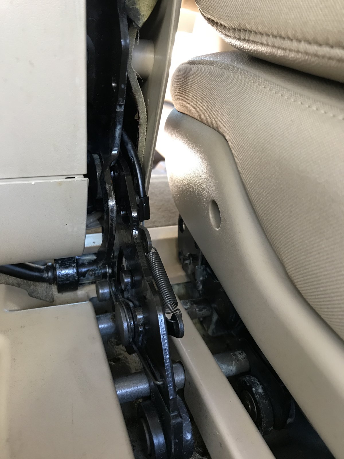

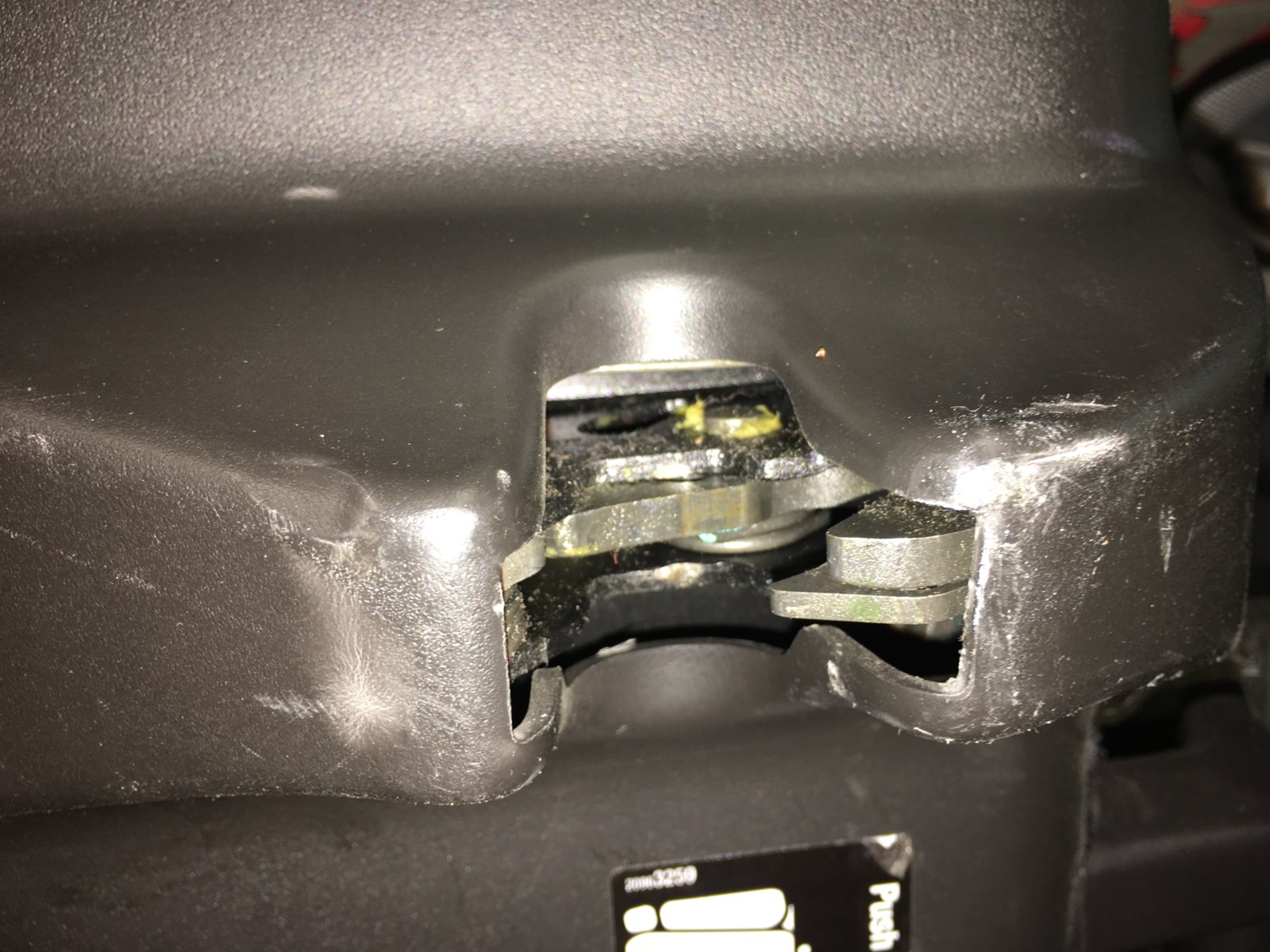

Tim - let's see a photo of what you're workin with. "still won't come out" is a pretty weak response.

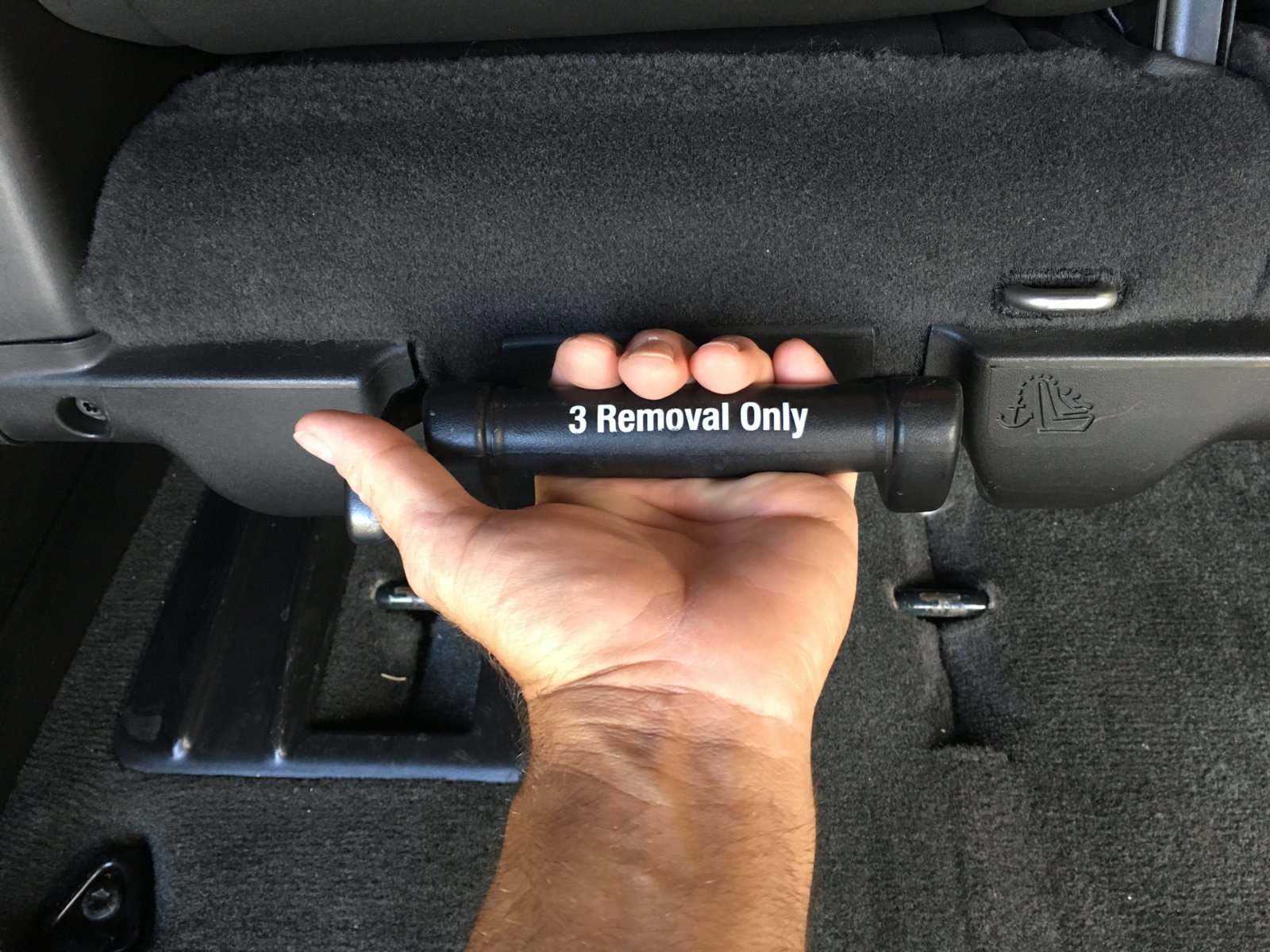

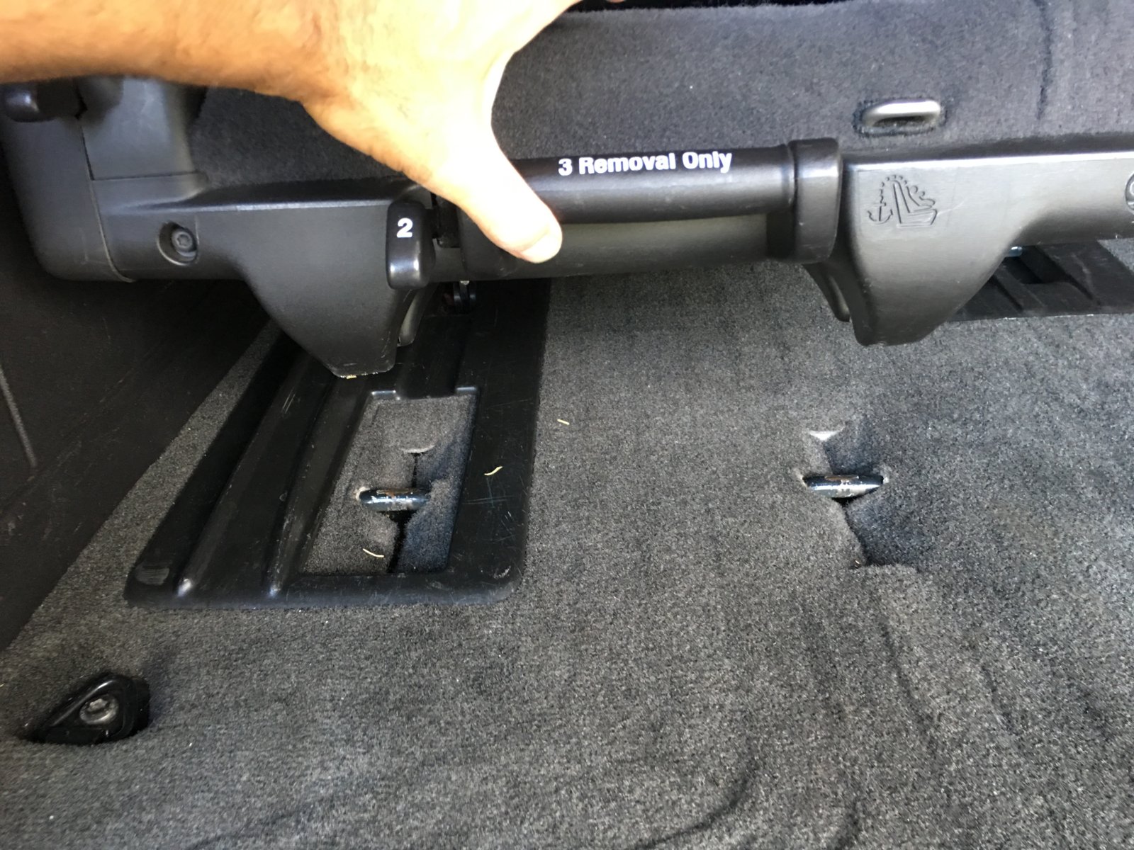

Ok, pull up on #1 so back of seat is down flat next lift up on #2 lever and raise seat about 6" then drop it down to about 2-3 above floor and pull on #3 handle and it should come right out... if not im sorry.... just did mine 9000 times

I'm resurrecting this, I have a similar problem. I can't get one of my 3rd row seats to release from the #2 latch to fold up so I can pull it out with the #3 handle. If that makes sense... Anybody have any suggestions on how I can get the #2 lever to release?
