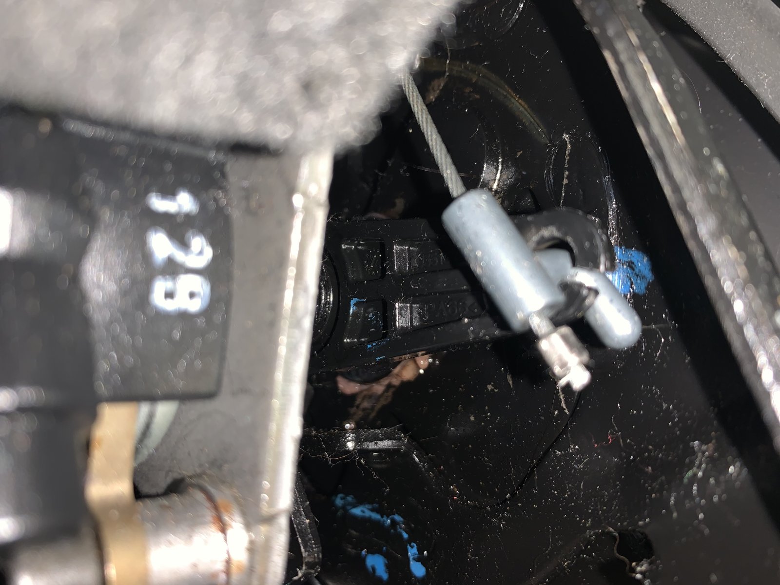

Here is what happened with mine. If you have the seat folded down, you can fold back the "flap" to expose the sides of the seat. There is a metal cable with a hook on the end that threads through a plastic piece on both sides of the wider seat that release it allowing it to fold up and down (only one side of the single seat). My cable came out of the plastic piece, so I used needle nose pliers to put it back in place. You can manually push the plastic piece forward with plyers and then should be able to fold the seat down with the button which makes it easier to access everything and fix it. You may also have to remove the storage compartment in the back to access it if the seat is stuck in the upright position.
If the plastic piece has cracked like mine (see picture), that's a bigger issue as the cable comes out easily. The dealer told me they would have to replace the whole assembly for $700+. I'm trying to find out if I can just get the plastic part and swap it out myself.
I would slap a few tywraps and some electrical tape on there and until the entire ‘plastic arm’ breaks you should be fine.

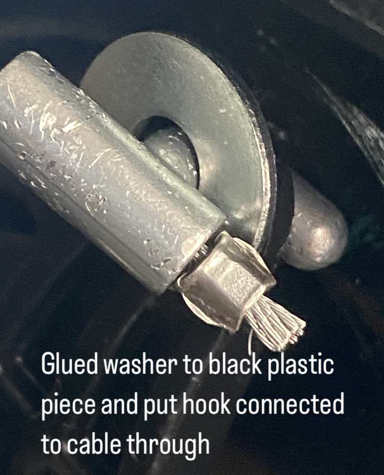

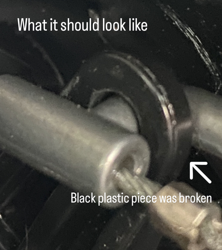

Add22
Aug 26, 2022
Fixed it! Thanks to the posts above I was able to determine why the seat wasn’t going down. It was making the whirring sound but nothing was happening. We determined there was a break in the plastic piece that holds the cable.
I glued a washer to the plastic and it holds the cable now and the seat is working.
Was so relieved that it wasn’t a problem with the electric motor. Hope this helps.
