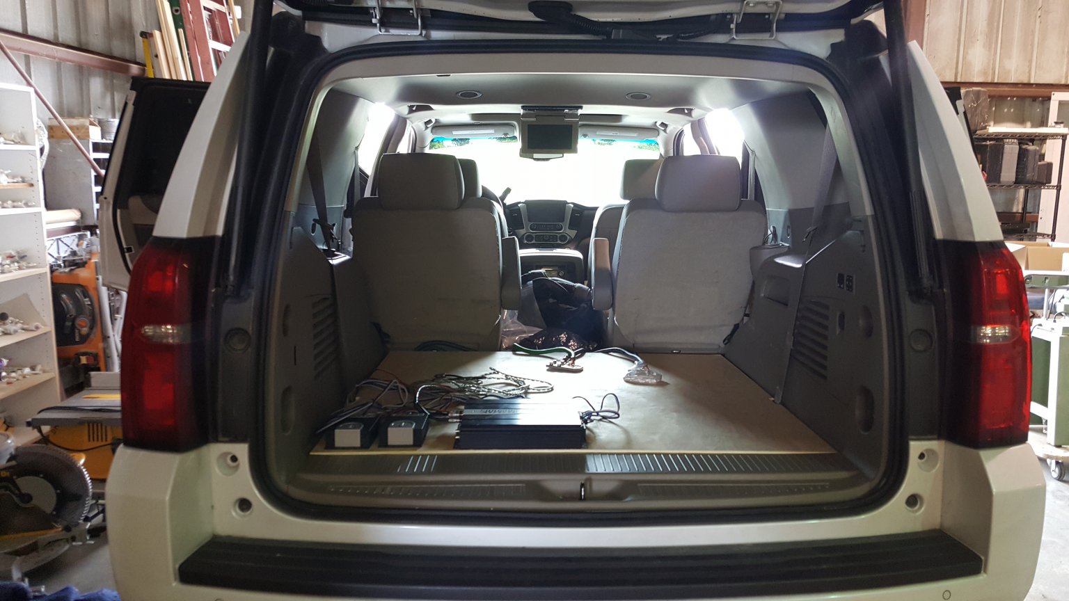

SSV4x4
Mar 10, 2017
Here is what it will look like. My SSV had the 3rd row deleted from the factory.
