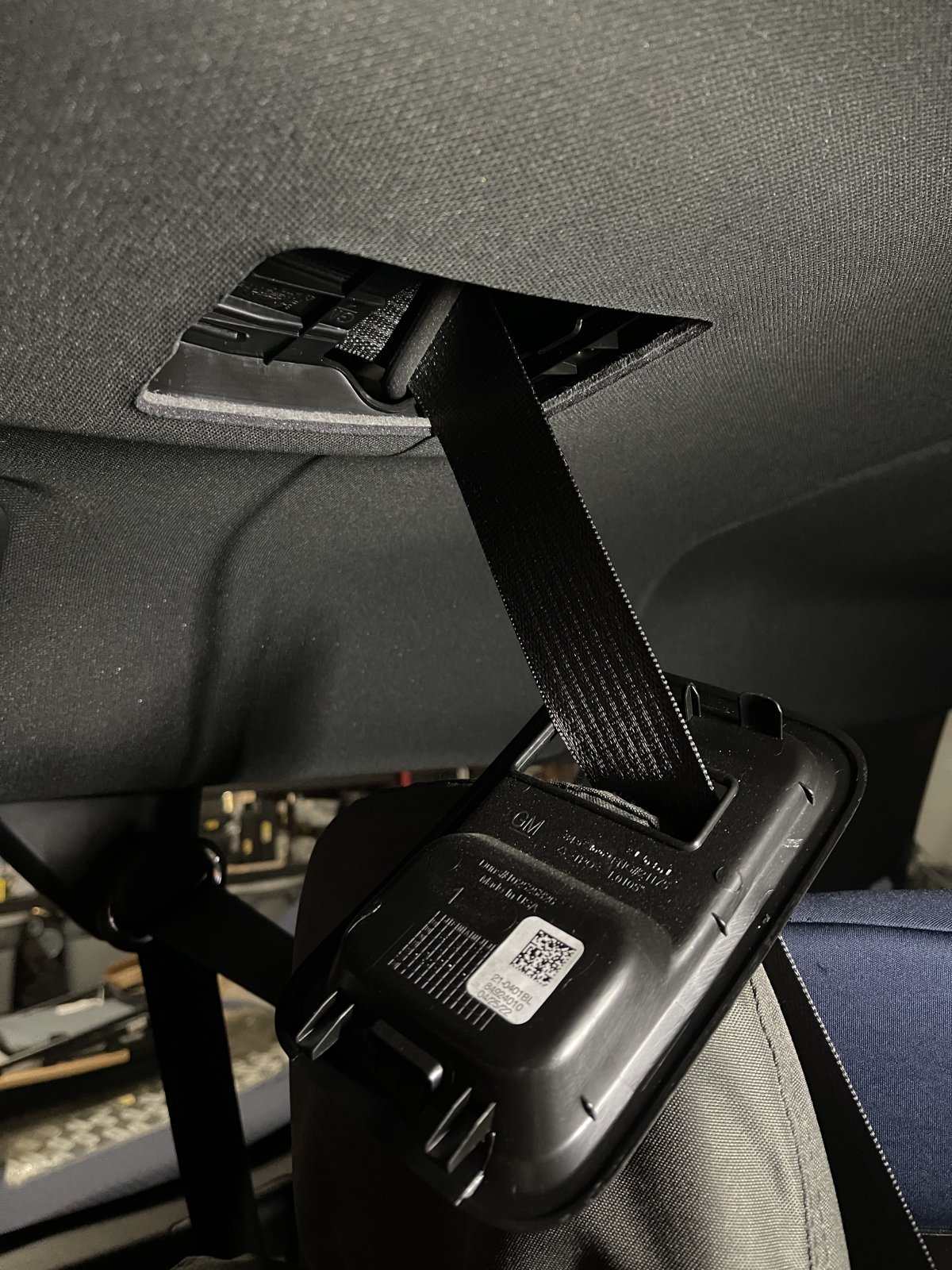

I’ve got a 2023 Yukon XL. One of my kids pushed the 3rd row middle seatbelt into the ceiling and I can’t get it out. I’ve tried pulling off the plastic bracket but I didn’t want to pull too hard and break it.
Anybody know how to pull that plastic piece off?

Reach a finger into the opening where the belt comes out. Pull down at the front edge to release and then pull forward to release hook tabs at the back.

That same trim piece popped off on mine. The tabs on the back hook on but does the front have clips in the roof section?
The front of the trim piece has two vertical snap tabs on it that snap it into another plastic piece which is on the backside of the headliner. Reach in where the belt comes through to hold down that inner plastic piece and push up on the trim and you'll feel the vertical snap tabs engage.
