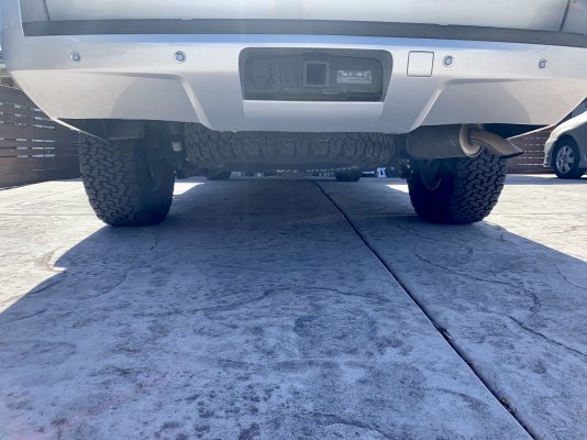

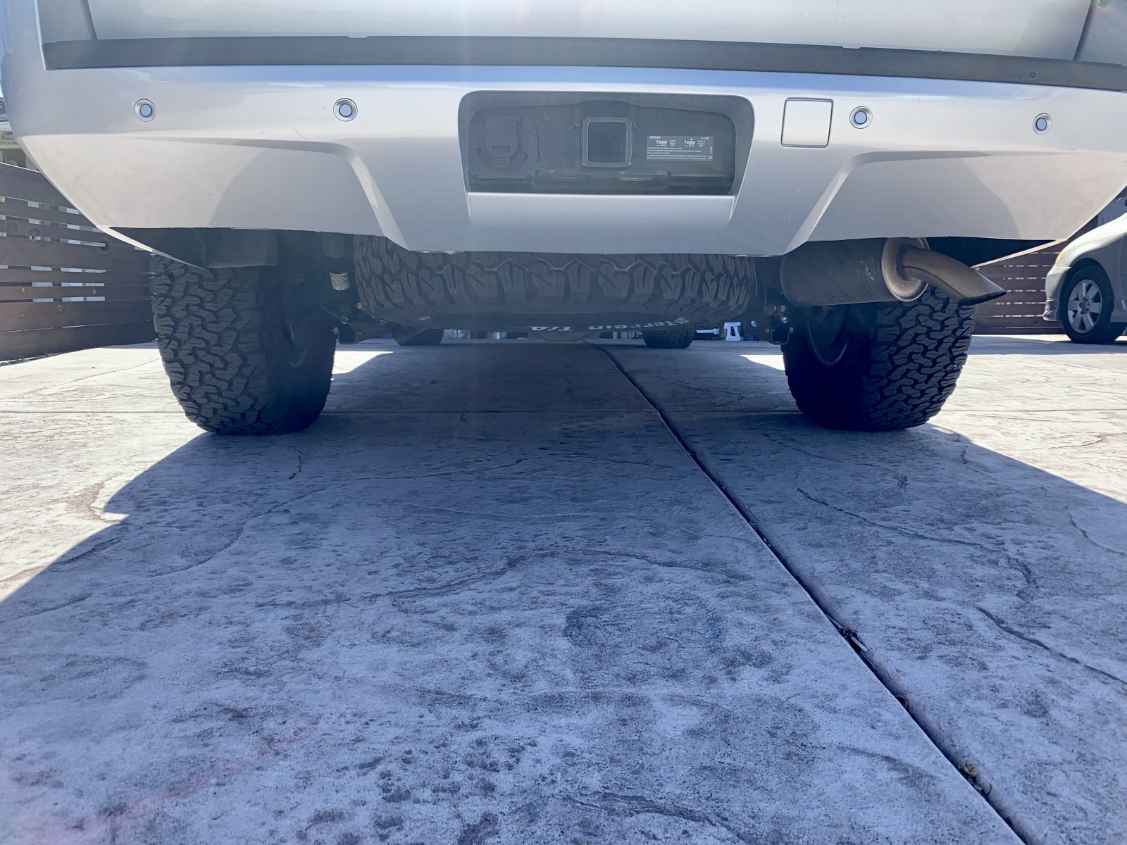

just an update, 35s spare would fit a BFG KO2 on a stock 17s. The spare fit with no issue.

nice! thanks! So you put a 35" in your stock spare location with no problem? Truck looks great by the way.
Yes, if you look closely, that's a 35 KO2 tire under...I don't know with other models but it fits perfectly under a 2012 Yukon XL. No issue and it was easy to put it up there.

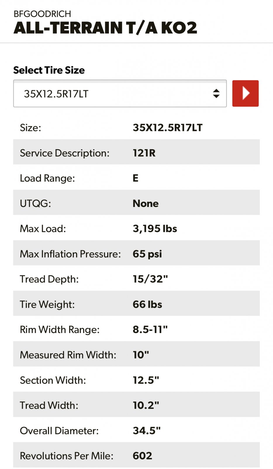

attached are the specs if you're interested, hope that helps.

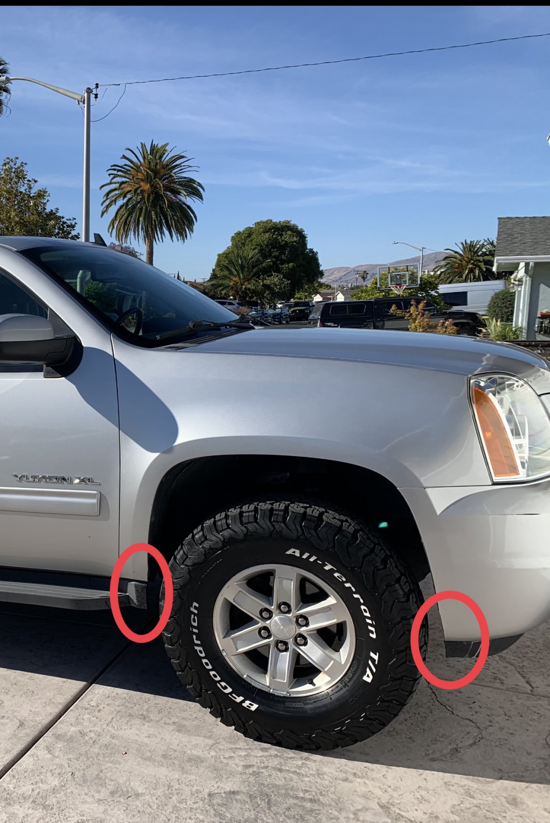

did you do the NorCal mod at the back of the front fender and bumper trim? Did you have to do anything to the rear fender to fit them?

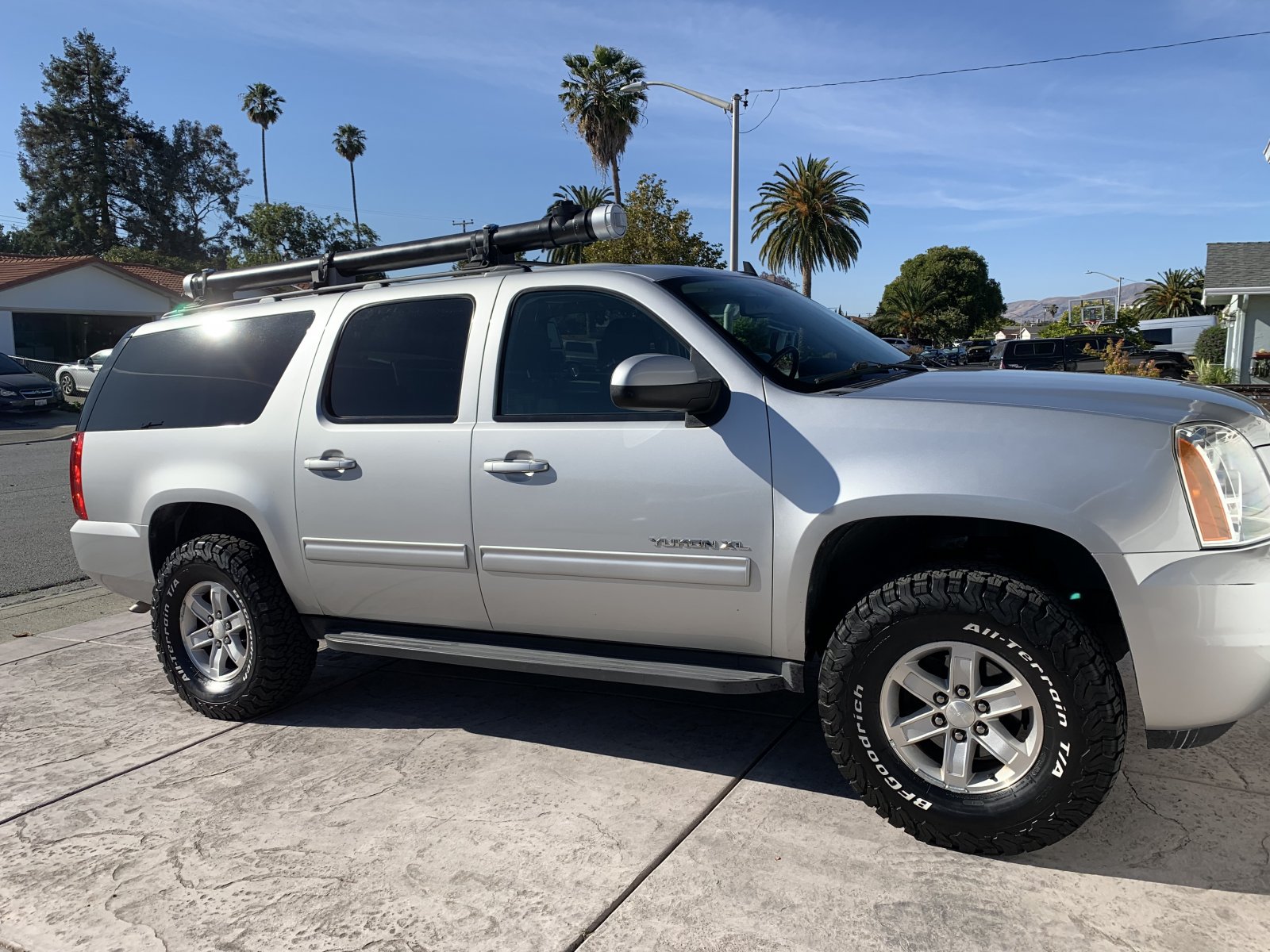

Yes even with a 3" lift, I had to do all the above mention, but just the front. Nothing done at the back wheel. Nothing biggie tho it was just a lot of measuring and testing. You cut as you go, prolly 30mins max of trimming both sides. It's not that obvious looking at the picture since I tried to cut just enough to avoid the rubbing.

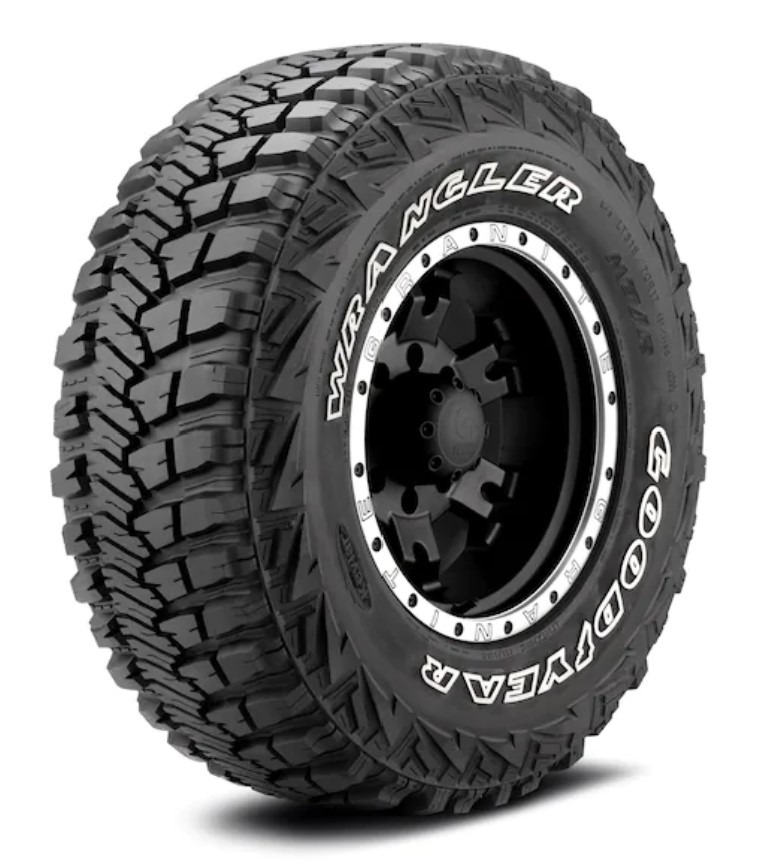

I found this tire: Goodyear Wrangler MT/R with Kevlar LT275/80R17
I'm considering using it as my spare because it would provide a little better ground clearance. It is about 1.5" narrower than a 315/70r17 or a 35x12.50 and comparable diameter.
I wouldn't mind running all of them on that narrower tread honestly, but I prefer an AT tread to a MT. Not many options in that oddball size.
