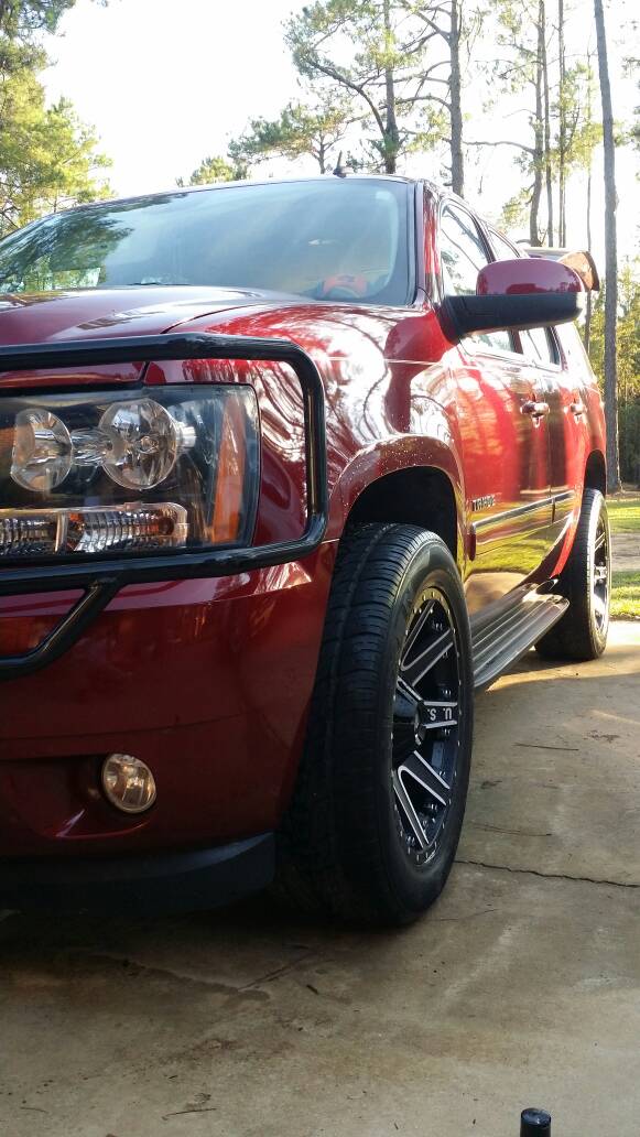

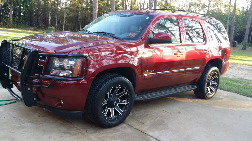

Black rims with the chrome side moulding look a little off. Either black out the chrome or color match it. Or just take the mouldings off altogether and sell them to me bc I'm looking for a set! :)

Oh I'm not finished yet. I'm debating on debadging and color matching the silver on the rims to red. Any thoughts?

I know this is an older thread, but I felt that this would help some in the future. I completely overhauled my tire/wheel combination this past week and here's what I found out.
With an aftermarket 20x9 with an offset of -14, my stock 275/55r20 scrubbed quite often.
I changed my setup to +27 20x9 Snowflake Replicas w/ 33x12.50r20 and haven't scrub at all, even at full turn forward & reverse.
