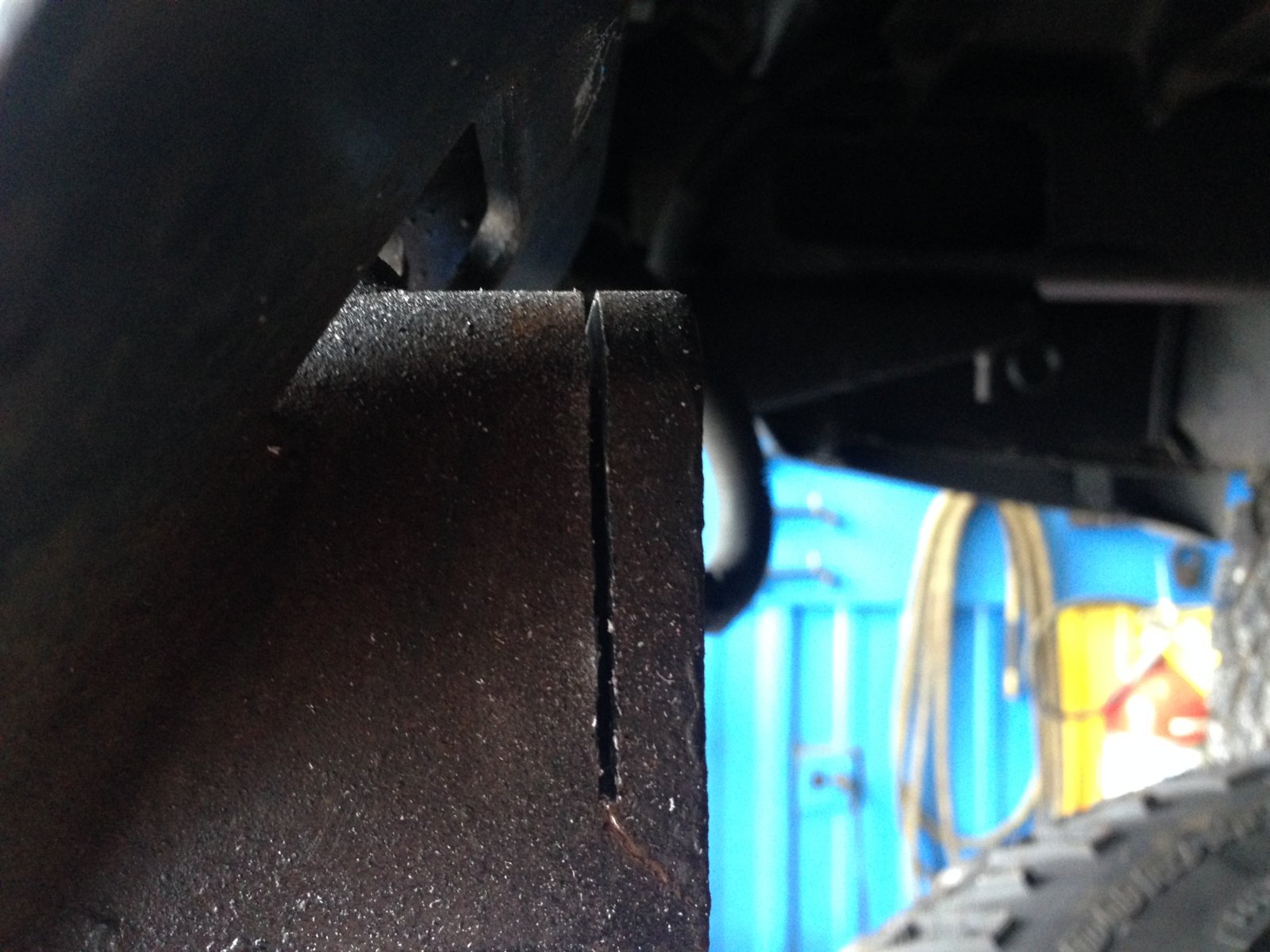

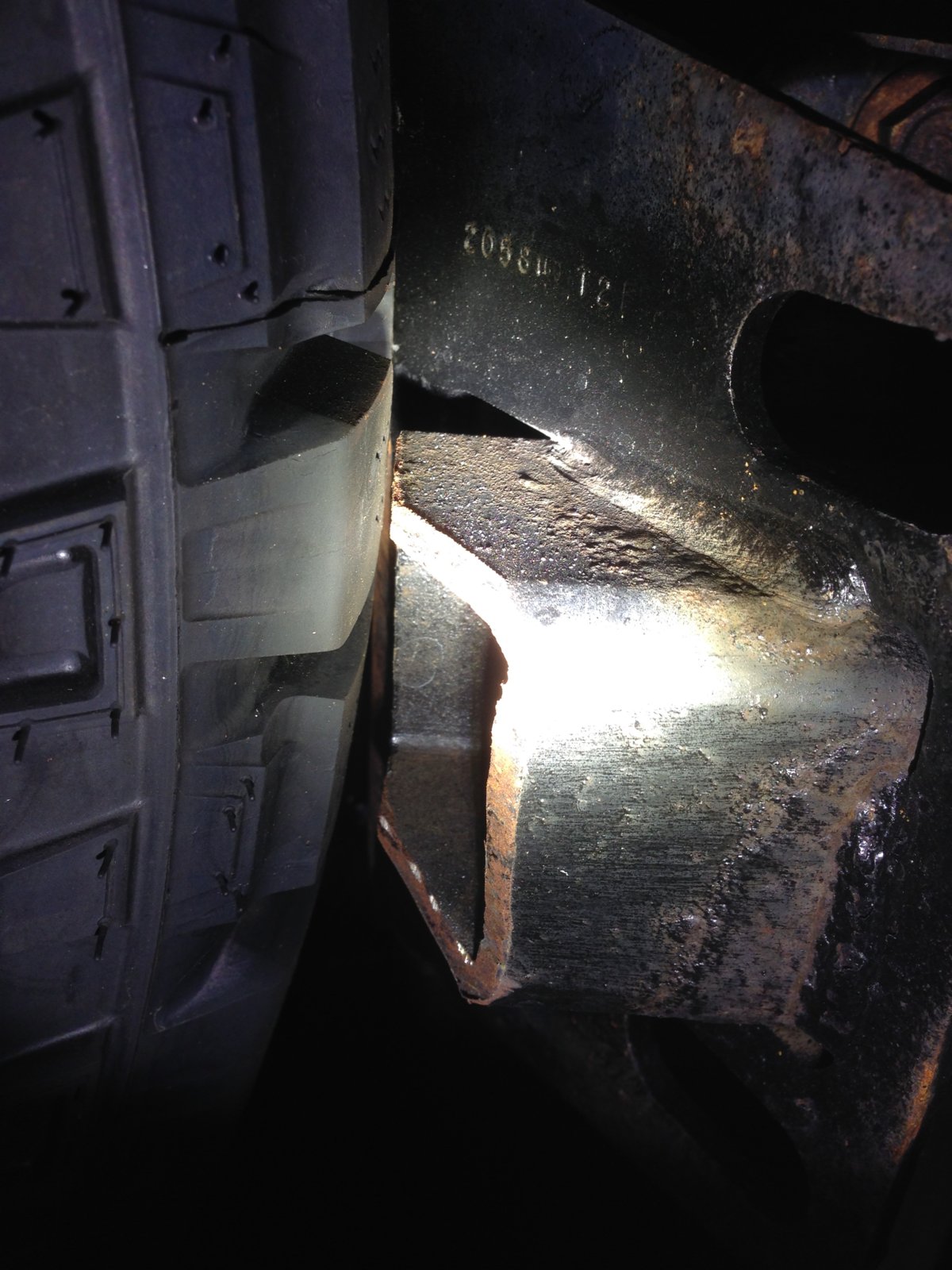

I’m pretty sure that a 33” tire does fit if you trim the back end of the tow hitch bracket.

lol... You wouldn't be touching the frame. The trimming is on the backend of the hitch that sticks out, pokes out toward the tire... and does not impact structural rigidity at all.

lol... You wouldn't be touching the frame. It's a fairly common mod. The trimming is on the backend of the hitch that sticks out, pokes out toward the tire... and does not impact structural rigidity at all.
Here is a thread you might like to read:
View attachment 389454View attachment 389455
Yes a 33 inch 275-60r-20 duratrac with big nobby tires does fit thats my post and pics.you see the amount i had to cut off the rear of the hitch does not affect anything and fits snug as a bug.If you didnt have the big nobbies i bet it would fit better.Its really a tad over 33 inflated to 45 psi.If i remember it was 2 cuts one i had to angle so the tire went up easier.

What did you use to make the cut?
How’s departure angle? Does the tire rub/grind going over obstacles?
Maybe I’ll leave it under there for daily driving and then put inside cabin when off-roading
Does not rub grind over any obstacles-fits just like factory.Sawzall with new blade.departure angle comes straight down and up.Just fits by the smallest of space but again this is a 33 inch duratrac one with 20,000 miles would fit alot easier.Im actually going to take a rear tire and rim off that i had to plug. I am going to put that in the spare and send that one up and buy 1 new tire soon after winter.They have about 15-20000 miles and look new.

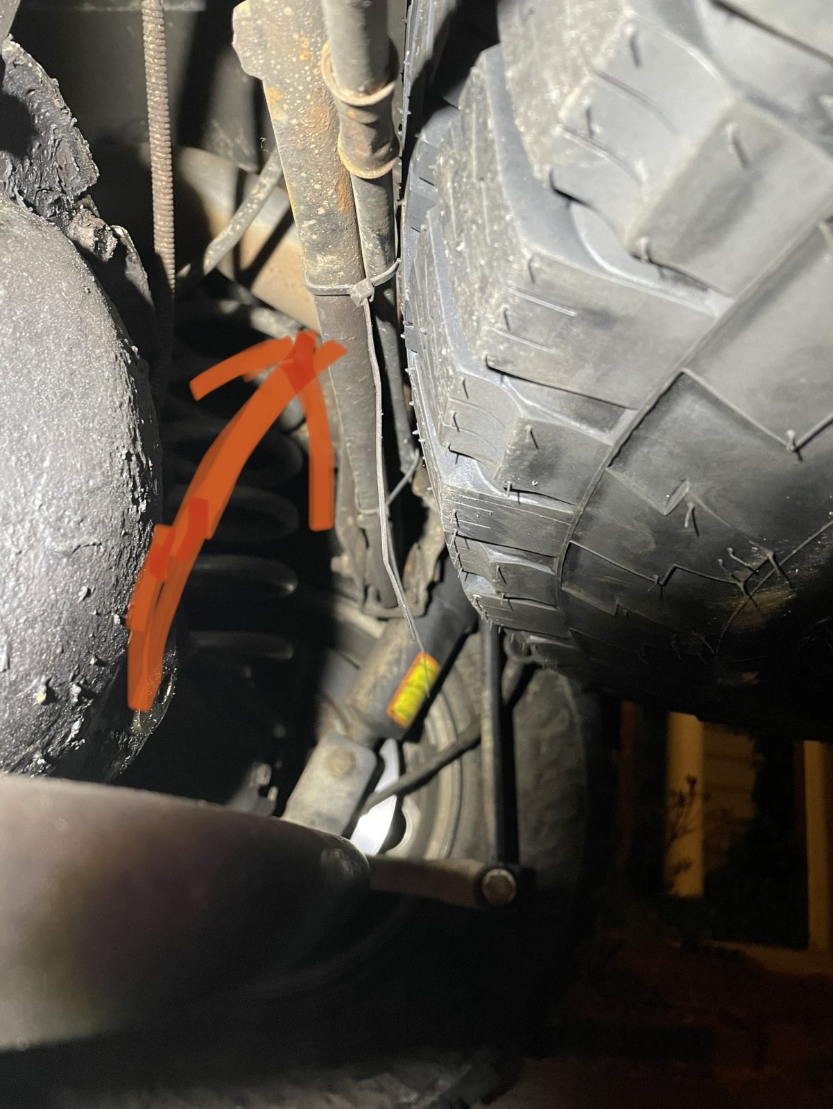

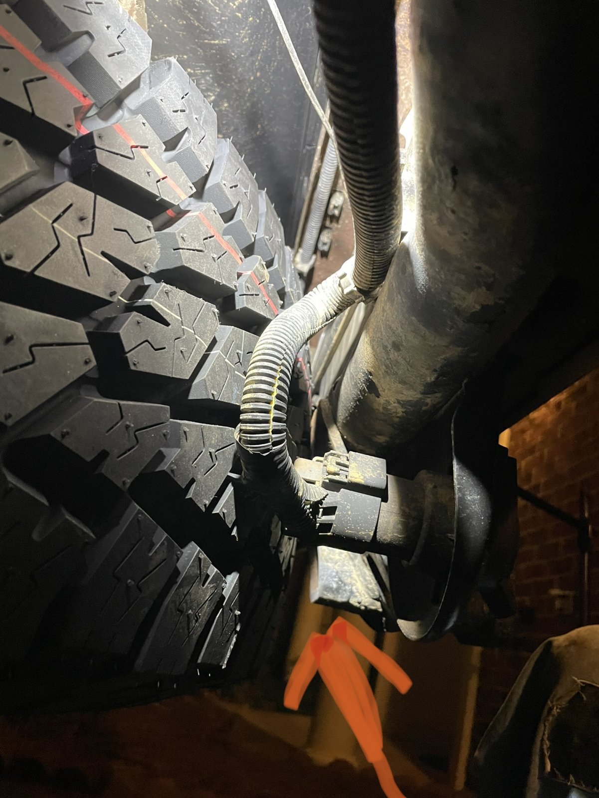

Well that was a fail. I couldn’t wait until Saturday.
The tire diameter didn’t touch the cut hitch and it barely touched the brake line on panhard bar. But the thickness of tire was having problems going much higher into the truck. It was hanging kind of low and I didn’t trust it against brake line and trailer PIN wiring.
I put it back inside truck.
