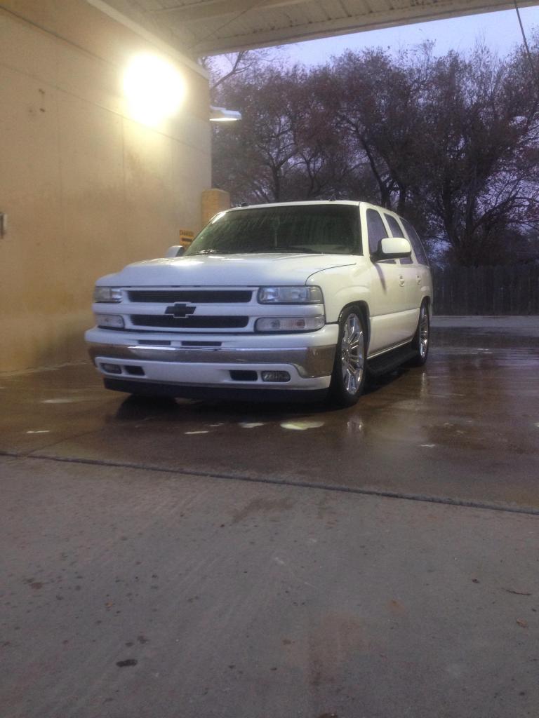

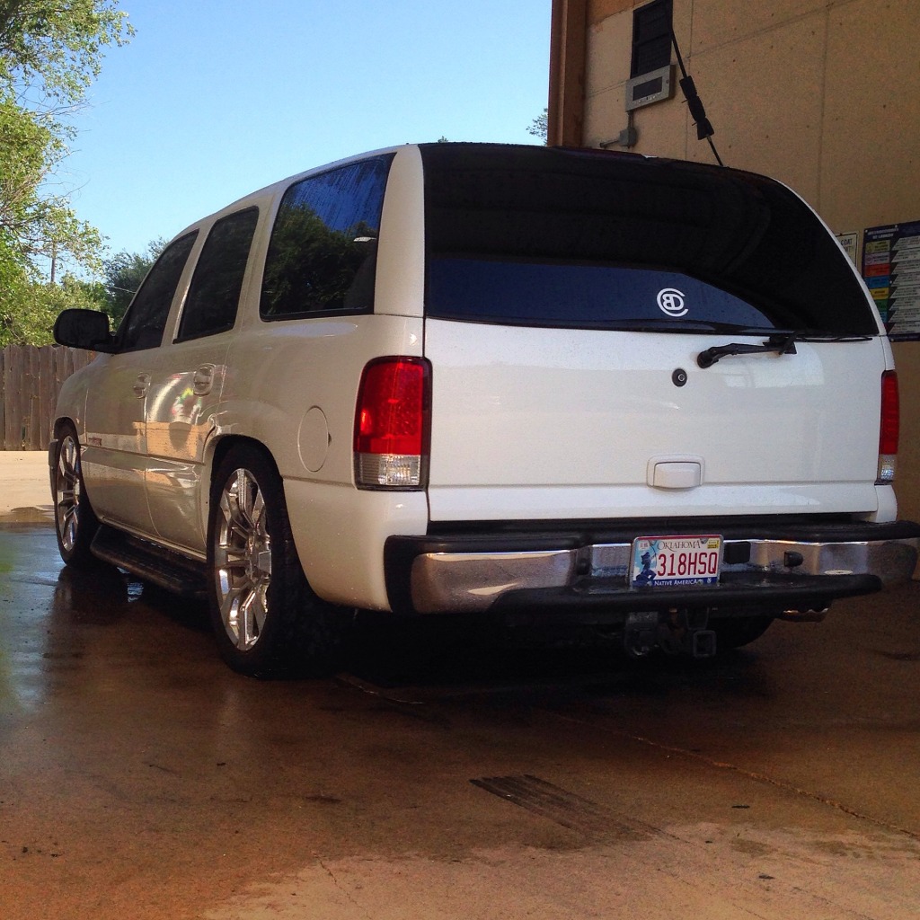

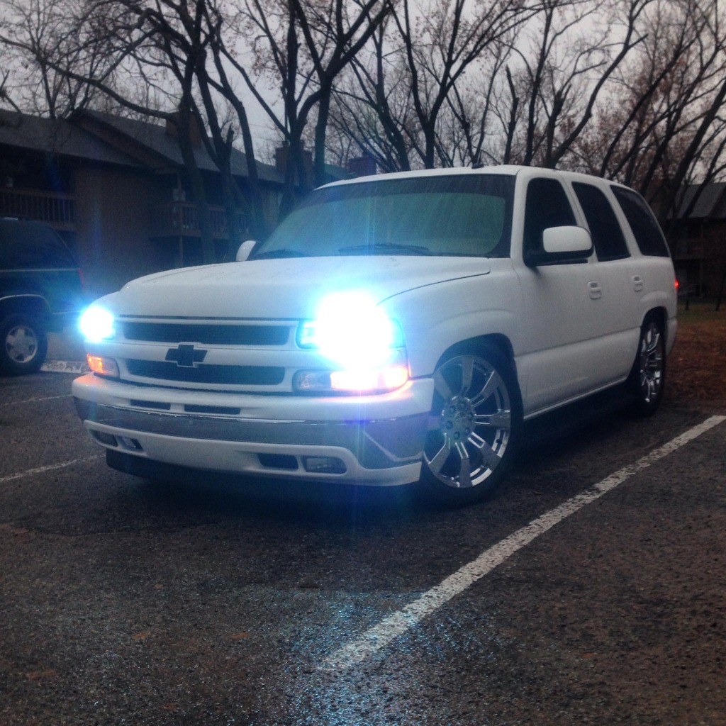

springs stayed in place just like normal, no problems there. My front sat exactly at 31" both sides and my rear only differed about 3/16" and this was all on 285/45/22 tires.

Damn that looks great. Did you put the cut part at the top or bottom? How much did you cut?

I miss that white beauty :okay2:

Beautiful truck man
