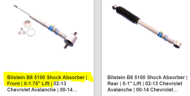

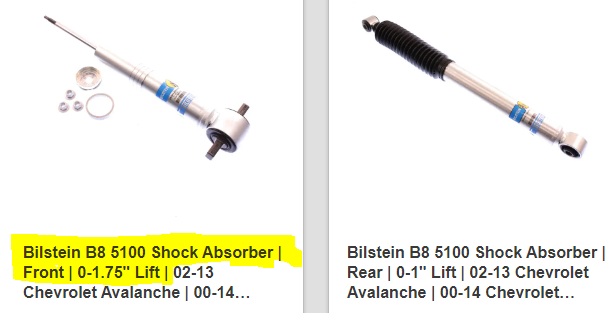

2012 Tahoe LT (4WD) w/ Z-71 which I bought a RC 3.5" lift kit but not sure if these Bilstein shocks will for work for the front end?
Appreciate your comments!

@IamSpartacus4x4 If the kit you bought comes with spacers to achieve lift you will just mount the spacer to the top of the bilstein strut.
Same for the rear, the kit should come with shock extension brackets
