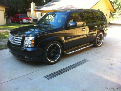

Had 4Wheel Parts install my McGaughey's 3/5 drop on my '02 Escalade yesterday, figuring they were pretty much suspension kit wizards, right?
Wrong.

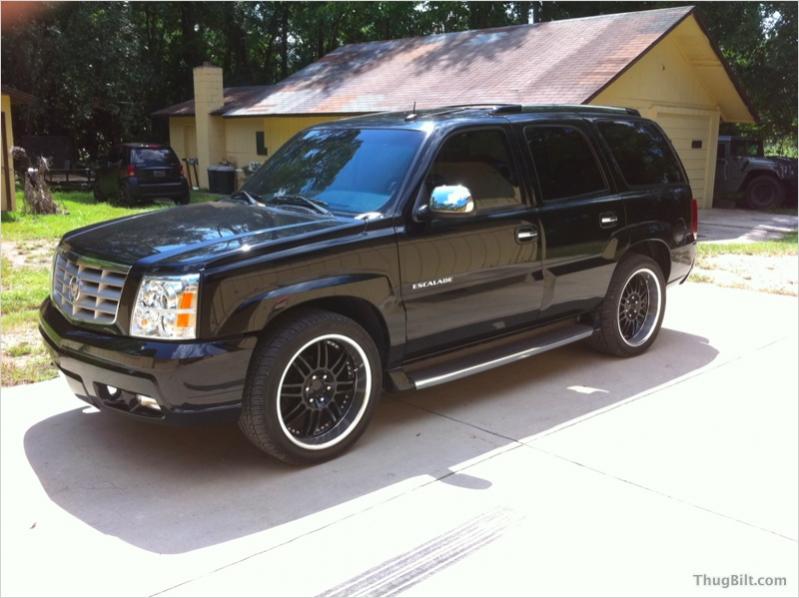

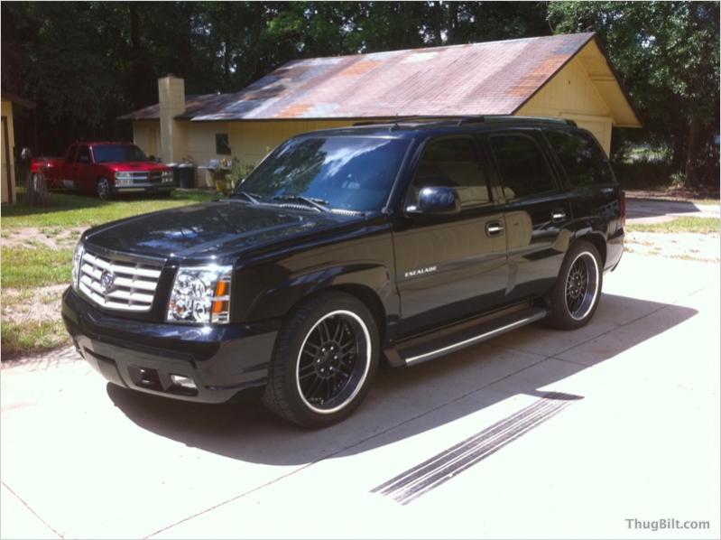

Below are three pics. The first is before.. Second is as picked up post-install, with the rear clearly resting on the bumpstops and the front keys cranked completely up- it's really not much lower than stock.. Third pic is after I chopped out the bumpstop brackets and slacked the keys. I'm cool with the front, but the back still looks to be skying to me.. I'm hoping those new coils will settle a bit now that the bumpstops aren't there, so we'll see..
I'm going to start messing shock extenders to try to reinstall the stock Autoride shocks- Anybody know of a good source for long extenders?

Looks good. Paint the silver piece of your grille black. Should cost $80-150. As for the drop, its probably because of the airride shocks. You can either trick them into not filling up with a little bar you can buy which is what I have or change to something like Bilstein HD shocks.
Also, You should take of the crossbars of the roof rack. I did this to mine and it cleans it up a lot, while lowering the profile. Plus it's free. That will definately help.

One thing I will say is that the 2nd pic you have shows that they lowered the front to match the rear. After the rear settles a bit and you get the air-ride deal fixed you should be closer to level on both front/rear. You have a Texas lean at the moment ...I think that's what they call it :)
