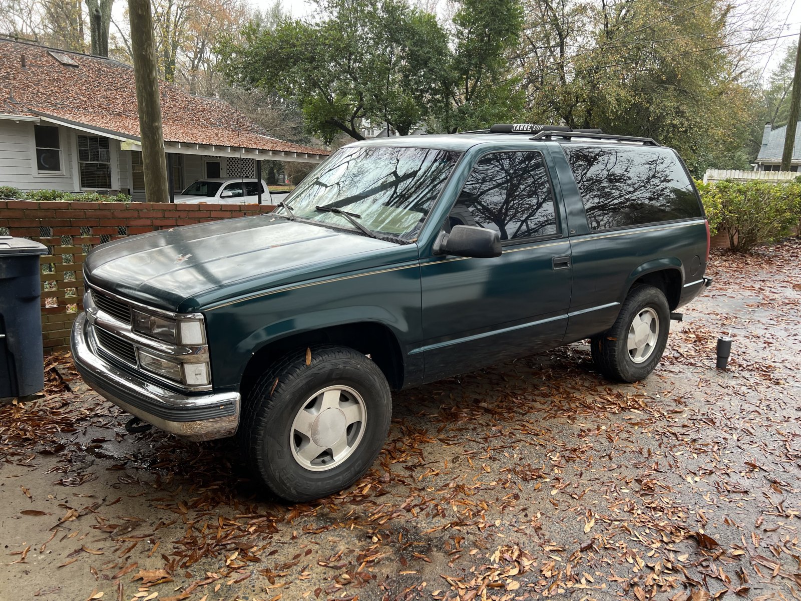

1996 2door Tahoe LS 5.7 vortec, 4l60e the rear does not have the barn doors it has the pop window with the tailgate. I will get the vin this afternoon

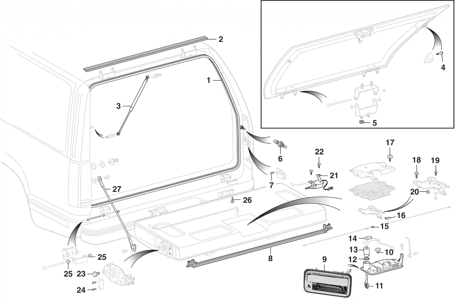

To be clear, you are looking for the single latch where the glass closes at the top of tailgate and not the two latches for each side of the tailgate?

Is it #21 in the picture?

138-8380
WEATHERSTRIP-OPENINGCHEVY GMC 92-991$39.95IN STOCKADD TO CART
238-8382
WEATHERSTRIP-UPPERCHEVY GMC 92-991$29.95IN STOCKADD TO CART
337-0978
LIFTGATE STRUTW/O DEFOG 92-942$24.95IN STOCKADD TO CART
37-0974
LIFTGATE STRUT-LEFT HANDW/DEFOG 92-941$29.95IN STOCKADD TO CART
37-0975
LIFTGATE STRUT-RIGHT HANDW/DEFOG 92-941$29.95IN STOCKADD TO CART
37-0978
LIFTGATE STRUT95-992$24.95IN STOCKADD TO CART
429-0370
BOLTCHEVY GMC 92-99AR$0.25IN STOCKADD TO CART
531-0878
NUT-LIFTGATE HINGECHEVY GMC 92-998$0.40IN STOCKADD TO CART
637-0982DOOR JAMB SWTICHCHEVY GMC 92-991$18.95IN STOCKADD TO CART
731-0511
SCREW-TAILGATE BUMPERCHEVY GMC 92-99AR$0.25IN STOCKADD TO CART
838-8386
TAILGATE WEATHERSTRIPCHEVY GMC 92-991$29.95IN STOCKADD TO CART
937-8002
TAILGATE HANDLE-CHROMECHEVY GMC 92-991$24.95IN STOCKADD TO CART
39-6559
TAILGATE HANDLE-BLACKCHEVY GMC 92-991$19.95IN STOCKADD TO CART
1031-0518
BOLTCHEVY GMC 92-992$5.25IN STOCKADD TO CART
1130-0740
DOOR KEY BLANKCHEVY GMC 92-94AR$2.49IN STOCKADD TO CART
30-0749
DOOR KEY BLANKCHEVY GMC 95-99AR$9.95IN STOCKADD TO CART
1231-2301GASKET-LOCK CYLINDERCHEVY GMC 92-991TEMPORARILY
OUT OF STOCK
NO BACKORDERS
1337-0748
LOCK CYLINDERCHEVY GMC 95-991$59.95IN STOCKADD TO CART
1431-0766
RETAINERCHEVY GMC 92-942$2.95IN STOCKADD TO CART
31-1603RETAINERCHEVY GMC 95-992TEMPORARILY
OUT OF STOCK
NO BACKORDERS
1531-1603RETAINER-LATCH RODCHEVY GMC 92-991TEMPORARILY
OUT OF STOCK
NO BACKORDERS
1630-0738
CLIPCHEVY GMC 92-991$1.45IN STOCKADD TO CART
1729-0361
BOLTCHEVY GMC 92-99AR$0.80IN STOCKADD TO CART
1831-0341
BOLTCHEVY GMC 92-99AR$2.95IN STOCKADD TO CART
1931-0342
BOLTCHEVY GMC 92-99AR$1.95IN STOCKADD TO CART
2031-0876
NUTCHEVY GMC 92-99AR$0.39IN STOCKADD TO CART
2137-0987ACTUATOR-LIFTGATE RELEASECHEVY GMC 92-991$92.95IN STOCKADD TO CART
2231-0203
BOLTCHEVY GMC 92-99AR$0.49IN STOCKADD TO CART
2331-0279
BOLTCHEVY GMC 92-99AR$2.25IN STOCKADD TO CART
2431-0511
2537-1009
BUSHINGCHEVY GMC 92-994$3.25IN STOCKADD TO CART
2650-0422-CBOLT-ROD RETAINERCHEVY GMC 92-99AR$0.65IN STOCKADD TO CART
2737-1006
TAILGATE CABLECHEVY GMC 92-992$9.95

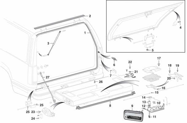

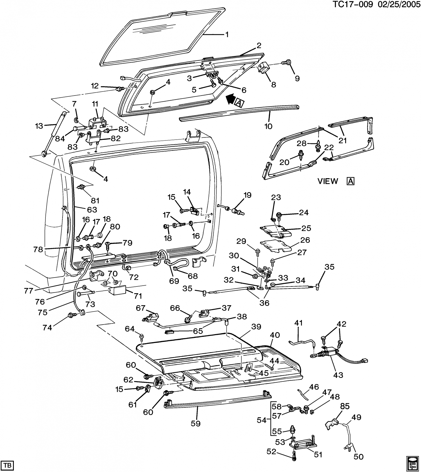

See if this link works, it should be the part diagram with GM part numbers in the far right column. You cannot buy from them, but they have the old GM diagrams.
I’d bet that nearly all of the tailgate components will be interchangeable with a Suburban or four door Tahoe, so a junkyard run may be in order.

Yea I have reached out to some people parting out tahoes on Facebook marketplace. Thanks for the exploded views
