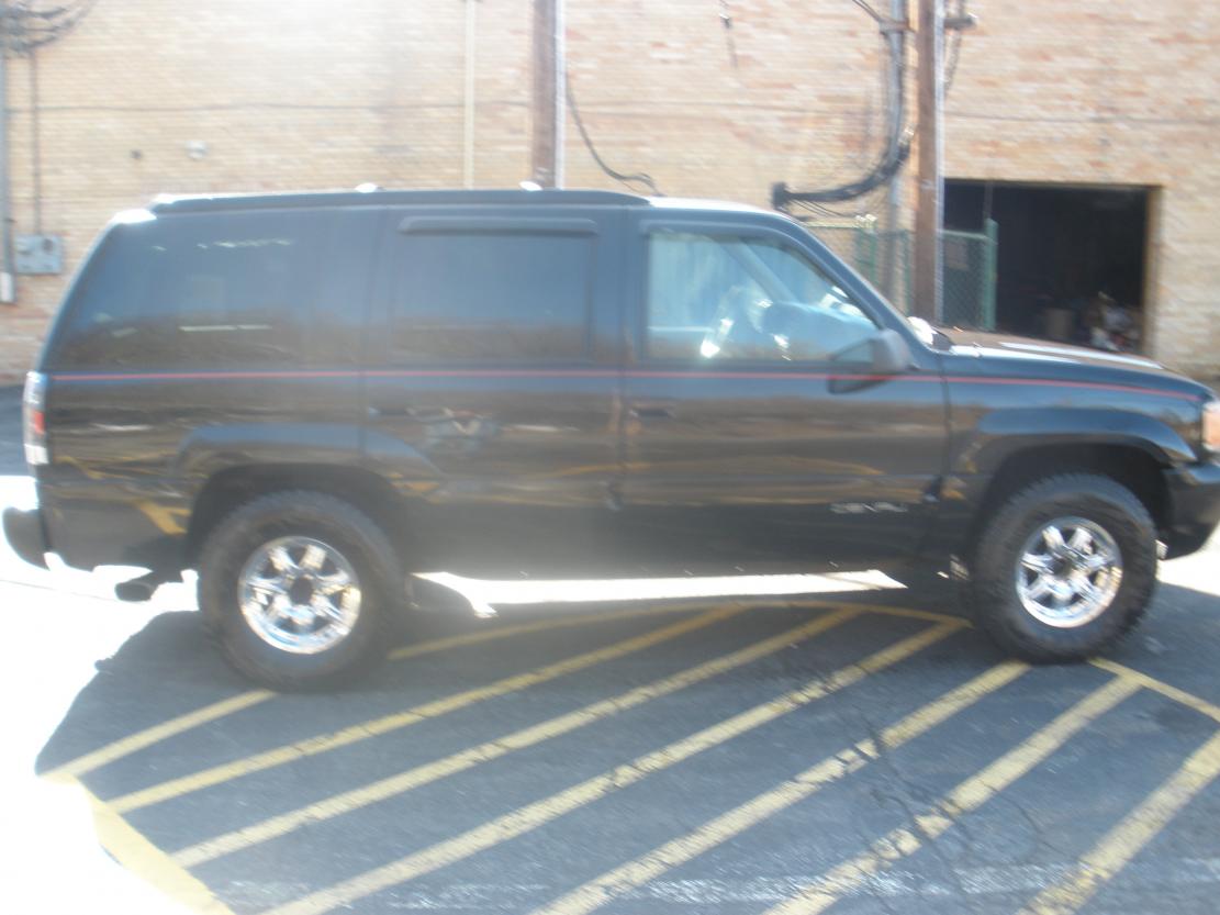

Have any of you put 285's on with no body or suspension lift? I found a real good deal yesterday. I got a set of chrome aftermarket wheels (dont know the make) with 285/75-16 's (90%tread left) mounted up for $450. I finally found a body lift guaranteed to fit a 1999 Yukon Denali thru auto parts warehouse for $200. it has bumper brackets included. I really want to see how these wheels look and dont want to wait till I get the lift and install it. Is anyone personally running this size tire with no lift? The 225's that are on it have been driving me crazy since I got this vehicle 2 weeks ago. Way too small. I am used to running 33's and 35's on my Wranglers.

I do not have any rubbing at all. I ran them all day yesterday without any issues.

I run 285's and have rubbing sometimes. Your denali looks like it's cranked to the max already. Can you confirm? I need to crank mine up a little more since adding my ranch hand made me sag back down to where the tires rub at half lock over bumps. I'll probably opt for 265's when I need to get new tires unless I can talk my woman into letting me add a body lift.

I am not cranked at all. The truck was 100% stock and untouched until I put the wheels on. Not even sure what make the wheels are but they have the same offset as the stock ones. My wife has been running the crap out of the truck since her car is still in winter storage. She has not experienced any rubbing at all. I am not going to crank until I see how it looks after I get the body lift on it. She is mad that I took the boards off and putting the BL before her car comes back out but it's my toy.I have a pretty big grade difference going into the driveway and I have not had any issues no matter what angle I pull in at.
