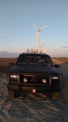

I run 35 around town, and 50 on the highway...
The first time I took it on the highway at 35psi it felt like i was going to roll the truck with the tire being so soft around turns at highway speed... buy an infrared thermometer and see what the temps are at the different psi's. Espically now since warmer weather is upon us. good luck! btw unless you are towing your 7,000lb rating I would never put it to full 80psi. I really wish they made P rated tires in high floatation :(
