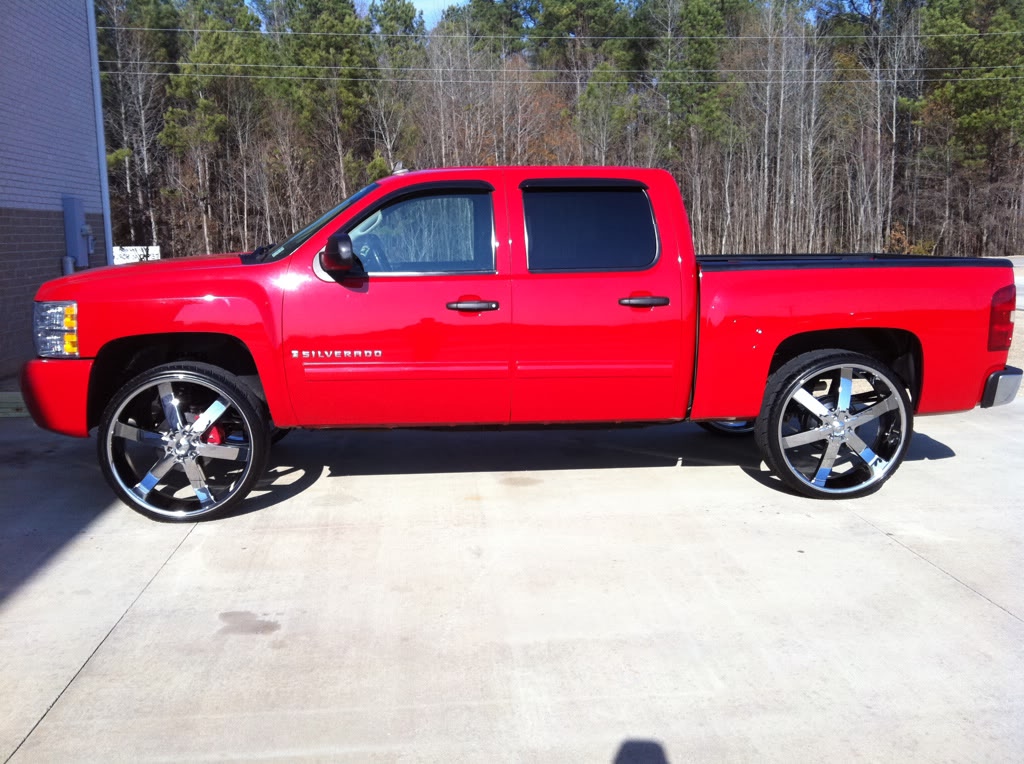

What's the biggest set of wheels u have had again? Anyways to the op, i wouldnt go any smaller than a 295/25. Done a couple of sets on 275/25s on avys and tahoes and even at 50 psi the tires still look flat. here ya go.
30s 315/30/30 3" spindle an keys
28's 295/25/28 2" rc level minimal trimming
It's a nnbs silvy though

If you cant tuck them then dont put them on....im glad you dont have that set up anymore.
