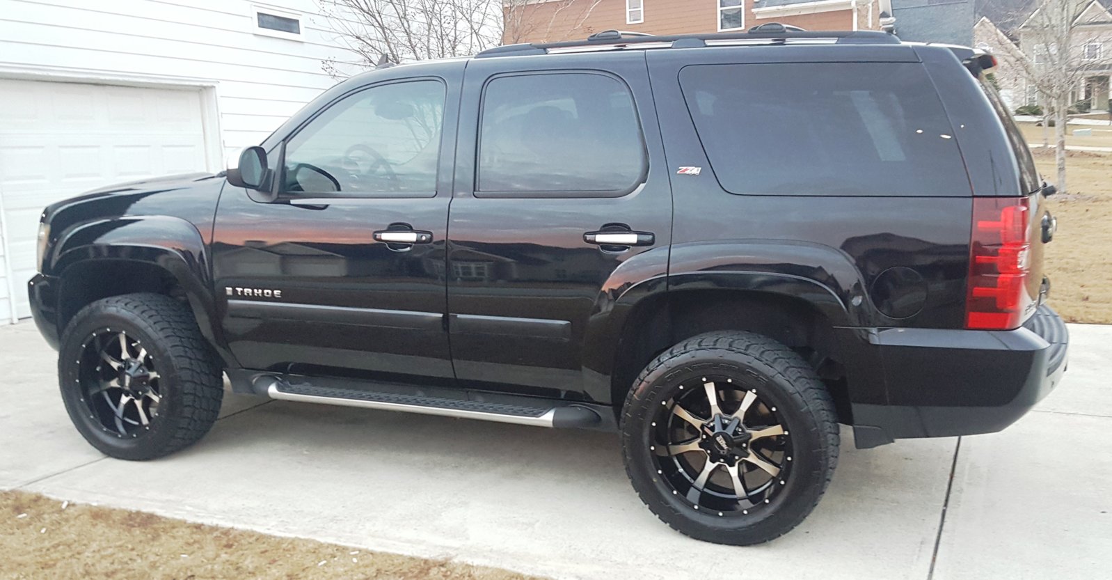

I don't think they will rub at all. But it will depend on your offset. I had to trim my wheel well for my 305/50/20. I went with 2.5 in the front and 1 in the back. I think im like -12 on the offset. Think i'm going to go up to a 305/55 or 295/60 tire next time.

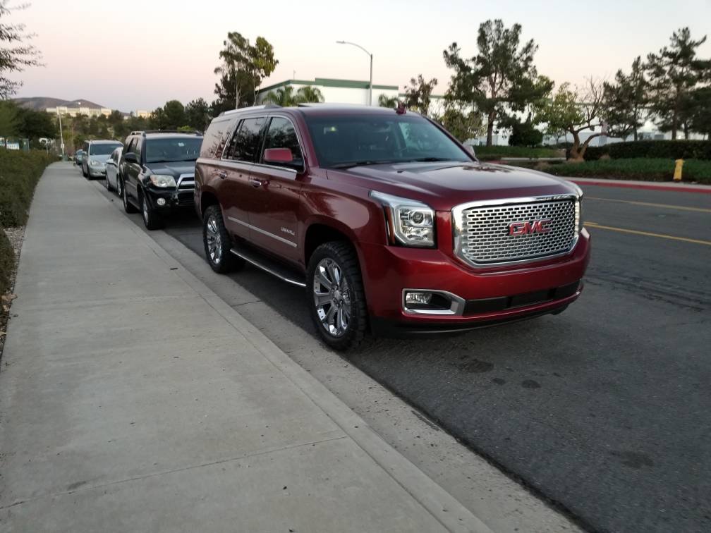

Just put 33x12.5x22 Ridge Grapplers on mine, no rubbing with 1.5" leveling kit.

That’s the exact tire and look I’m going for. What brand of leveling kit did you use?
Also, how is the ride?

I used the Suspension Maxx kit.
No issues with the ride!
